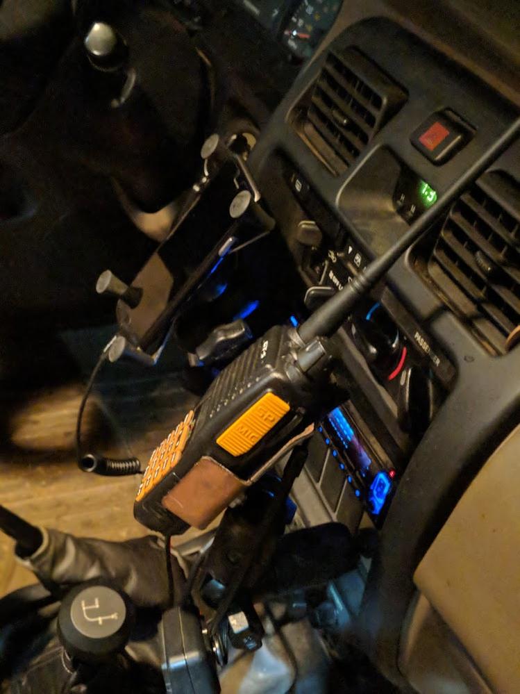

I’ll be in Bishop this Wednesday 8/1 around lunch time. I have a handheld Baofeng with a battery eliminator if you want a loaner. Fishing 8/1-8/5 in Bishop/ Little Lakes Valley/ Rock Creek Lake/ Crowley/ Mammoth during the trip out there. I even have a “builder bracket” you can use on your oh shit handle Ram Mount made by a guy from Expo Portal. I have it set up to use a 1” size B Ram ball. Let me know and I can bring it with me.
