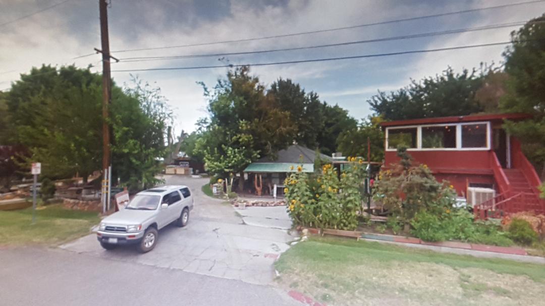

I was thinking that was the funky looking 2 story place that's in a semi residential area so I looked it up a low and behold what's in the driveway....
