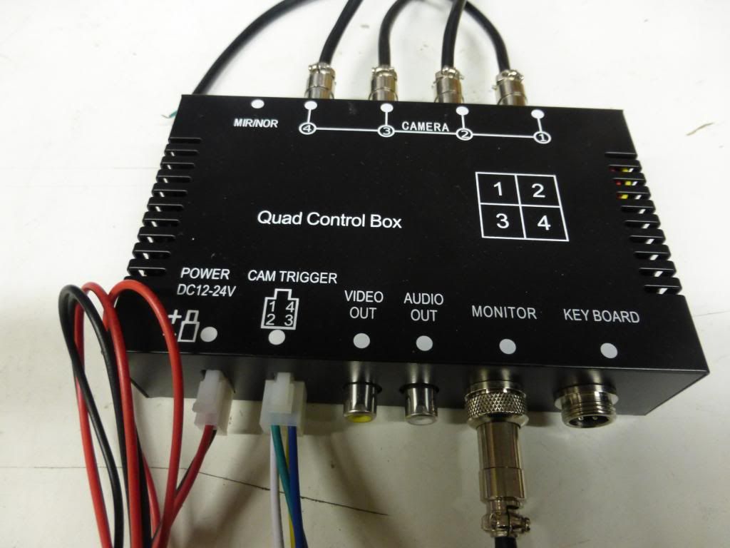

A few guys here went with off the shelve systems but for some unknown reason I need to be difficult. Finding exactly what I wanted turned out to be a real PIA. Online we found this 4 Channel Camera Control Box from the EBay of China which was selling for $ 185.

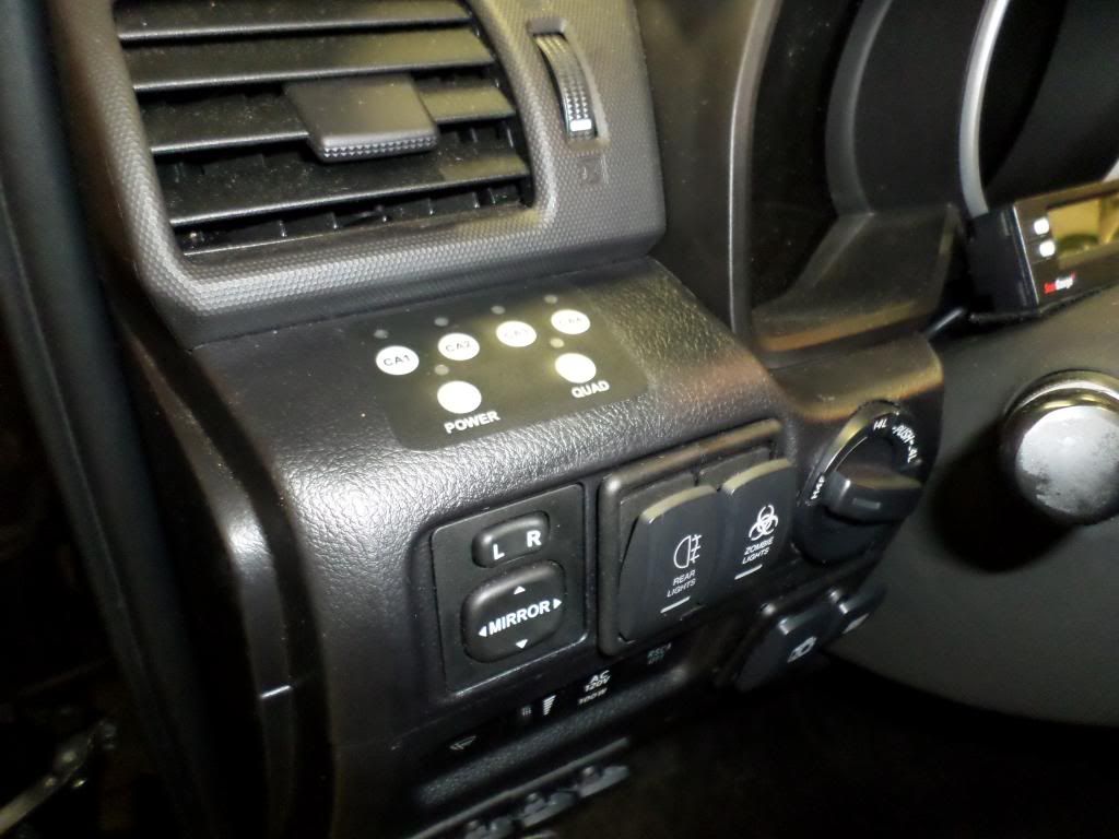

Once all was here I dropped everything off with John as SAS Customs to do what he does best. ‘Oh yeah John, it all needs to work with the OEM Radio / Nav System – Good Luck & Best wishes!” I’ve seen John put Xbox systems into cars so I was filled with perverse pride when he said my truck was one of his most challenging jobs.

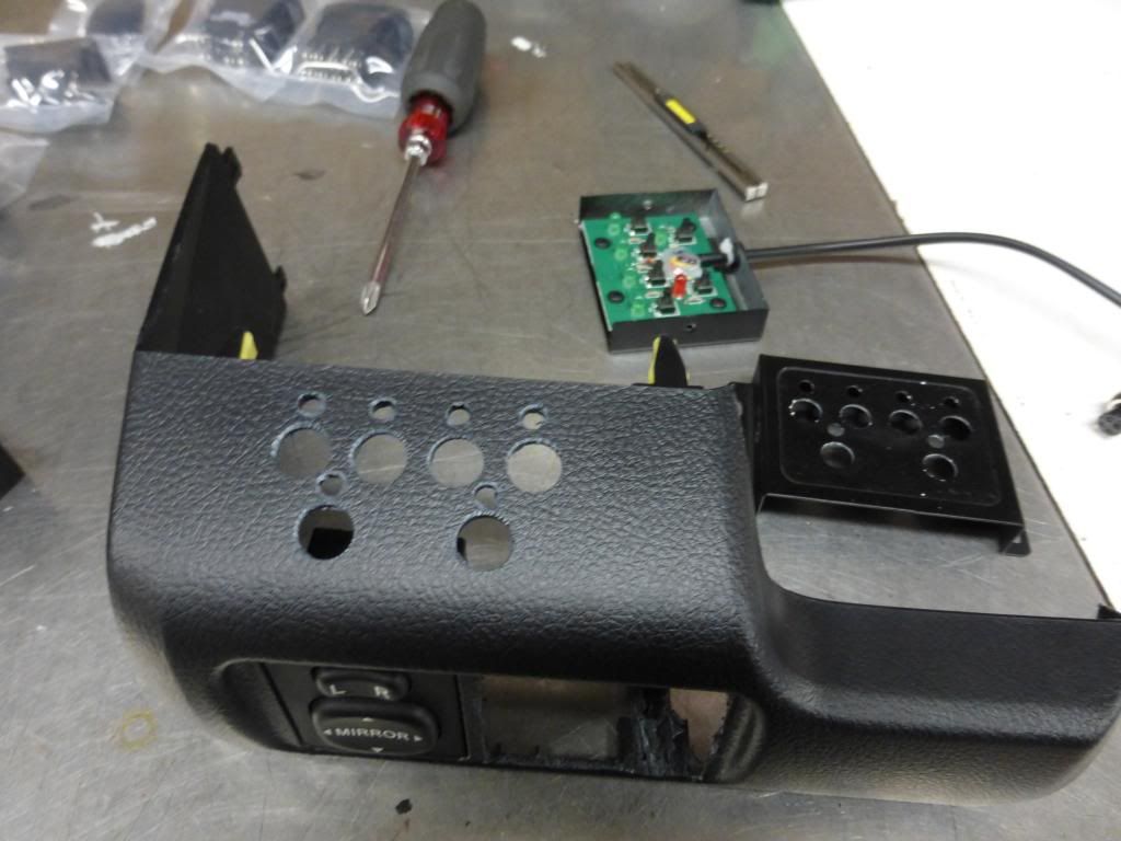

The Camera Control Box was installed in the center console next to the CB and its Switch Box was taken apart and frenched into the truck.
