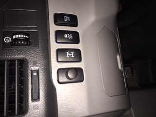

Also, 2008 & 2009 come with a traction control off button
