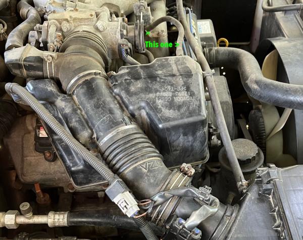

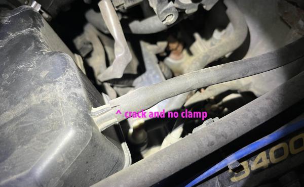

I am getting ready to put new plugs into my 2002 SR5 and during my preps, I saw a problem with this hose. Not only does it have a crack/tear in it at the mounting point, but is also does not have a clamp. Here's a close up of the hose:
Here is the location in the engine bay from the passenger side:

Thats about the easiest one to replace. Yes, it just slips on. I don't believe that hose has a clamp.
Bring the hose to the local auto parts place and ask for the same. Sells by the foot. Remember the ID (inside diameter) is the most important in this case. You need vacuum hose, but I imagine fuel hose will work.
In the interim before buying another hose, you can likely take a snips (even scissors) to remove the cracked portion and replace.

I'd pull the hose off the air box, cut it just past the split with a utility knife and put it back on. There should be enough slack for that 1/2" of loss
That hose is connected to Fuel pressure regulator and it is open to 1 atmospheric air pressure, so there is no need for a hose clamp.
OK, this morning I removed the hose and decided to measure the "ports" it was connected to with my calipers to help determine the ID and buy a replacement. I could trim the existing hose, but for a couple of bucks and the ease of the job, I figured I should just swap it out.
The end that attaches to the airbox is 0.360" while the side that attaches to the engine is 0.280" I measured twice just to make sure and was within a couple of thou each time.
Would a 9/32" stretch to fit the larger end? Sorry, I am not sure how elastic these things are!

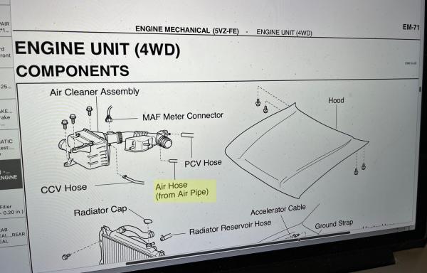

RE-EDIT: I think this thread answers the question: Anyone know part # for this hose?
Toyota Part #: 17343-62110
Here is the shot from the Toyota service manual, page EM-71 in my version.
