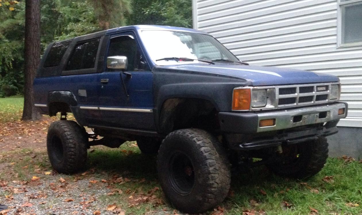

Here's the up to date pic:
Someone has done some shabby rust repair on the rear wheel wells. Also the front fenders are shot. The truck had the chrome fender trim and I believe that's pretty much the culprit of the rust. A couple little rust holes are pretty much the extent of the rust. The frame seems pretty solid. Here in Eastern Va. we don't see much snow so trucks last a little longer here, just the occasional hurricane flooding our streets with salt water is about the harshest season we have. Here's what I've done to the truck up to date.

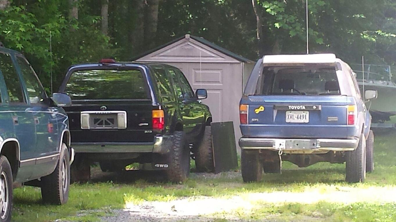

4Runners crowding up the driveway. I ended up selling the black one to my good friend and he's getting the parts together to get her up and running. I can't wait til we can take them both wheeling

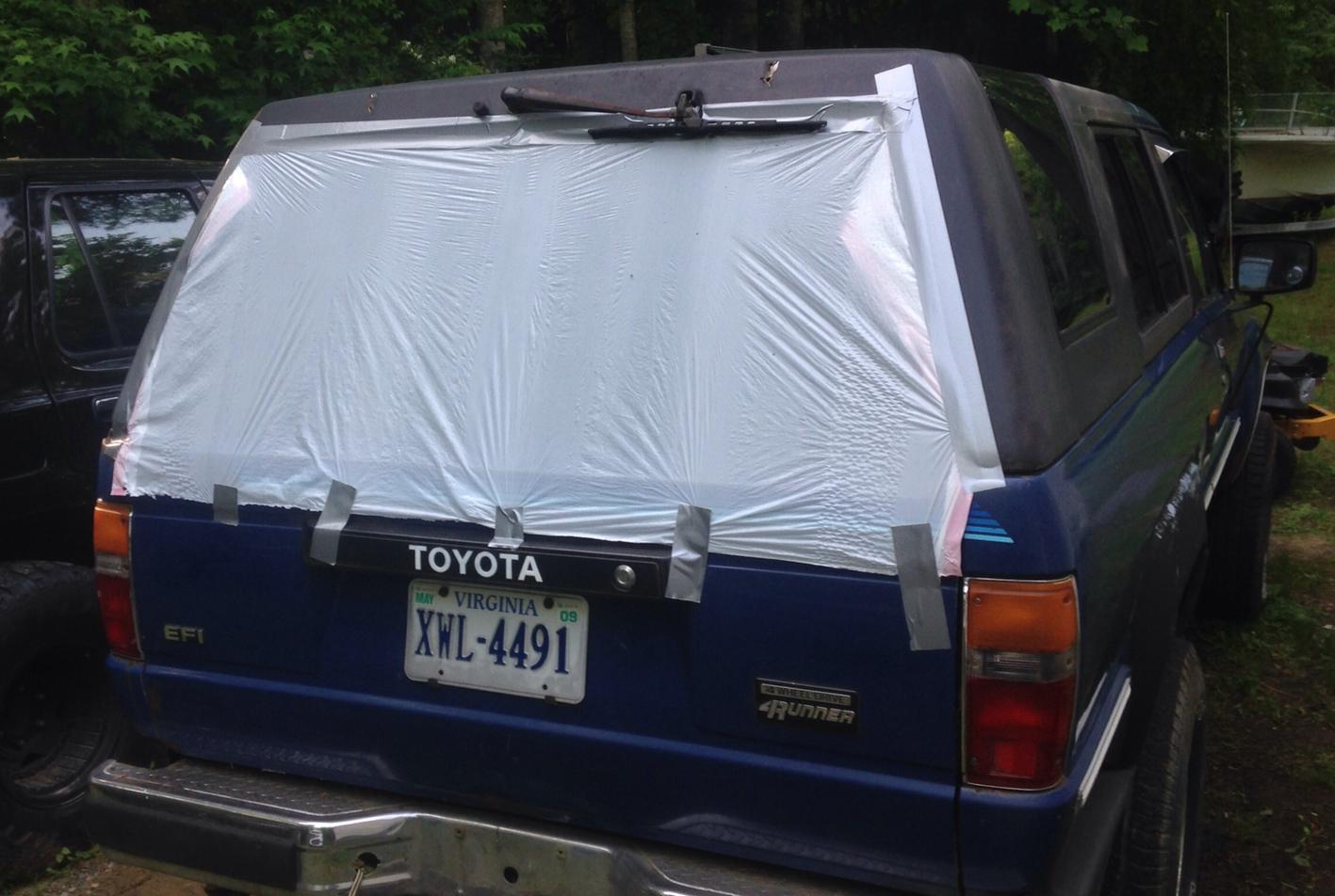

Custom back window!! Filled my 2.5 gallon shop vac twice to get all the glass out of the tailgate. I'm assuming it was down when it got broke. I'm on the hunt for one if anyone can help me out. Would love to find a toyota graveyard around eastern Va. image.jpg

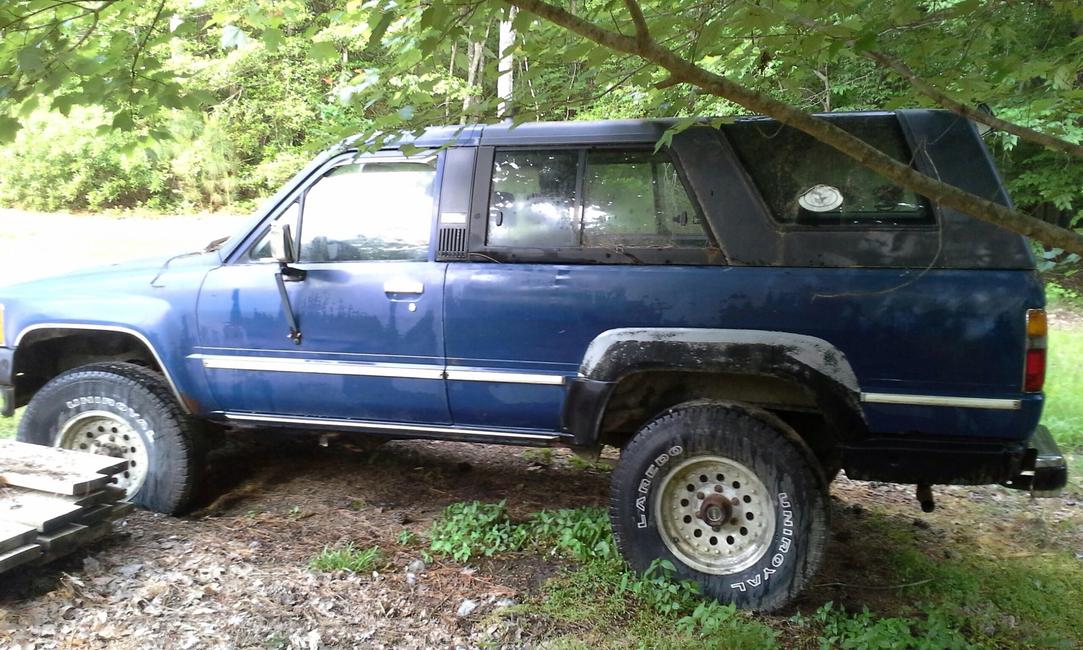

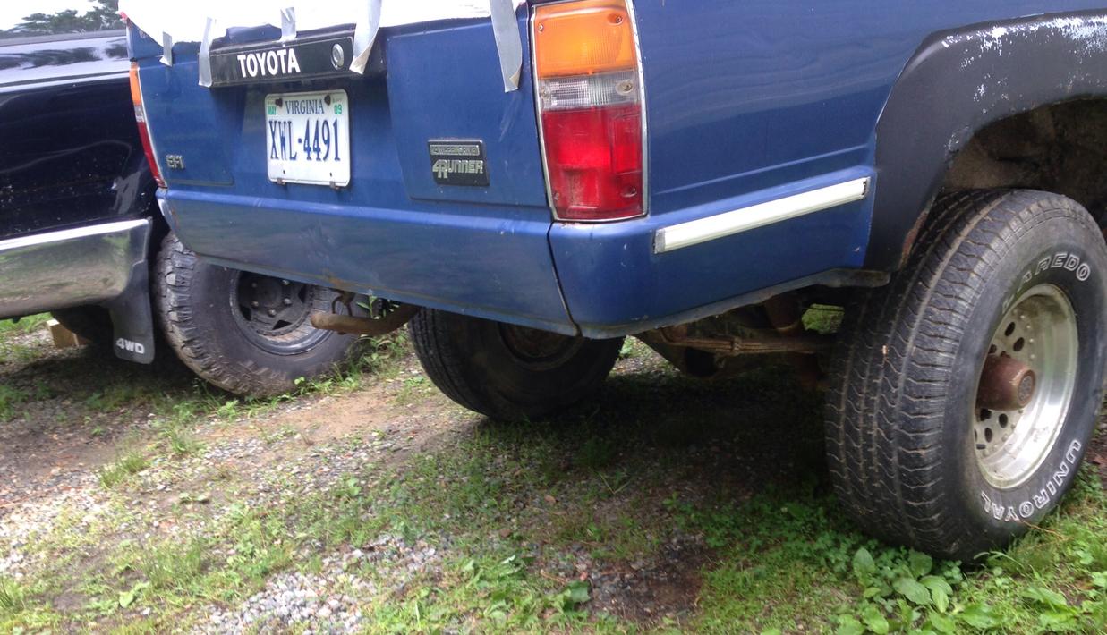

Got that hideous bumper off and plasma whacked the brackets off. Thinking of building my own back bumper, something simple maybe some 2x3 box mitered on the sides to wrap around to the rear tires?? Any suggestions would be appreciated.
Im in the same boat, trying to decide which style of bumper to build. I had the 2x3 box tube before when I had a body lift
Good part about it is the frame ID is the same size so it was hammered into to strengthen the frame ends.
Bad part is with out a body lift some brackets will have to be fabbed up.

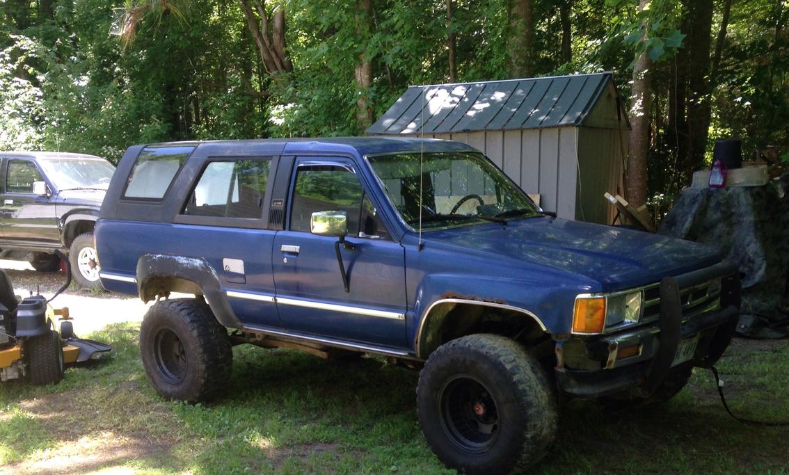

Swapped my wheels out today as I believe she'll be on the road before my '95. Anyone know if those push bars were a factory thing? It has a toyota emblem on it that looks factory, it contours with the bar perfect. I'm planning on ditching it but thought maybe someone would want it if it was an option. image.jpg

Would love to find a toyota graveyard around eastern Va. View attachment 120710
I'm going to pass this place in about two hours coming home from the beach. They are a 1st gen junkyard but they're really a glass shop. They have a ton they are parting out. They are on 460 between Ivor and Zuni but very close to Suffolk. BYO tools.

Nice. That's a couple of hours from me but well worth the trip. Thanks a lot man.
Hey. Be sure to call first. I stopped there about three years ago looking for seats. I found them later through a private seller. The place has no business sign. The guy working gave me a business card that said "Red's Auto Glass." I asked why it said it was a glass shop when it seems to be a used parts place (junkyard). I realized tonight that Suffolk is about 15 miles from the yard I went to. It's actually in Southampton County between Ivor and Zuni on 460. They possibly have two locations and one is for glass. There were about 6 1st gen 4Runners and some early pickups out front tonight. When I stopped there were many more behind their fence.
Nevermind I went out on a limb and made the trip out and I'm glad I did. Scored 2 rust free front fenders and a back glass for $90. Might not sound like a deal to some but I'm tickled pink with the trouble I've had finding stuff. I'll definitely go back. Thanks Nervo for the tip.

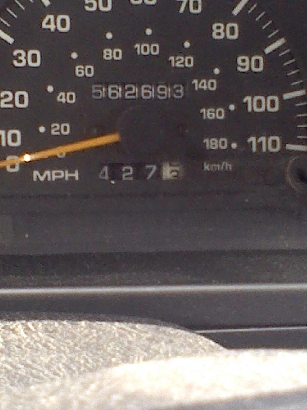

Snapped a pic of a buddy's 3rd gen today. Living proof that if you maintenance these truck you'll get your money's worth. He's on his 4th timing belt(none have broken, just routine changes). Don't see that everyday.

i feel like a post ***** tonight its not that i don't believe that truck has ~560k miles im just surprised that that odometer is still keeping track of them....
