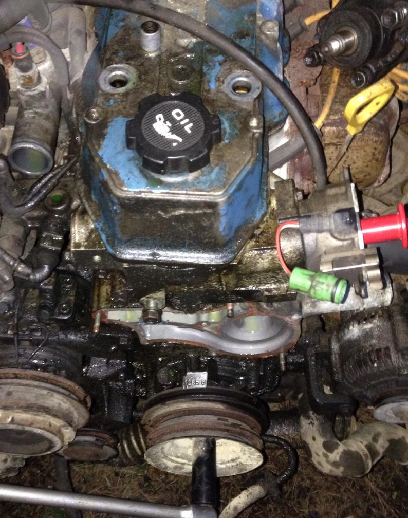

Made a little progress tonight. Should have it all apart tomorrow. Gotta tell ya, the breaker bar on the frame rail trick worked wonders on the crankshaft bolt.

I removed and installed my timing cover without removing the head, but I did remove the oil pan, only to make it easier. Be very careful and you won't destroy the head gasket.
And the crankshaft pulley bolt, yea. I stuck a huge screwdriver through the pulley, wedged against the oil pump and literally jumped on a 2ft breaker bar. Those suckers are on there lol.
Yea I tried to jam up the pulley but even being a pretty big boy I couldn't budge it. The only reason I didn't do the starter trick first was my battery was dead so I felt doing it manually would be faster. So a set of jumper cables and one strike of the key later boom bolts loose. Couldn't believe it popped that easy.
Pull the pan. Even if your current guides are intact, the last set might not have been and that guy might not have pulled the pan either. It takes an extra 20 minutes, and it'll give you a chance to make sure there's nothing funky in the pickup and you can eyeball your bearings and crank while you're down there.
I haven't gotten a crank bolt free without doing the starter trick yet.
