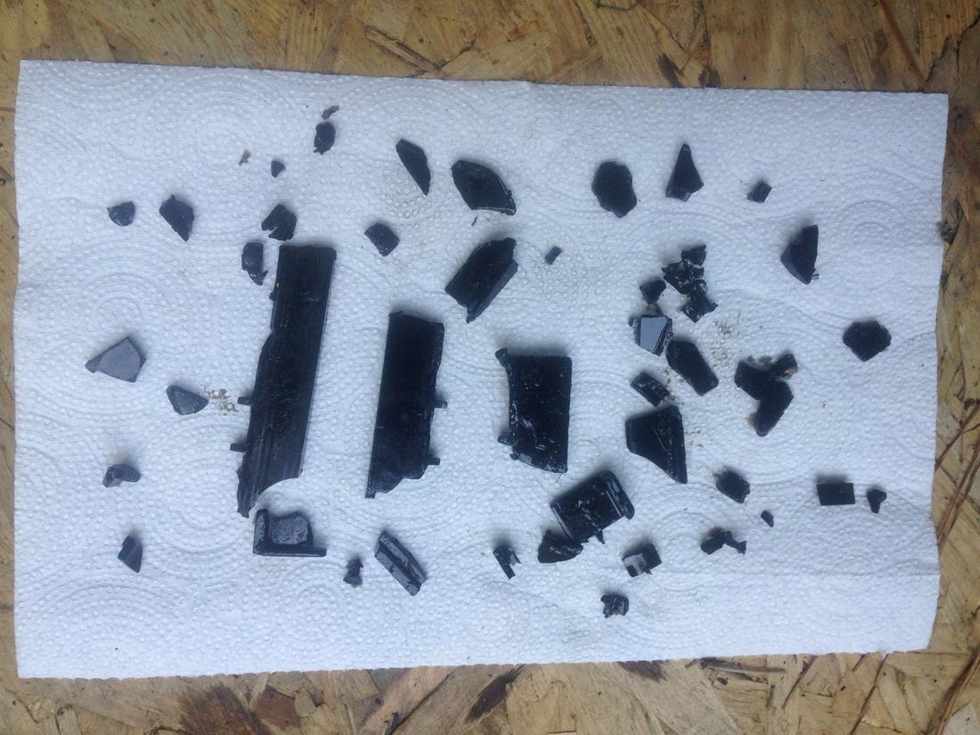

Well good thing I listened to you guys. My guides were fine but obviously someone's weren't at some point. This was all in the pan. No metal though so that's good news. Whoever changed this thing last time left quite a few bolts finger tight and 2 bolts in the timing cover were actually MIA. No wonder there was oil all over the front of this thing. So until I go to the store and grab those I'm on hold.

Nice. If nothing else that'll do wonders for your oil pressure.
"Hey look, my timing chain guides are broken"
"There, I fixed the guides, now I better drop the pan and clean out the pieces"
"Hmm, now that I've got some of these bolts off, it's become apparent that I need to drop the diff to remove the oil pan"
"Fukit, let's go fishin'. Fire it up, ma!"

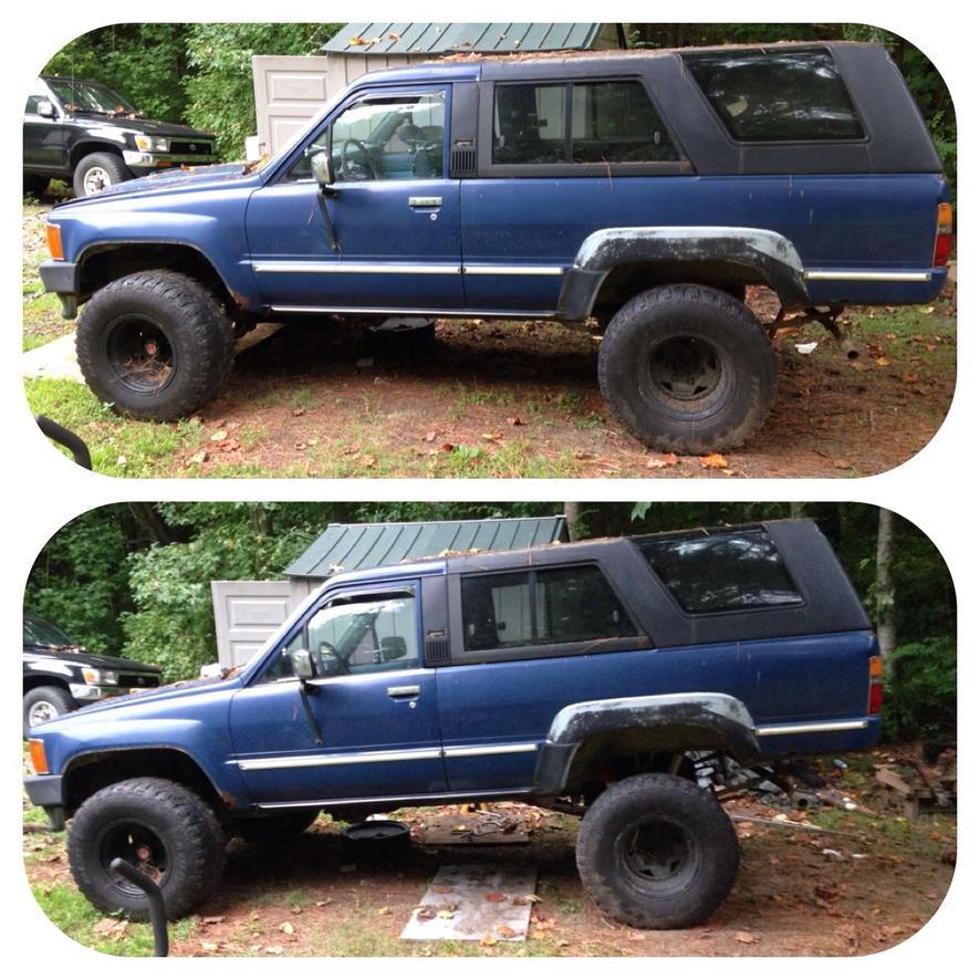

Well between work, weather and kids I finally started on the lift tonight. I knew I only had a couple hours so I figured I'd knock out the rear real quick. Well after an hour of trying all I could to get the shackles and front hanger bolts to free from the bushing core I finally gave up on that and decided to just pull the add-a-leafs from the donor packs and put them in my pack. Well to my surprise my truck already has an add-a-leaf. I'm assuming to make up for sag?? Anyways the add-a-leafs from the donor truck do have quite a bit more arch to them, though I guess that may not matter if they are a softer spring, I decided to put the new ones on and see how it goes. I got the packs all together and had to call it a night. Going to put the blocks in in the morning and button up the rear and see what I got. And I also scored a like new set of Rancho 9000 5 way adjustable shocks for a whopping $75 so I'm stoked about that.

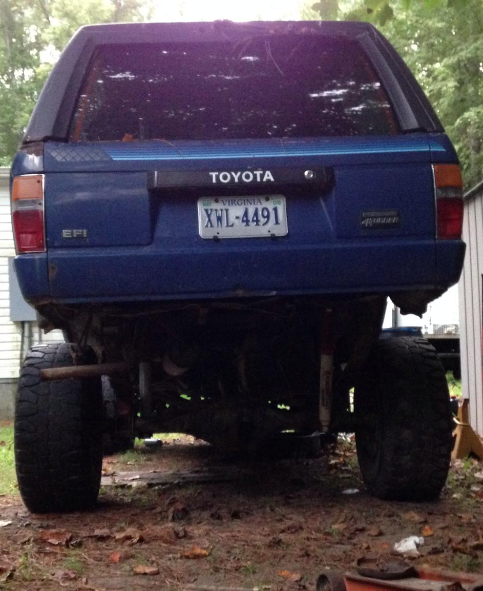

Before and after the rear lift. Got about 4" so I guess the bracket drop will be about right. Hopefully I'll have time to knock that out tomorrow. Gonna need some bigger rubber!!!

Yep, think 35's are in order,which means more gear, which means more motor, might as well get the SAS done and it can just go on and on.

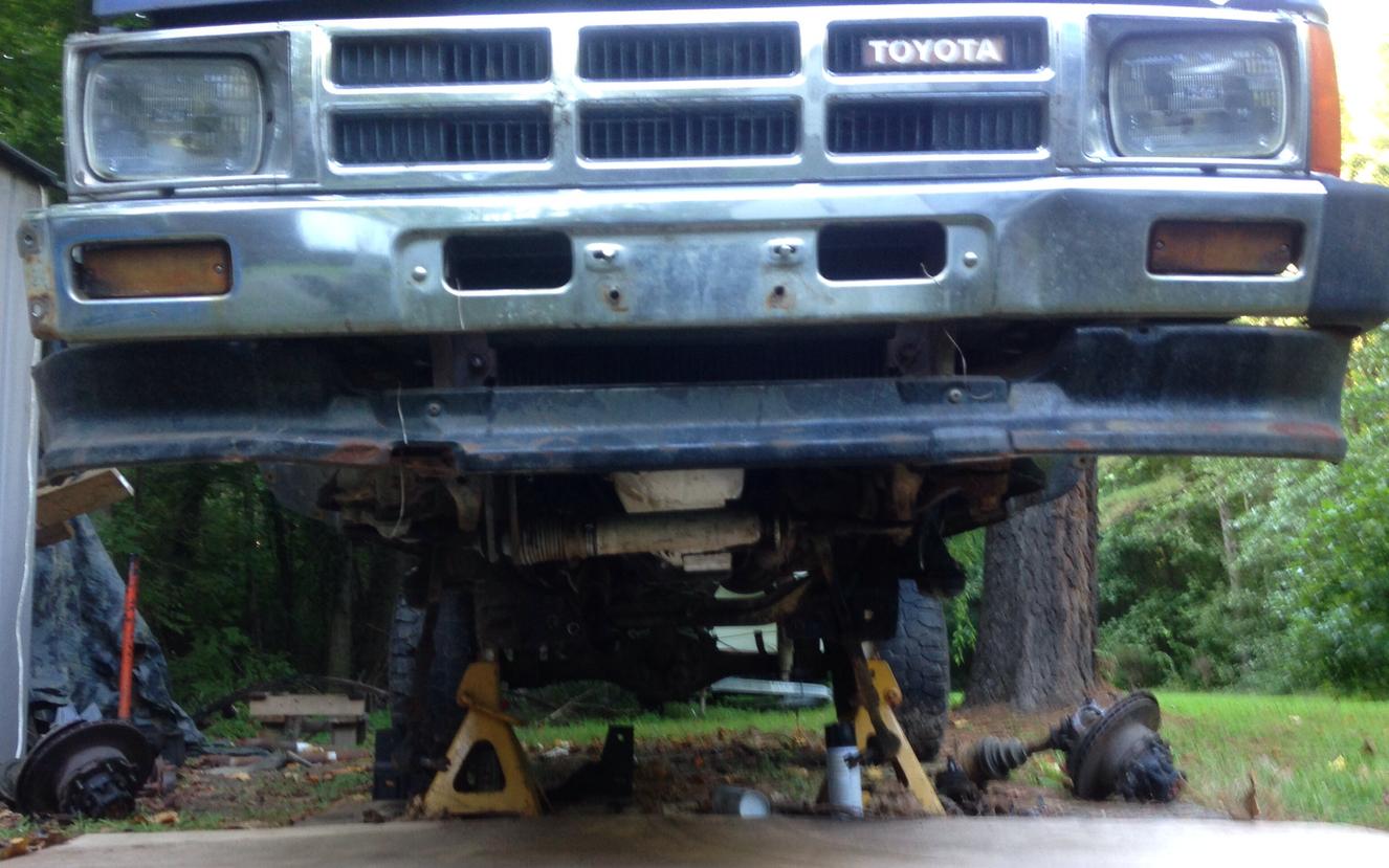

I wish. On a pretty tight budget as it is. Thinks it's gonna have to just roll on the 32's until they are shot then we'll weigh our options. Started the front tonight and just a few bolts into it and I'm already ready to say screw this and start the SAS. Every bolt in the lower control arm bushings are seized. Any tips on getting them out. I'm definitely stuck for now.

Some very useful advice. Thanks Kevin. I guess I've never really sat and thought what my stopping point would be but I guess thats really the first thing you should do when starting a build. Like so many of us this truck will have to be driven and modded over time as building what I want is just too far out of budget for one lump sum. I'm going to sit tonight and build this truck, in order of what I'd like to do on paper and I'll put the plan up here and see what your guys opinions are.
SAS so close yet so far $away$. Good news are all bolts are out, only had to cut 2 out. image.jpg
