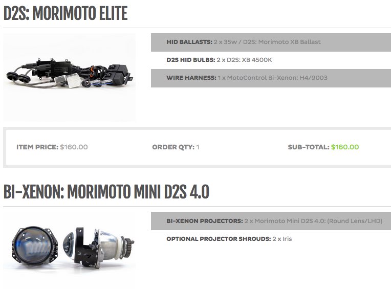

This is all of the stuff I'm running.
You can check to see if the solenoid that runs the shroud is working. Just take a 9 volt battery and touch it to the leads coming out of the projector. You'll hear a pretty audible click if it is working right.
