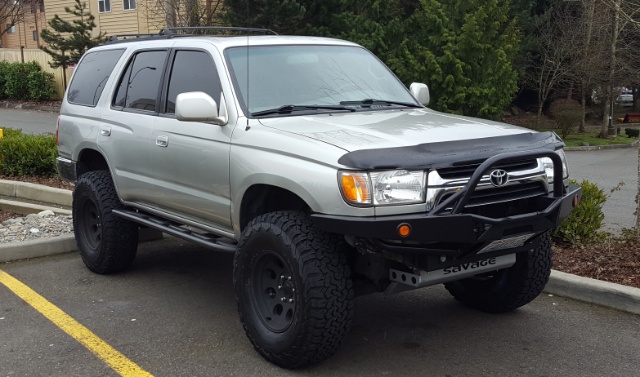

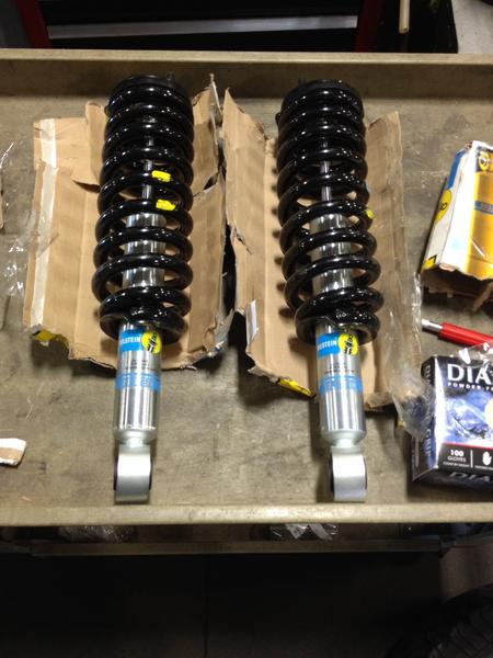

THIS was taken right before installation. I don't have any other photos that really show the perch. You have three different perches, and this seems to be the best one for ride quality and not tearing up axles.

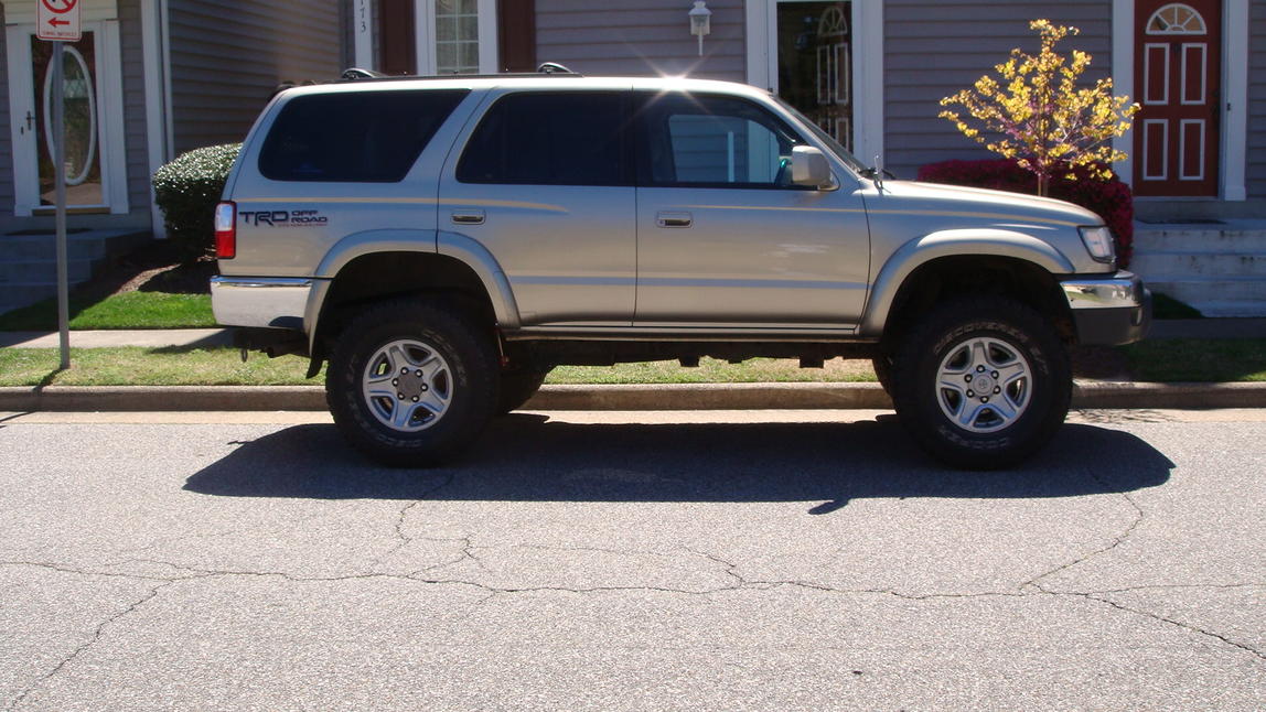

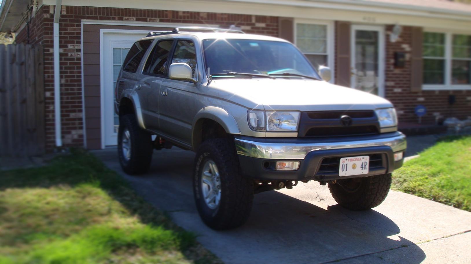

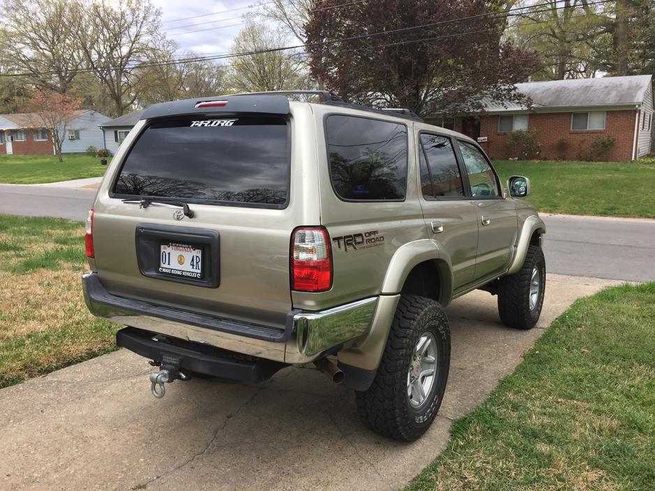

This is my Sonoran Steel 1.2 Setup with a 1" Body lift, and 285/75/16's. I am running 1.25" Spidertrax Wheel Spacers on all fours, but up front I do experience minimal rubbing. These photos are also under normal driving conditions, not under load. I haven't done any trimming, however I have removed the lower portion of the front fender flare. I hope these are good photos for reference.
