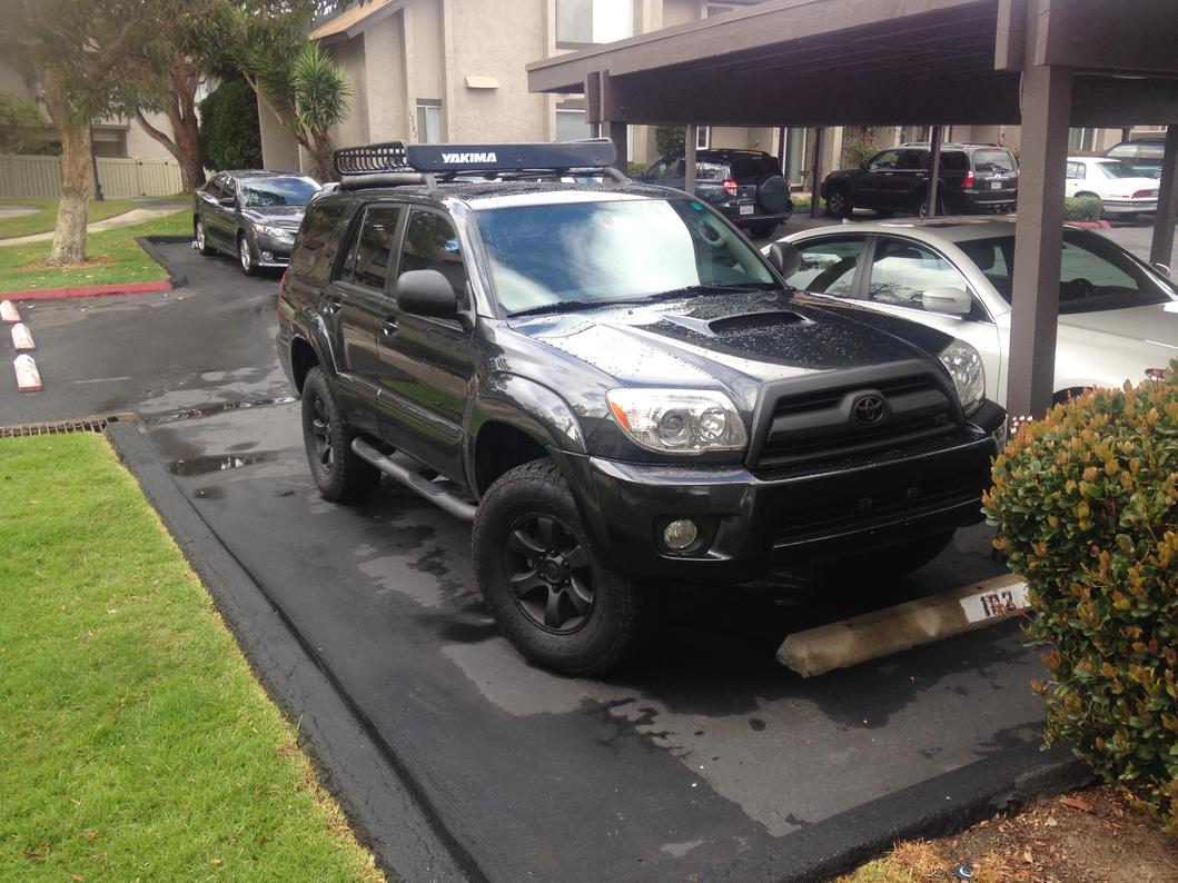

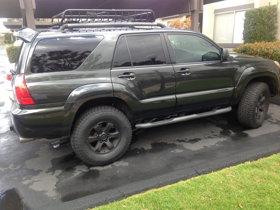

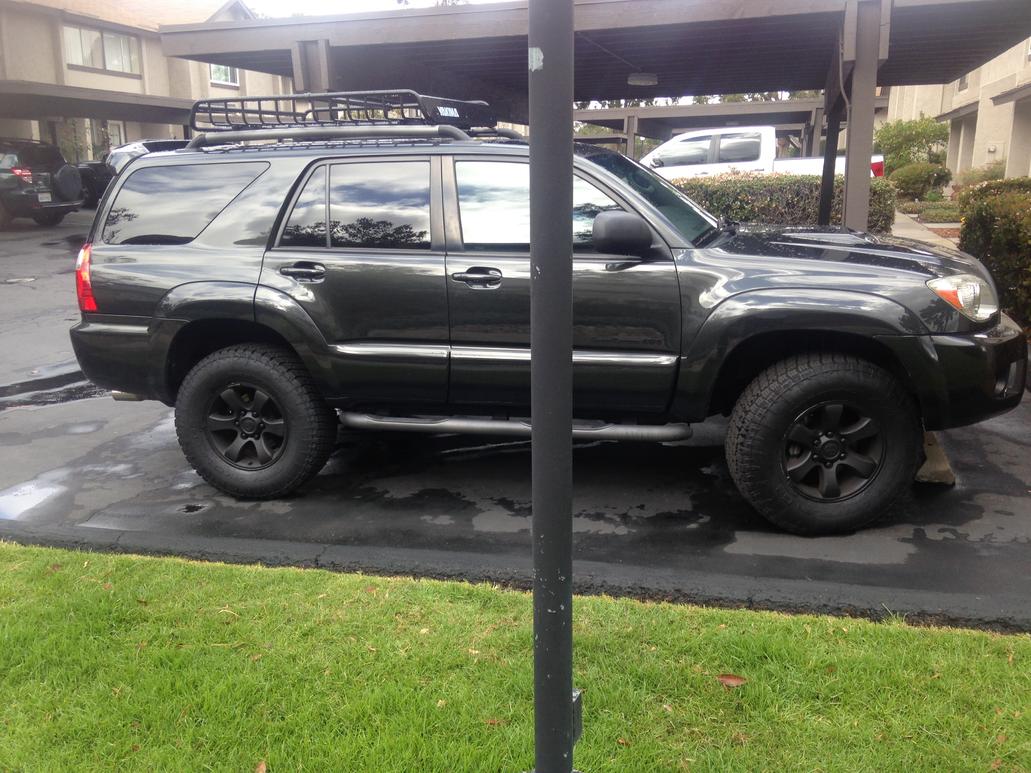

So update with photos. Couldnt be happier with the ride and look of this setup. Was shopping for best deal on several tires I was interested in but in the end talked Big 0 tires down to $170 a tire for Terra Grappler 2's. Still running 1/4 inch spacers on the front. Might just stick with them as new wheels with the right offset and specs are hard to find. I don't see a 1/4 inch slide on spacer as a big deal. No rubbing at all right now. Added a yakima megawarrior this week. May add lights down the road we'll see. Gonna pump the brakes on upgrades for a bit as it gets addicting lol.
