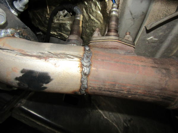

I had mine mounted between the transmission pan & the downpipe. I have headers on there now but I can get a photo tomorrow. I had a shop do it since it was way easier to weld up on a lift by a professional, rather than a hack-job by me.
Perfect! There isn’t much room with the Doug thorleys so I am trying to figure it out to have this done ASAP.
Here's the photo and I'll explain what you are looking at:
gamefreakgc-albums-engine-performance+mods-picture49195-wideband-sensor-next-stock-o2-sensor.jpg
The left is the piping coming from the engine. That's the weld on flange that is coming from the headers. The guy who installed my headers used a slightly larger pipe, welded the flange on, then welded the pipe onto the existing stock downpipe. The O2 sensor on the right is the stock O2 in the stock location, where you can see the wideband and bung welded right before it but slightly offset so the two do not block one another. What you cannot see is the transmission pan (the camera was right up against it) so you pretty much want the sensor straight up and down or the wiring harness will not clear the transmission pan.
