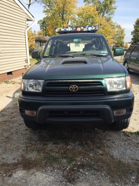

Pretty decent price depending on undercarriage rust. A spot on the bumper likely means there is a lot under the trunk.
And its definitely a sport a.k.a highlander.
Sport hood and color matched grille/bumper = sport.
Hood scoop and colored bumper says sport. Does it have an e-locker? Some did, most didn't.

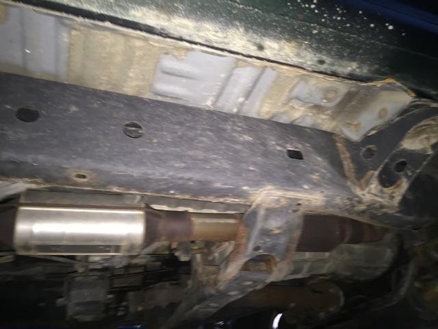

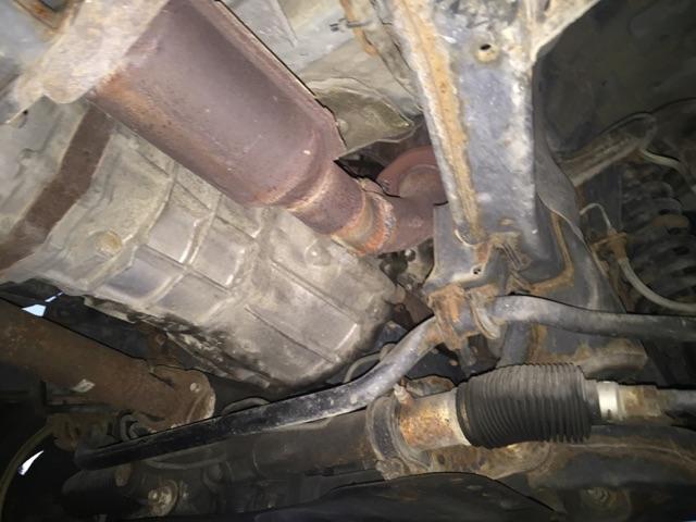

It does not have the elocker. Waiting to hear back about water pump and TB. Tires have approx 28k on them so they have some life left. I haven't seen it in person yet. He's sending over pics of undercarriage but he says it's clean.

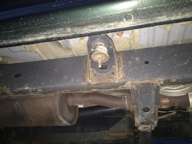

He just sent over undercarriage pics. Anything concerning?

Check the inner side of the LCA mounts. If they are solid, you're in the clear. If not, walk away or use it as a negotiating point and get it welded. The rest is surface rust which only scares guys out west or in the south that don't know what Liquid Wrench is.

I agree with [MENTION=71030]T4R2014[/MENTION]. Looks about like mine before I did its first underside rehab this summer (still in progress).

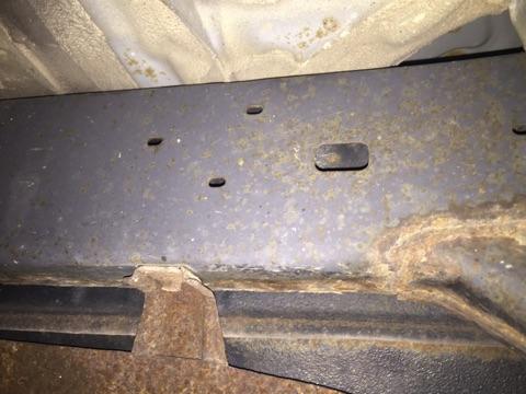

commenting on the frame pictures, It is always better to get underneath and check the inner frame walls. The surface rust is only at the weld seams and it looks like it is the factory frame paint which makes for an easier wire wheel and paint job underneath. pulling a boat up a wet concrete ramp can get slippy but 4-L grabs like a mother when you drop the clutch so if you know what you are doing, should have no problem walking the boat out. Price seems good, just do a good check over of everything listed in that first link and you should be fine. Cant beat a smooth shifting 5er
Additional pics
