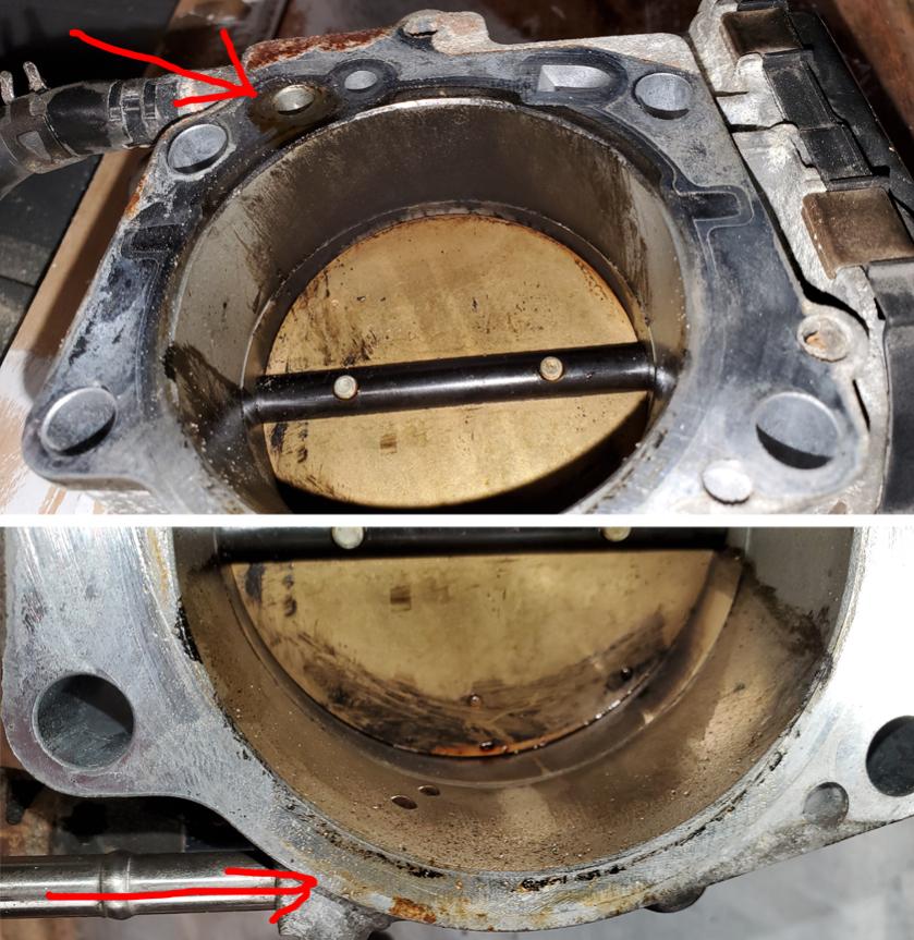

I thought I'd do a little follow-up. Since the weather was nice, I decided to remove the throttle body and bring it down to the basement for a good thorough cleaning.
One thing I did notice (pointed out by the red arrows) is it looks like the gasket isn't sealing as well as it should. I should pick one of those up and replace it... I'm wondering if that seepage around the top photo accounts for the liquidly black stream passing through. That's the coolant return orofice, correct?
