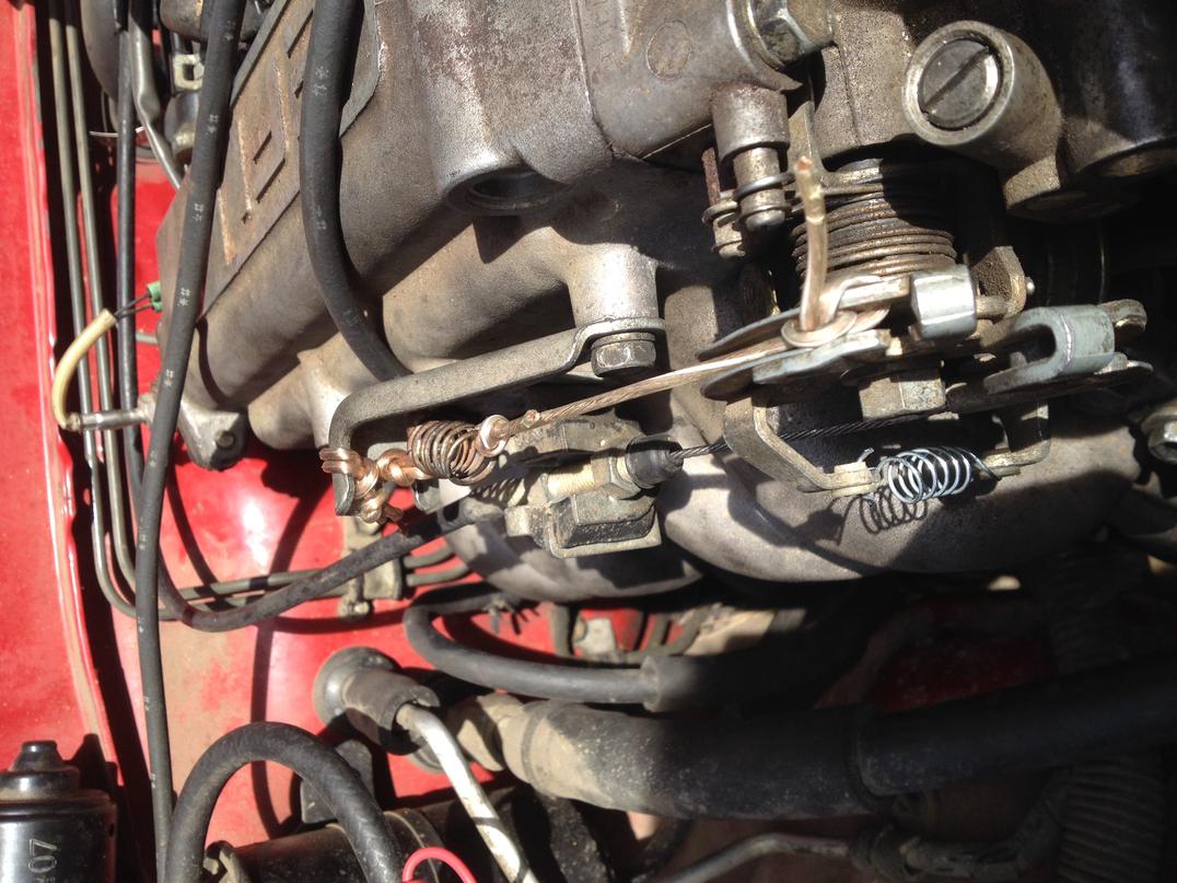

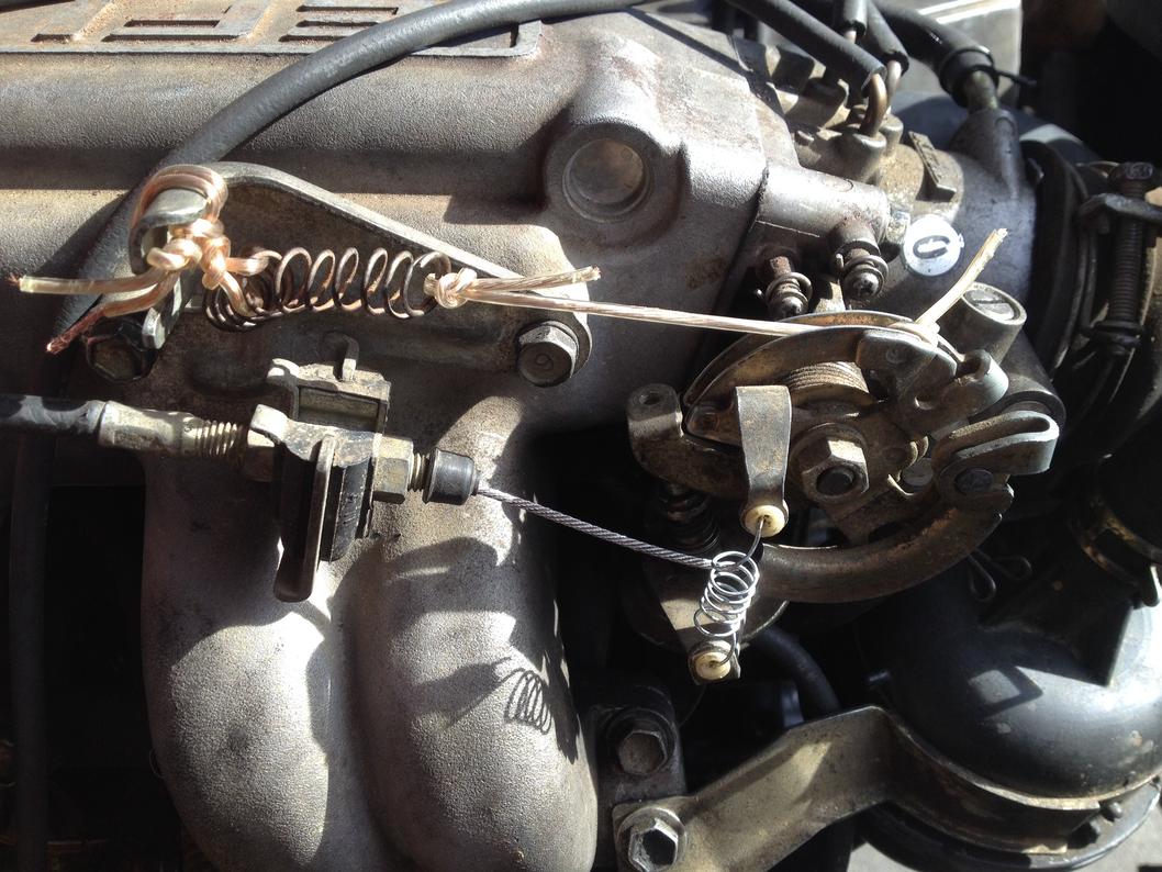

So I fixed it using chuckles metho in my own way. Speaker wire :/ an a stronger spring. Works very well. The gas pedal is a little bit more stiff but I like it.
Nice trick! I'll have to remember this one if mine ever stretches out. Hard to imagine though, as I have almost the opposite problem with my '86.
