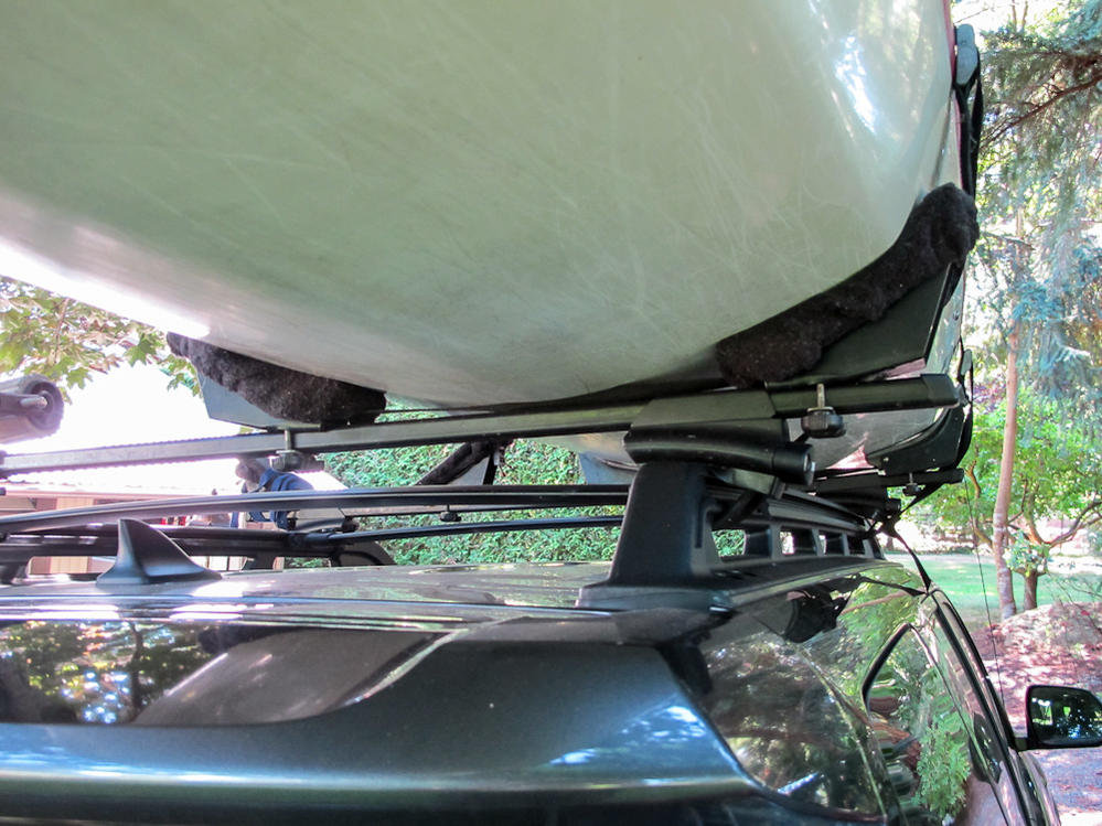

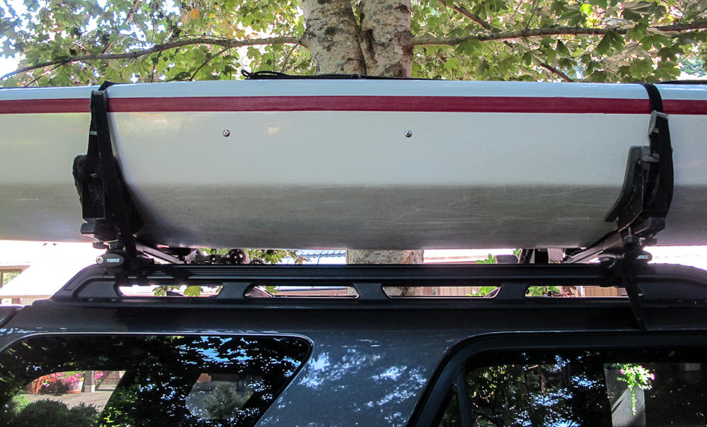

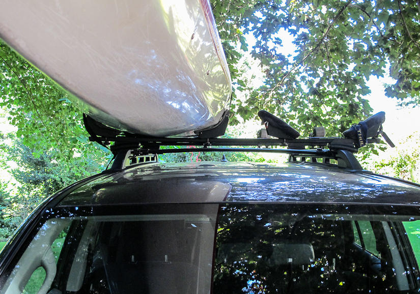

You're right. Between the ground clearance of the TE and the height of the siderails plus the Crossroads, it's crazy high. My neighbour and I needed stepstools to get my 22-foot, 100-pound triple kayak up there.
The top photo shows the 44-inch fore and aft spacing between the loadbars, which is great for stability, especially with a long load.
The other two photos show the width of the setup with 58-inch Thule loadbars, especially when one kayak saddle is positioned outside the foot. That kayak has a 30-inch beam, and you can see there's a lot of room left for another wide boat.
The two loadbars take about 10 minutes each to attach or remove from the siderails, but I might get faster at it. As I mentioned, the rack setup is too high to fit in our standard height garage.
