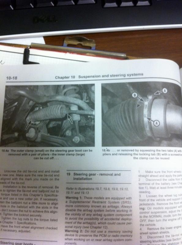

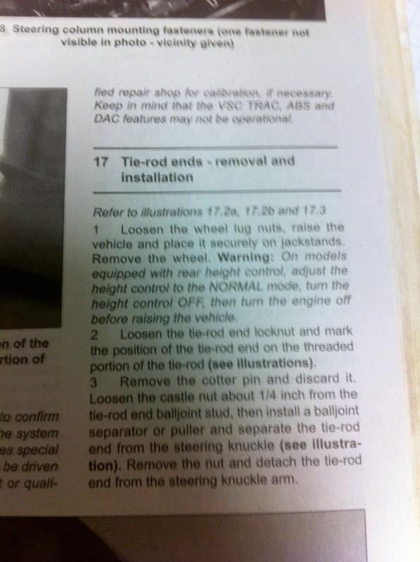

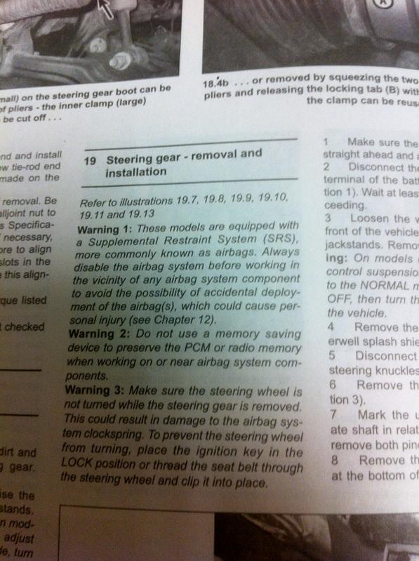

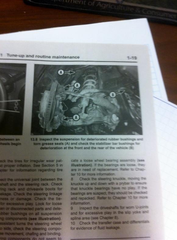

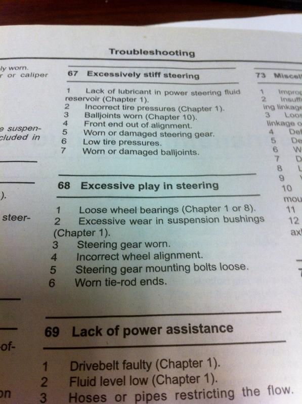

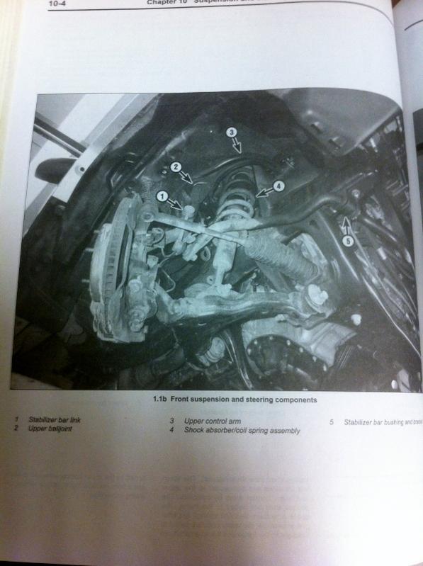

You should save 20 dollars of that 50 and invest 30 bucks in a haynes manual lol full of info ill help you out this time...

heres some more info on the rod ends and checking the rack out....(like we need help checking out racks:girl:...lol)

Hope this helps

I guess you posted while I was composing. Anyway you are correct! I just ordered the Haynes manual - $17.80 from Amazon & should be here by Saturday. Thanks for posting the pix I'll review them now.
its all up there in black and white for ya... sounds like you could just change your lower control arm bushings and swaybar bushings and be back to tighter steering.
