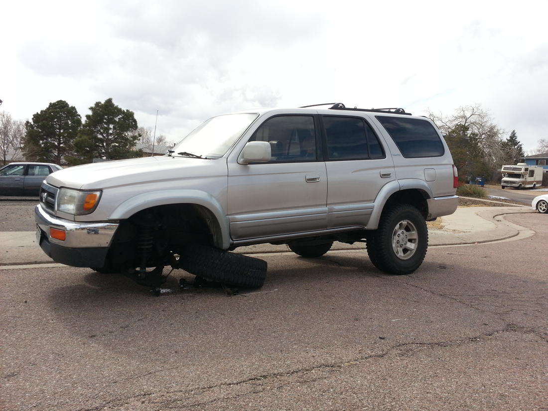

Dont wait on the ball joints, unless you want this to happen like happened to me!!!!
