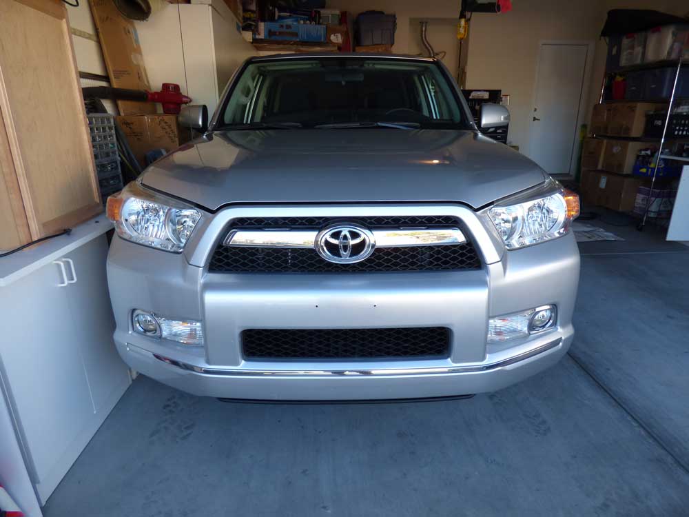

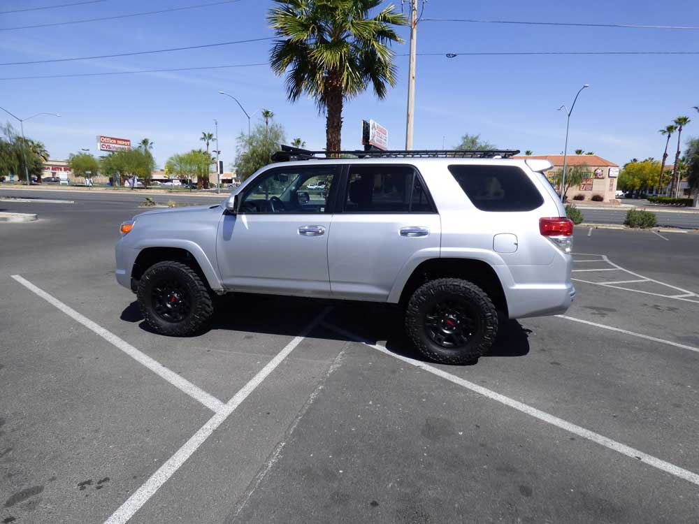

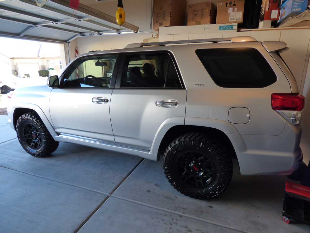

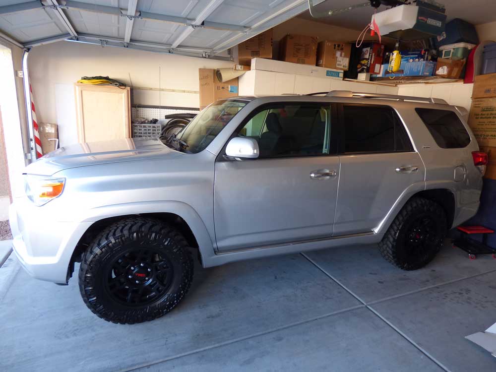

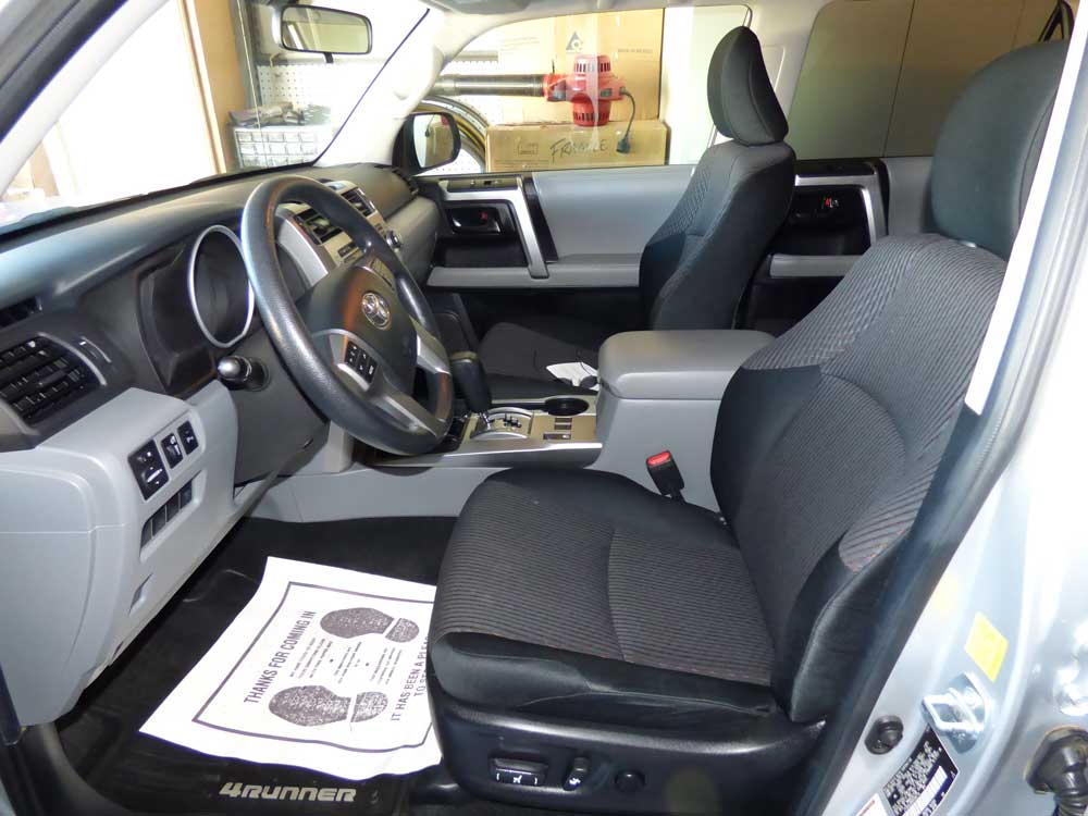

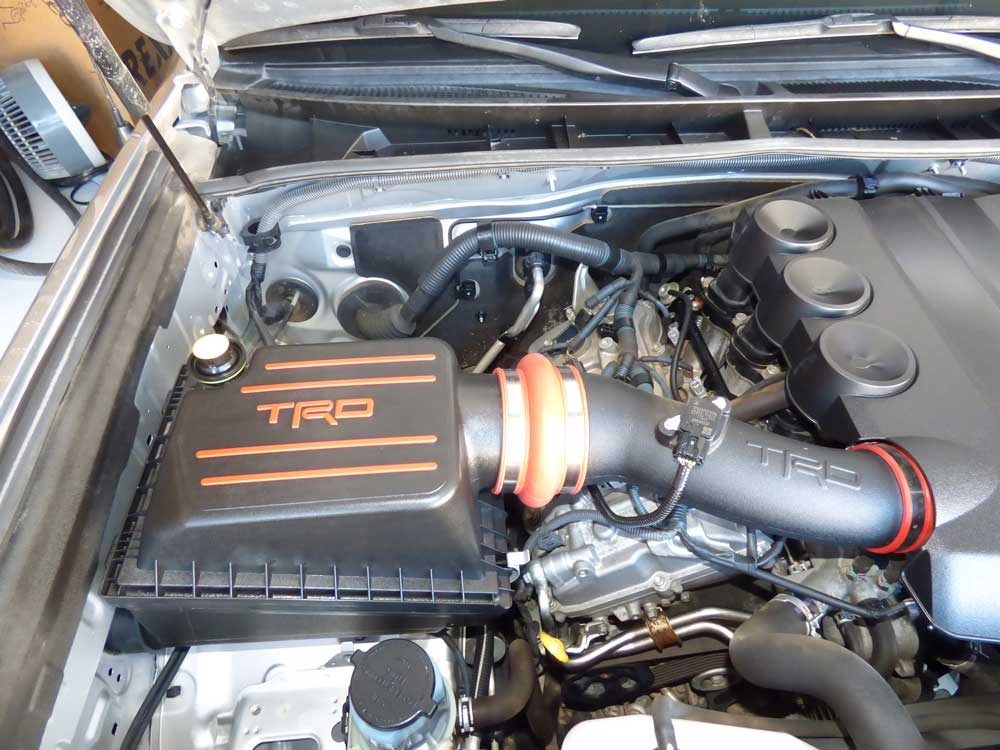

But this is what I came home with, 2011 SR5 with a couple extra goodies already added to it:
TRD Wheels
Nitto Terra Grapplers M/Ts

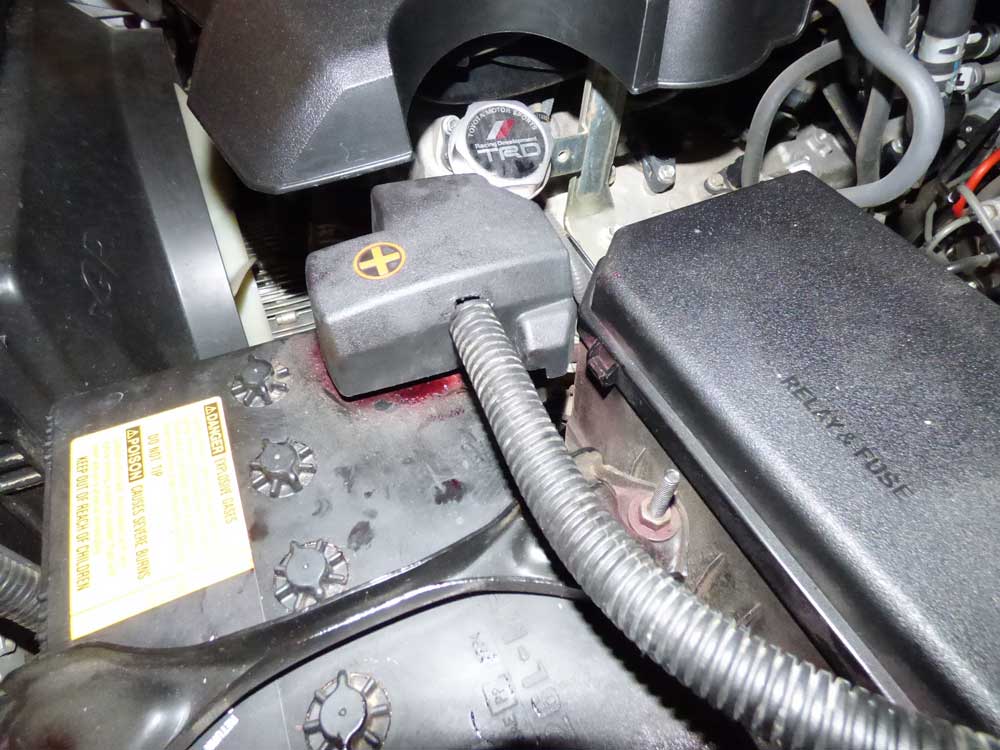

TRD Intake

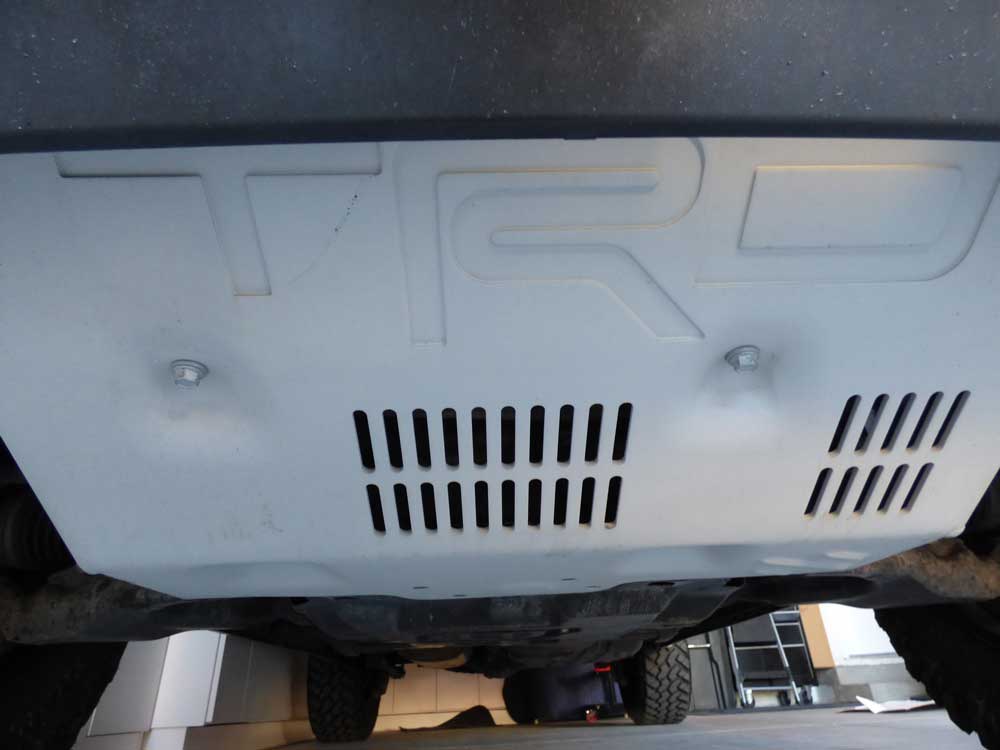

TRD Skid
TRD Oil Cap
A ton of white dog fur and red mud

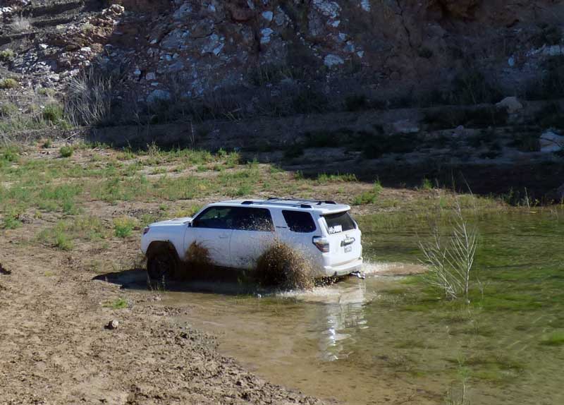

First thing to do was test it out and see what I had gotten myself into. I have to say, even 8 months later, I am still not used to driving something this big off-road. The Jeep was very compact and I knew where every corner was. This thing is like driving a tank. But I will eventually get the hang of it one I start getting out on more trails.
I tagged along with some great guys from the Vegas group out to Boathouse Cove on Lake Mead. (2/16/15 - 5 days after purchase)
Not a fan of mud but always willing to convince others to go in :brick:

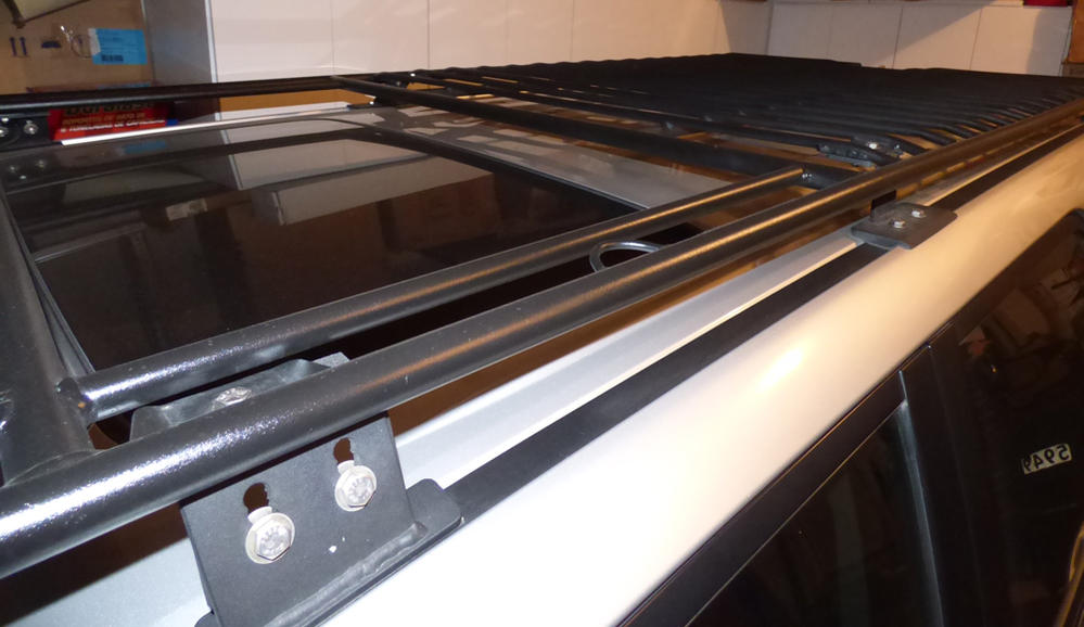

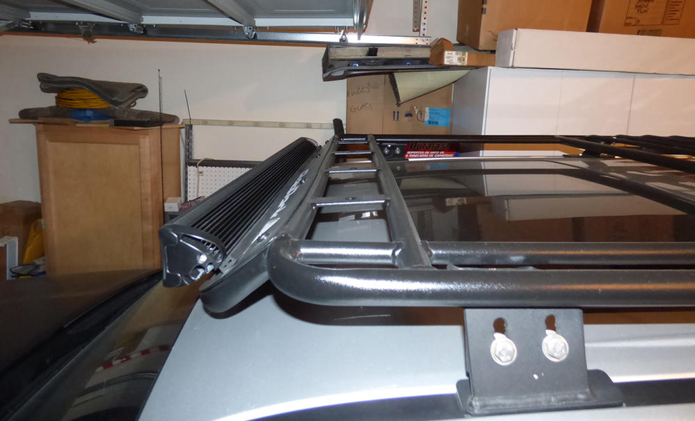

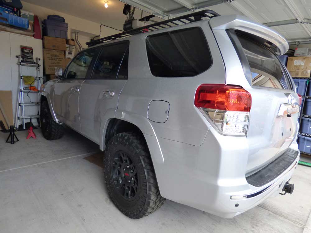

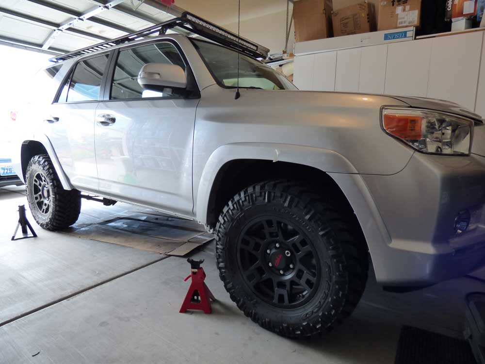

First mods. I picked up a slightly smashed Baja Rack from a local member. Seems FedEx ran over it or something. Front part had some pretty good dents in it.
F23B7040-A1F1-4568-B066-CA80BD5E613E_zpsxveuqoyq.jpg~original
FBCAB032-5286-44DE-8ABA-5DD6123F9DB2_zpsbfp7ds0h.jpg~original
I was able to straighten it out fairly well using a floor jack and ratchet straps. Not perfect but serves its purpose. I curved the lower bar to allow the rack to sit closer to the roof. It did help reduce wind noise.

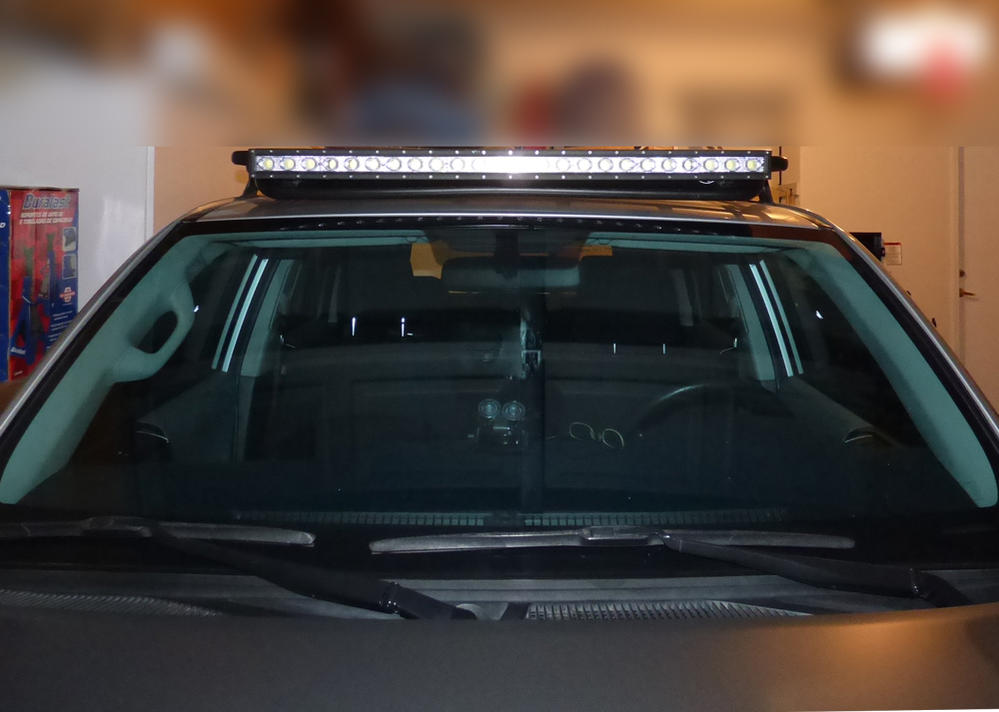

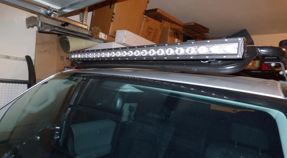

Also added a 40" light bar I bought from a member off of classifieds. Guess the day his bar arrived from SuperBrightLEDs, his wife told him she ordered a RI for his birthday.

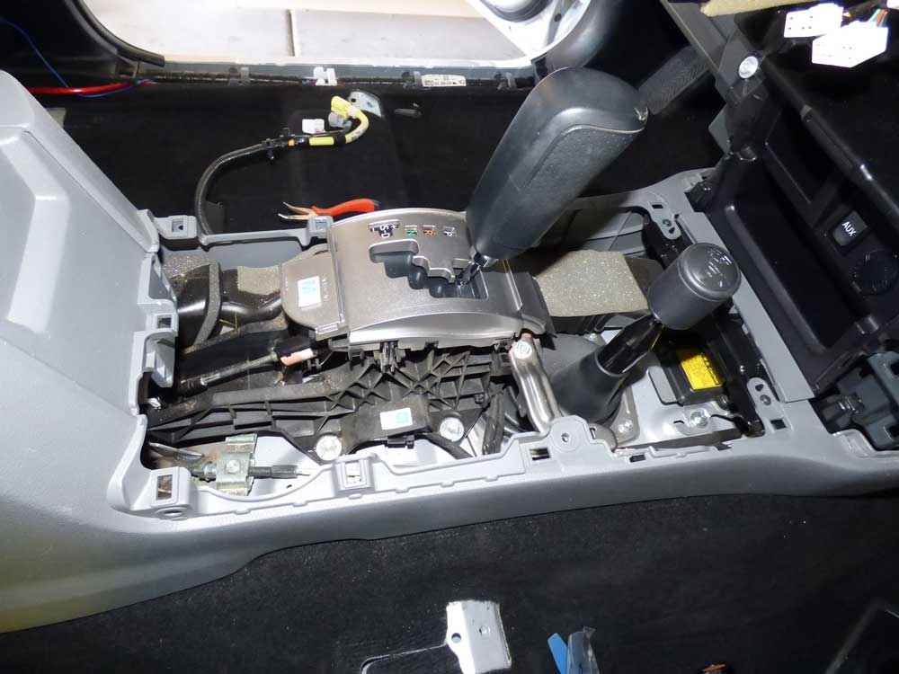

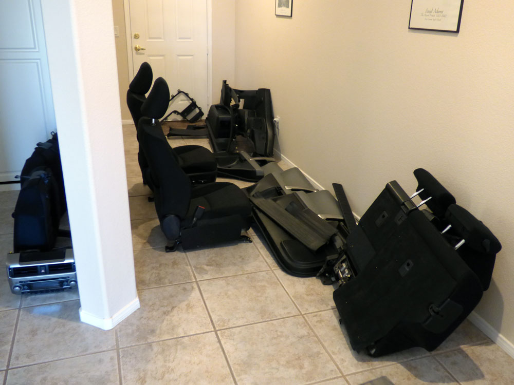

So first major mod for me was upgrading the crap stereo that is the SR5 Base system. I decided if I was going to do an install, I might as well quiet things down on the inside as well. What would normally be a 1 or 2 day install ended up taking a couple of weeks.

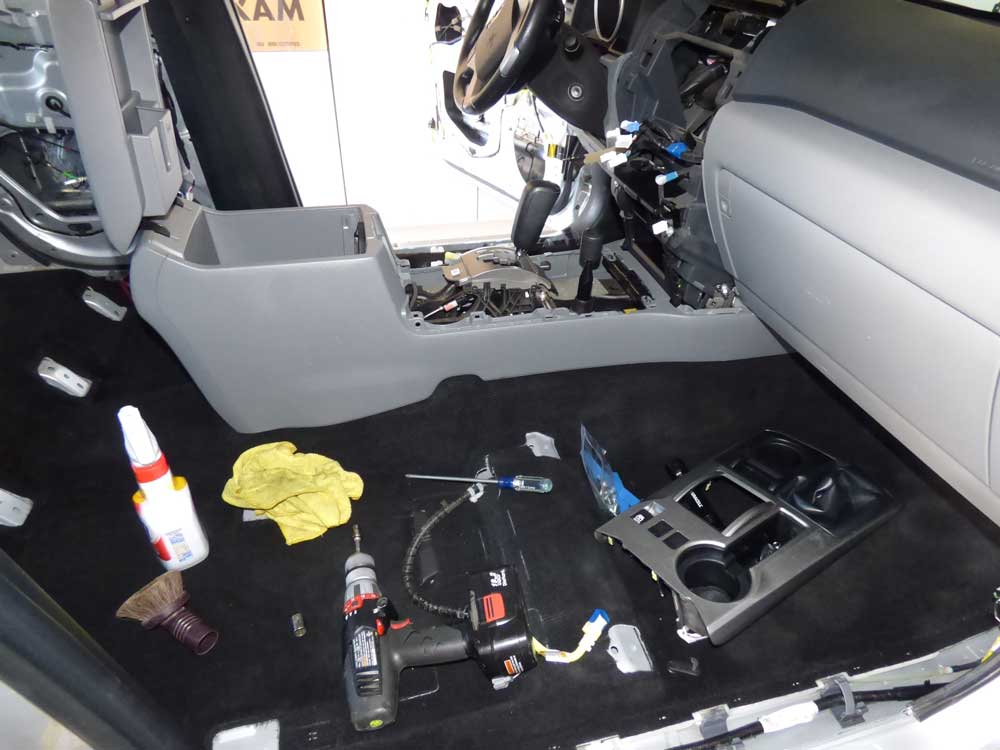

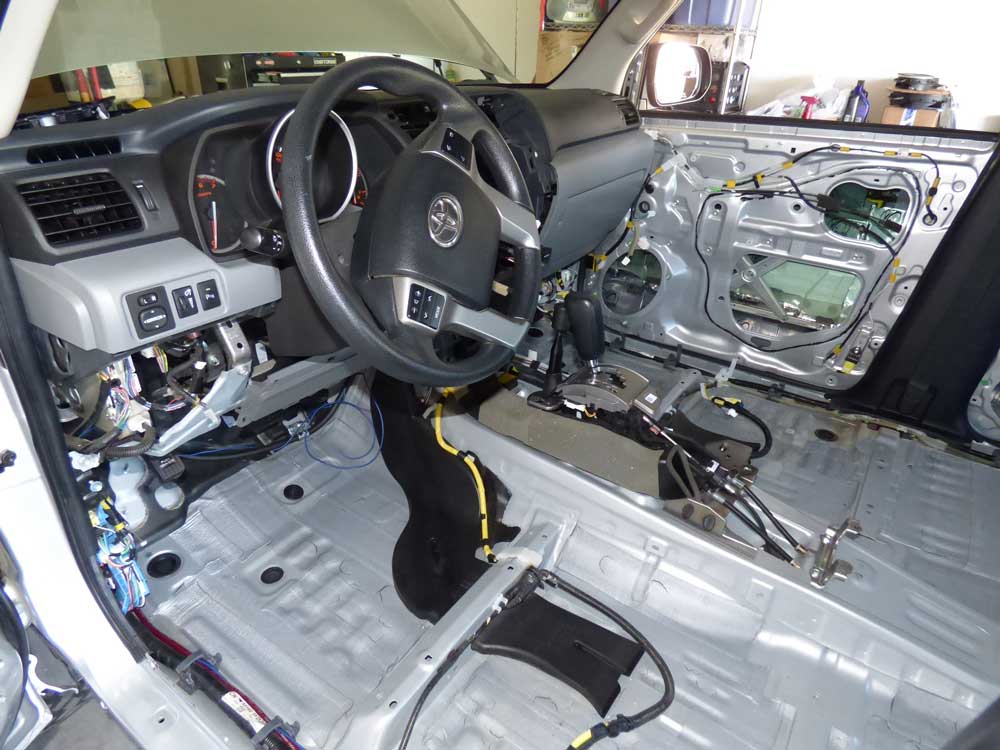

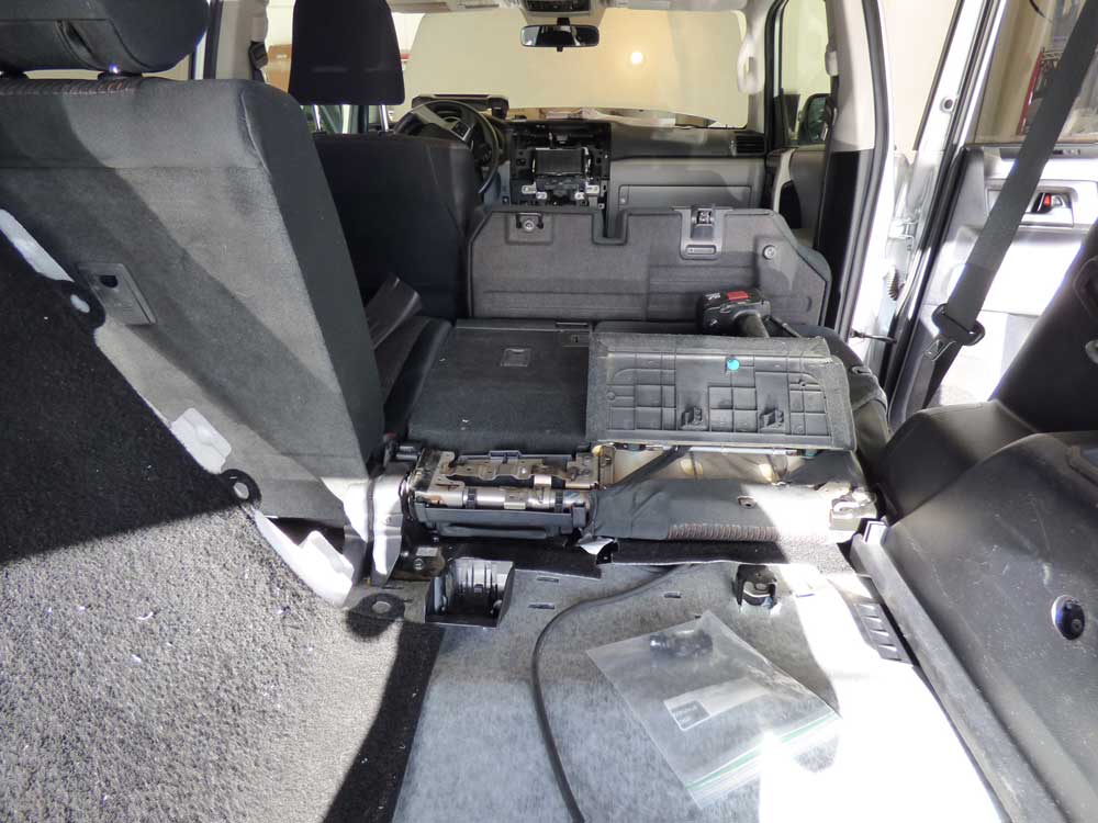

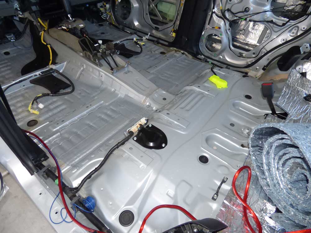

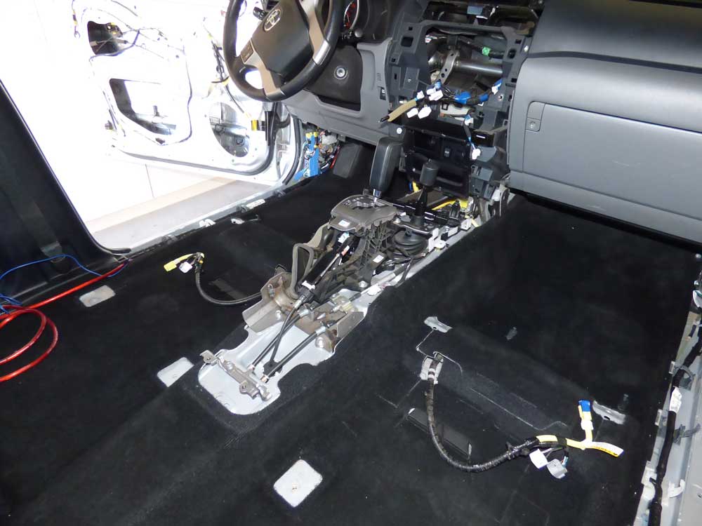

Let's start by removing a couple of interior pieces to gain access

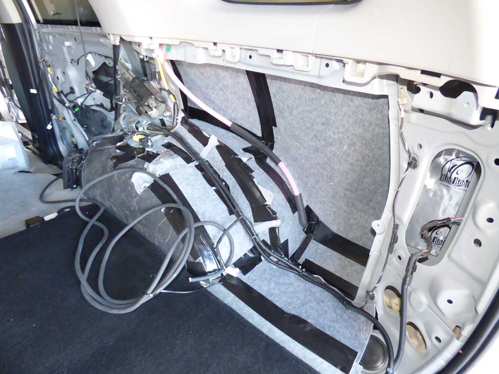

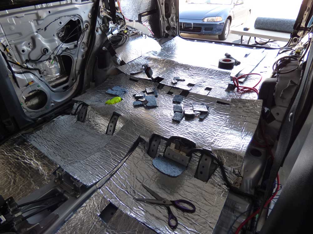

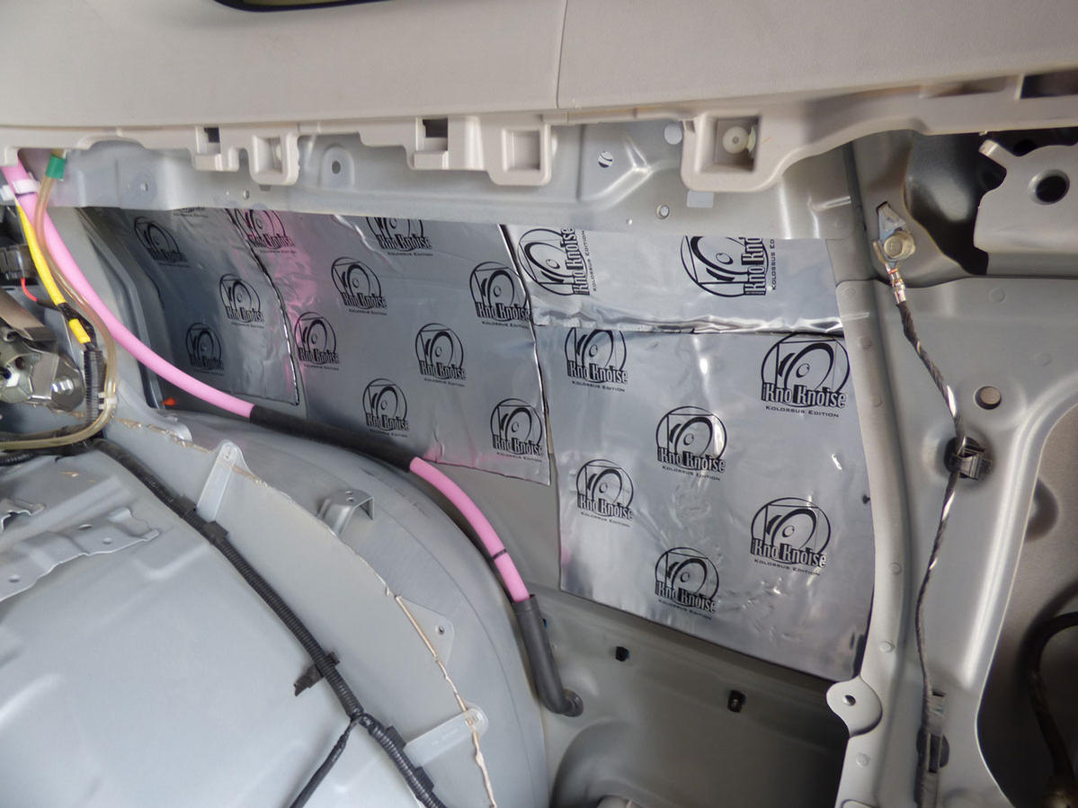

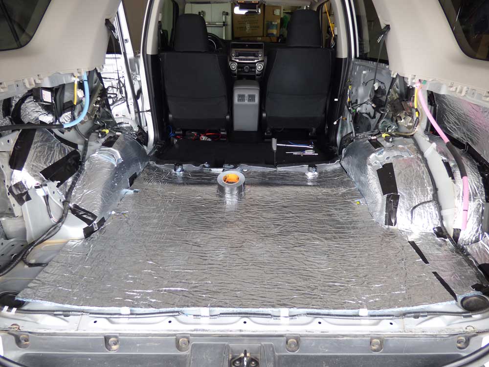

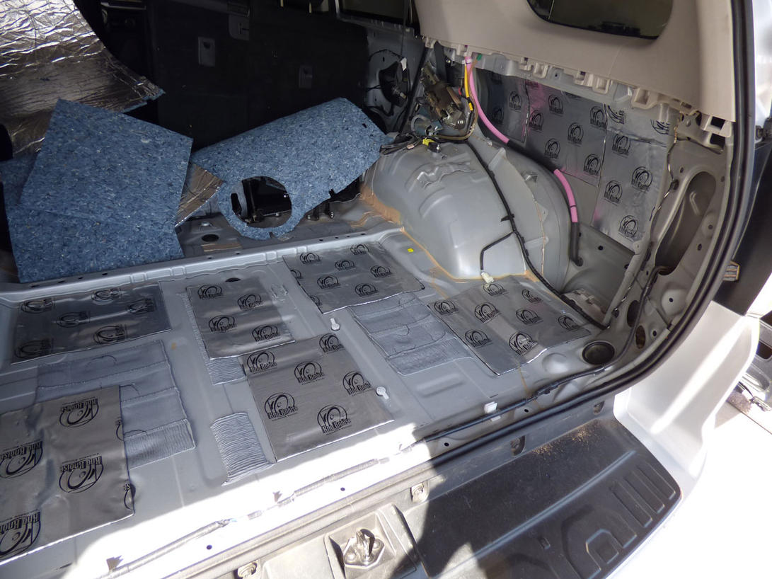

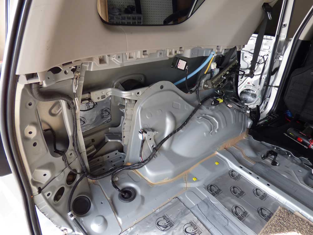

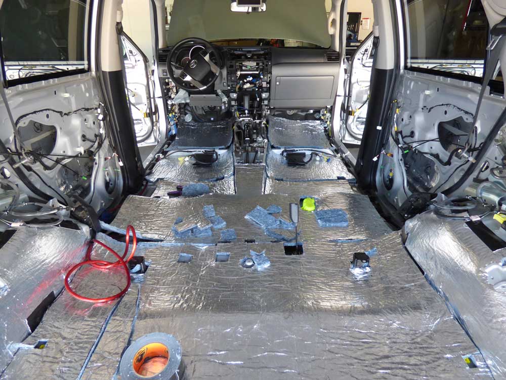

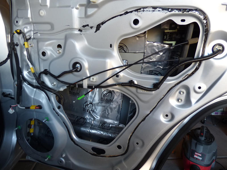

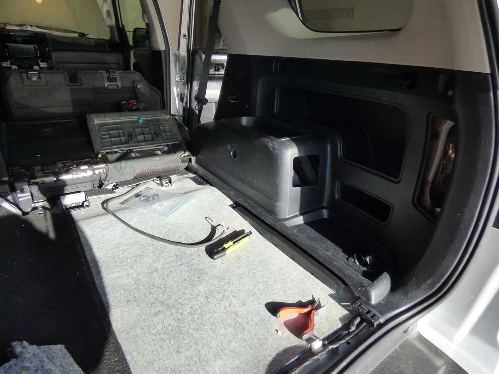

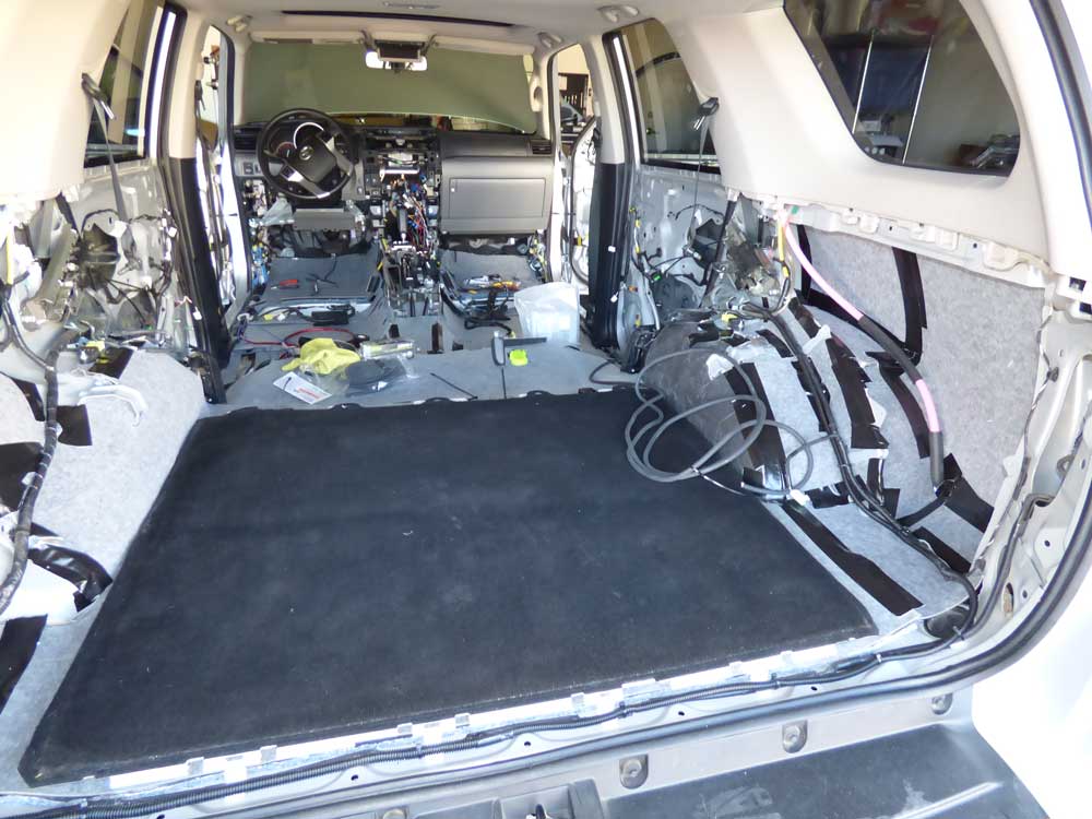

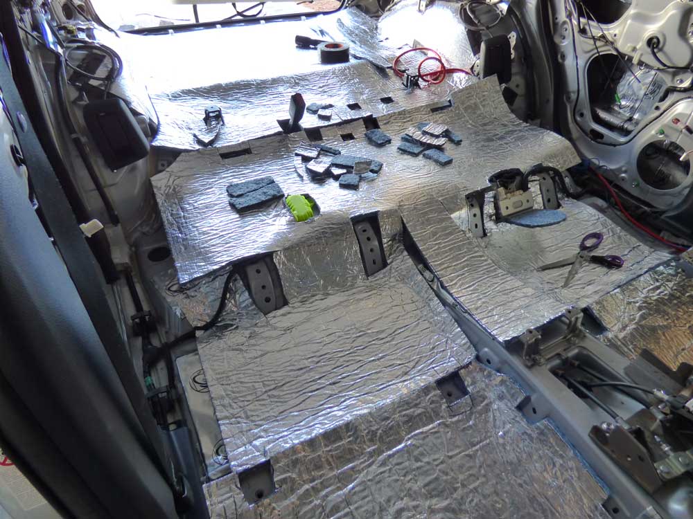

Plan: pull out all of the lower panels and flooring. Install KnoKnoise 100 Mil CDL over all metal surfaces. Then putting down a layer of Radiant Barrier, then will cover everything with a layer of MLV.
Adding in a rear camera, Pioneer AVHX5700BHS, Alpine PDR-V75 amp, Boston Pro 6.5" in the front, 10" Alpine Type R DVC sub. Still haven't swapped out the rear or hatch speakers.
Let the destruction begin.

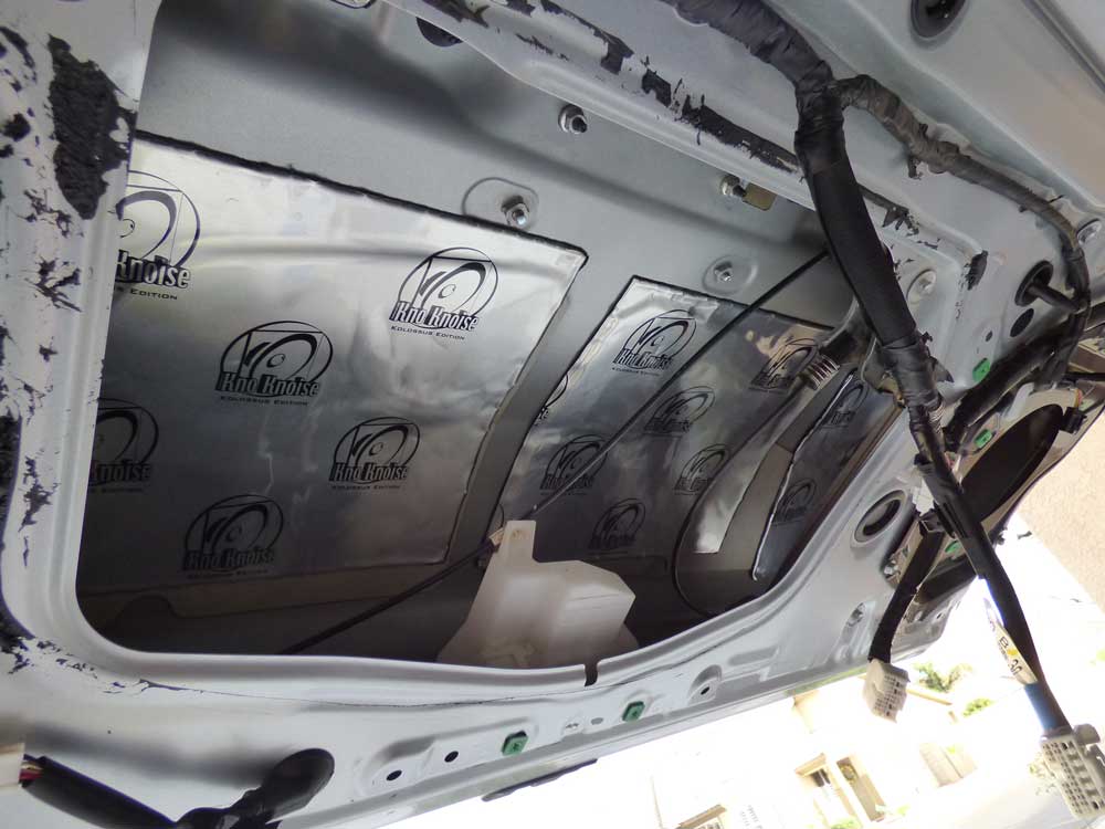

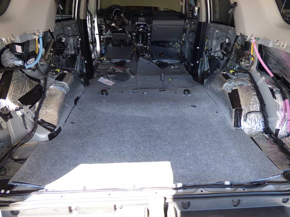

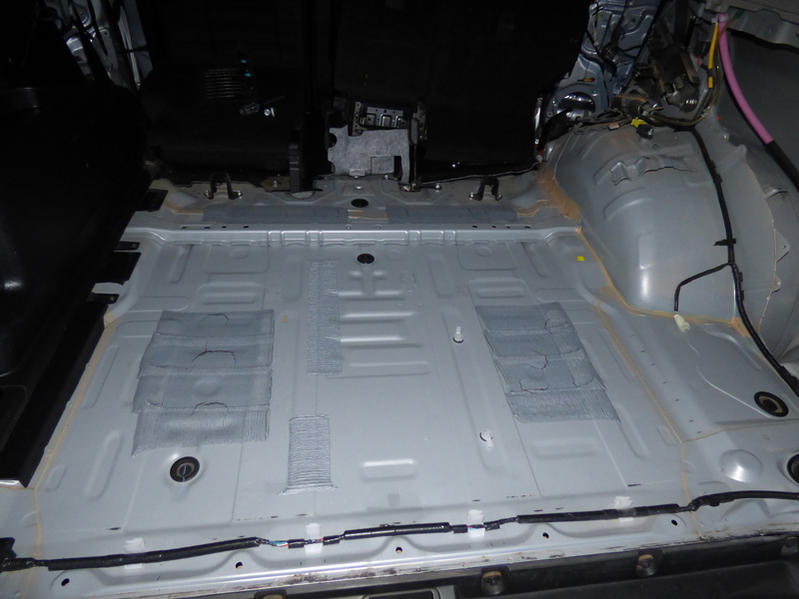

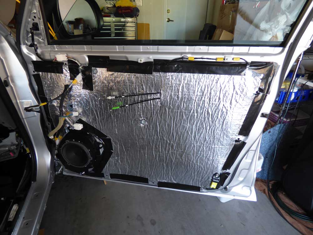

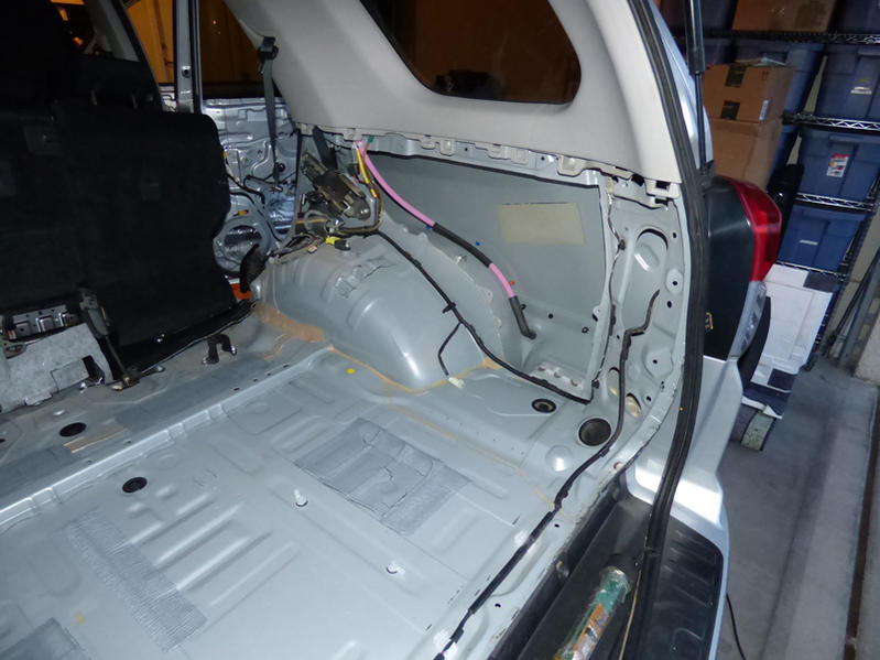

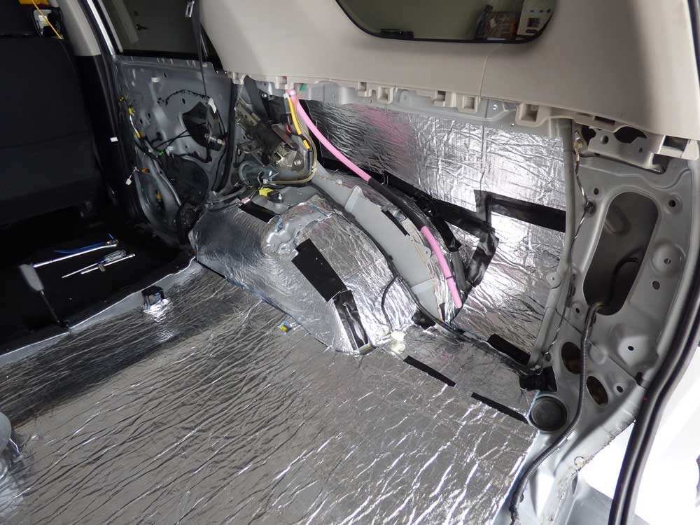

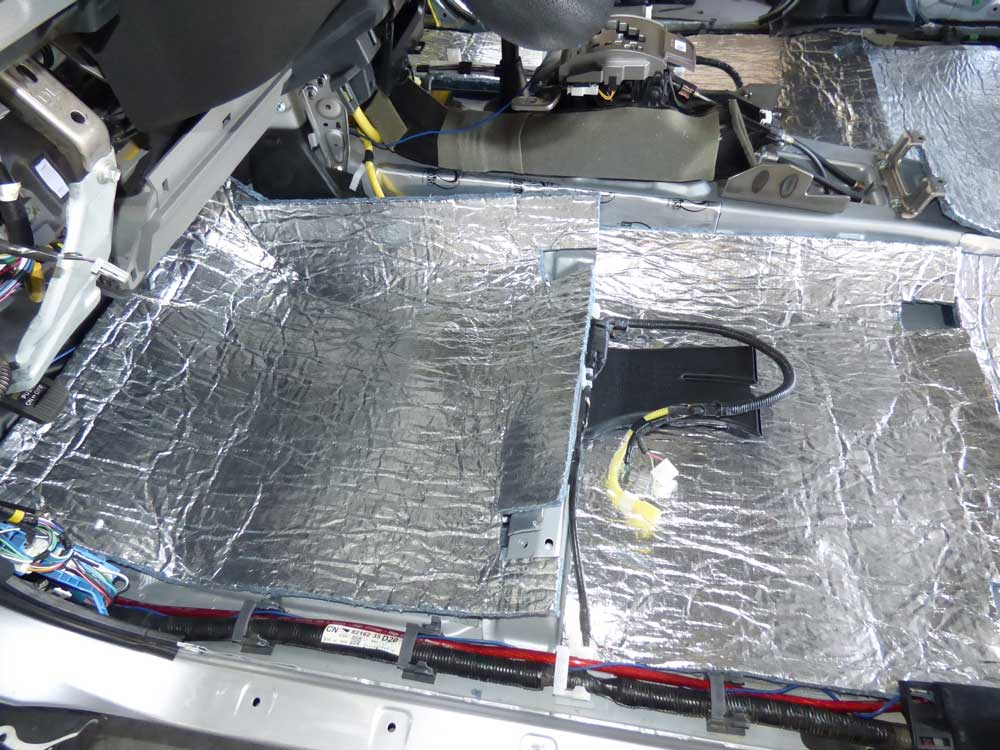

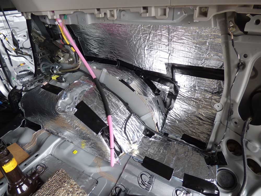

Using KnoKnoise as the constrained layer dampener (CLD). Rated very highly for dampening ability.

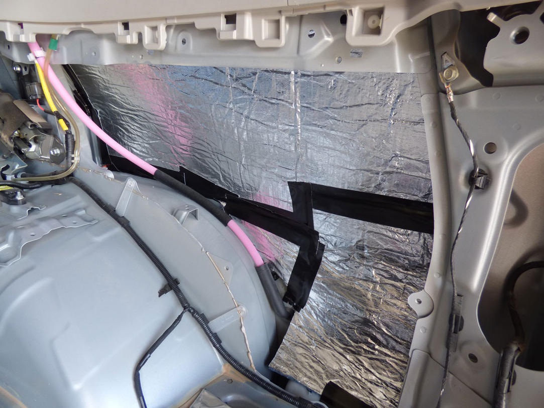

Then covering with RadiantBarrier. Then placed a layer of mass loaded vinyl (MLV)

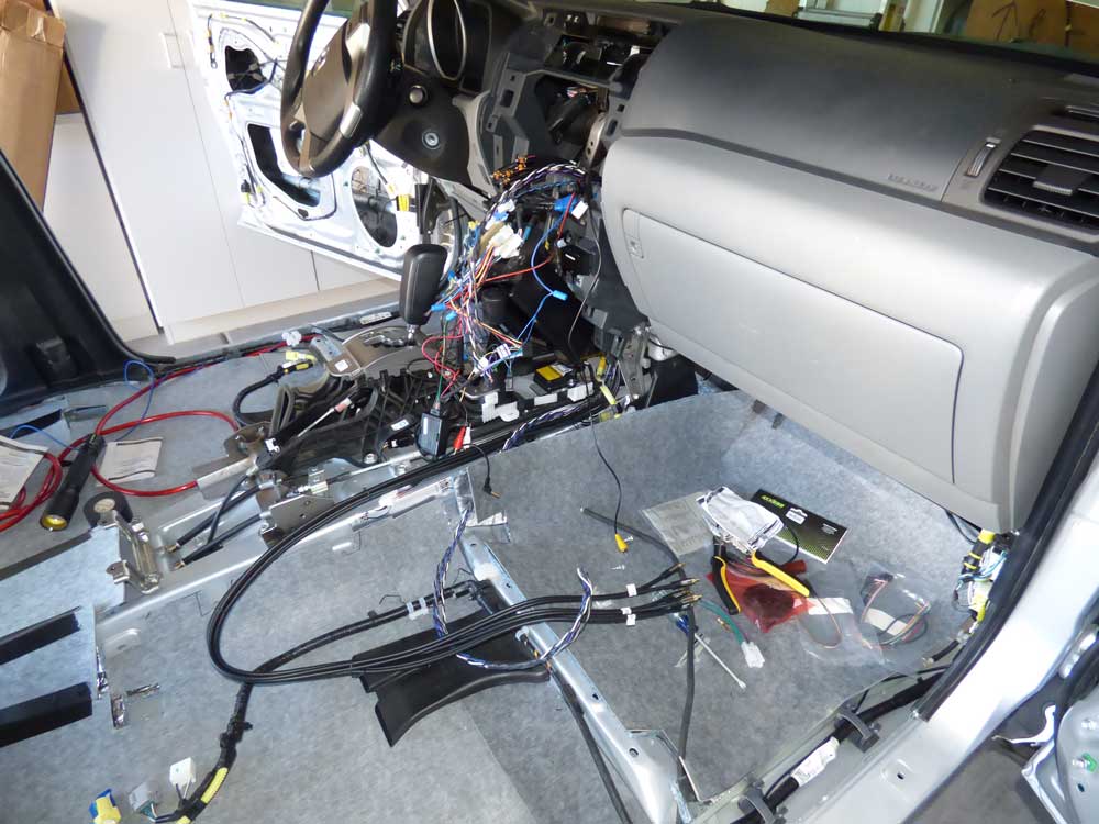

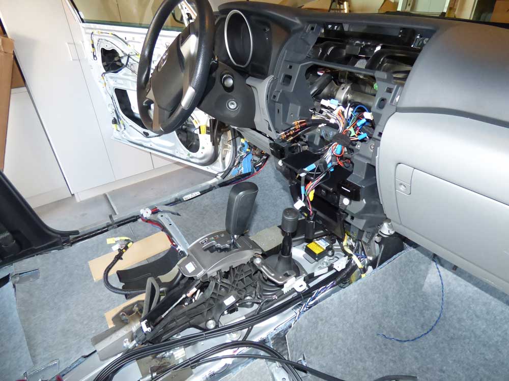

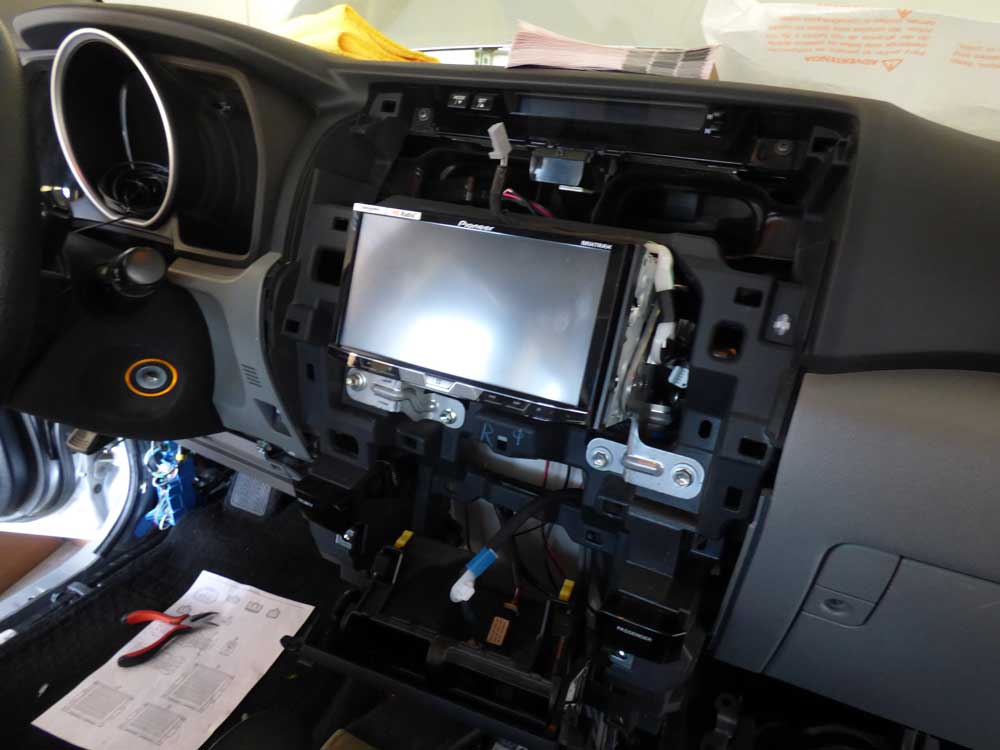

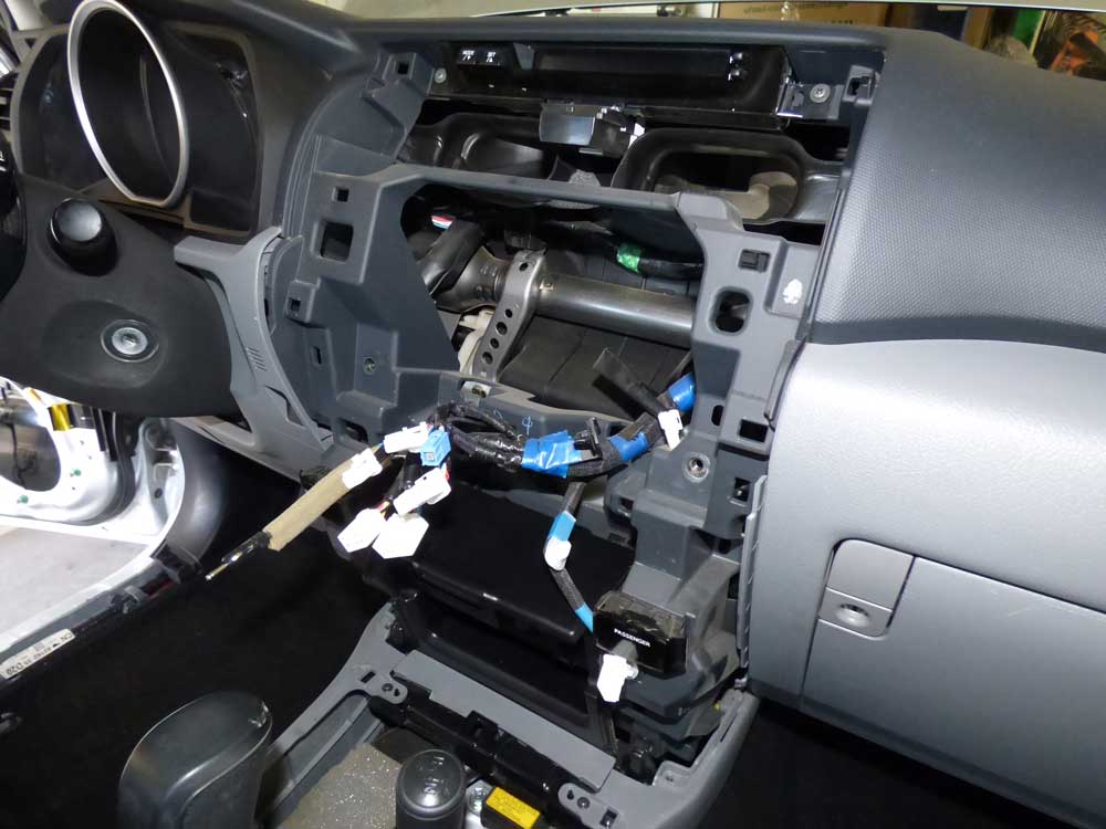

It was time to start tearing apart the front. This is where the fun really begins
Looking very silvery. Should be pretty quiet

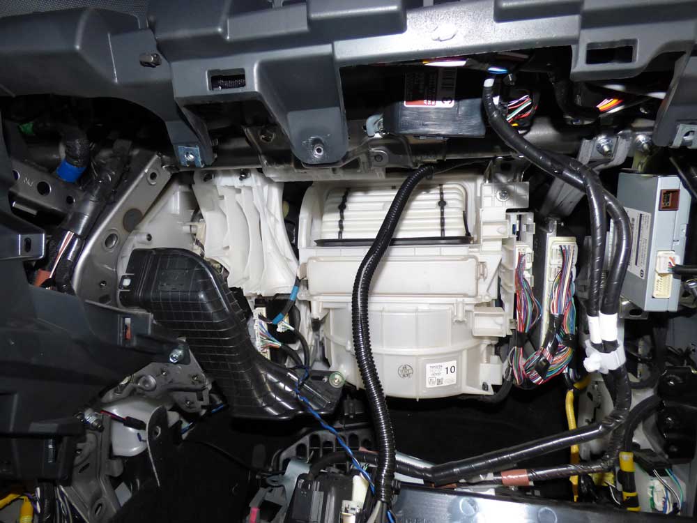

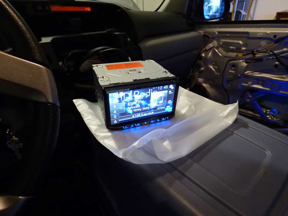

After I opened the Pioneer head unit to start wiring that, I found out that Amazon was kind enough to ship me a used unit. So back it goes and another big delay in this project. I am running out of time quickly.

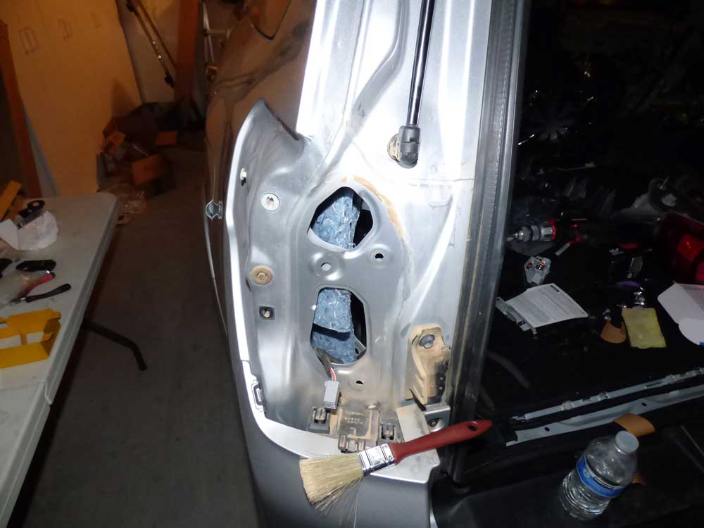

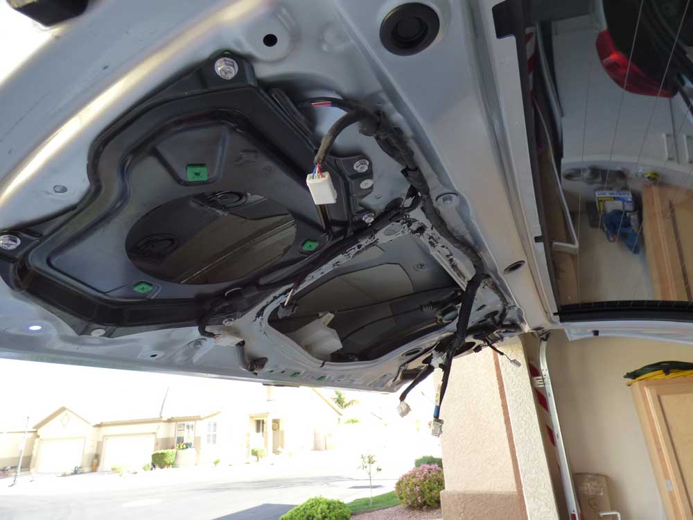

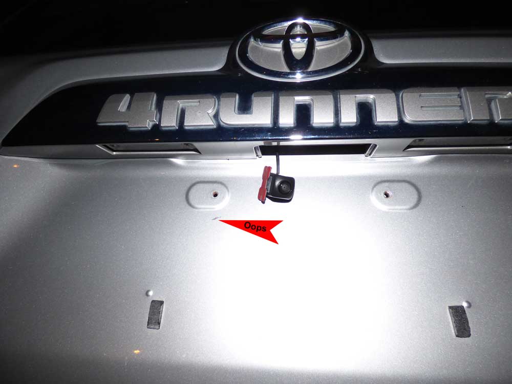

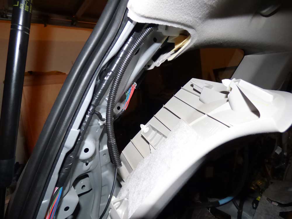

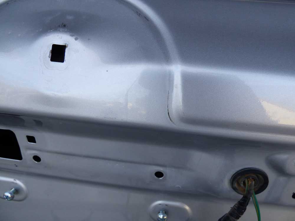

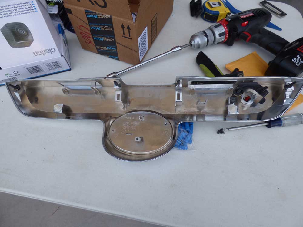

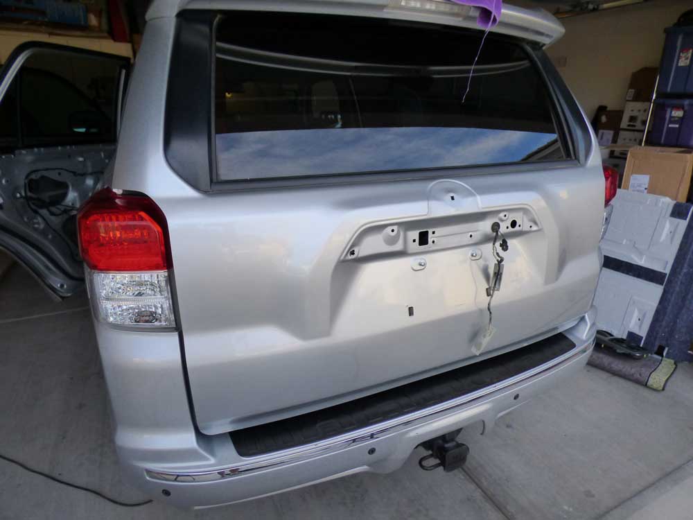

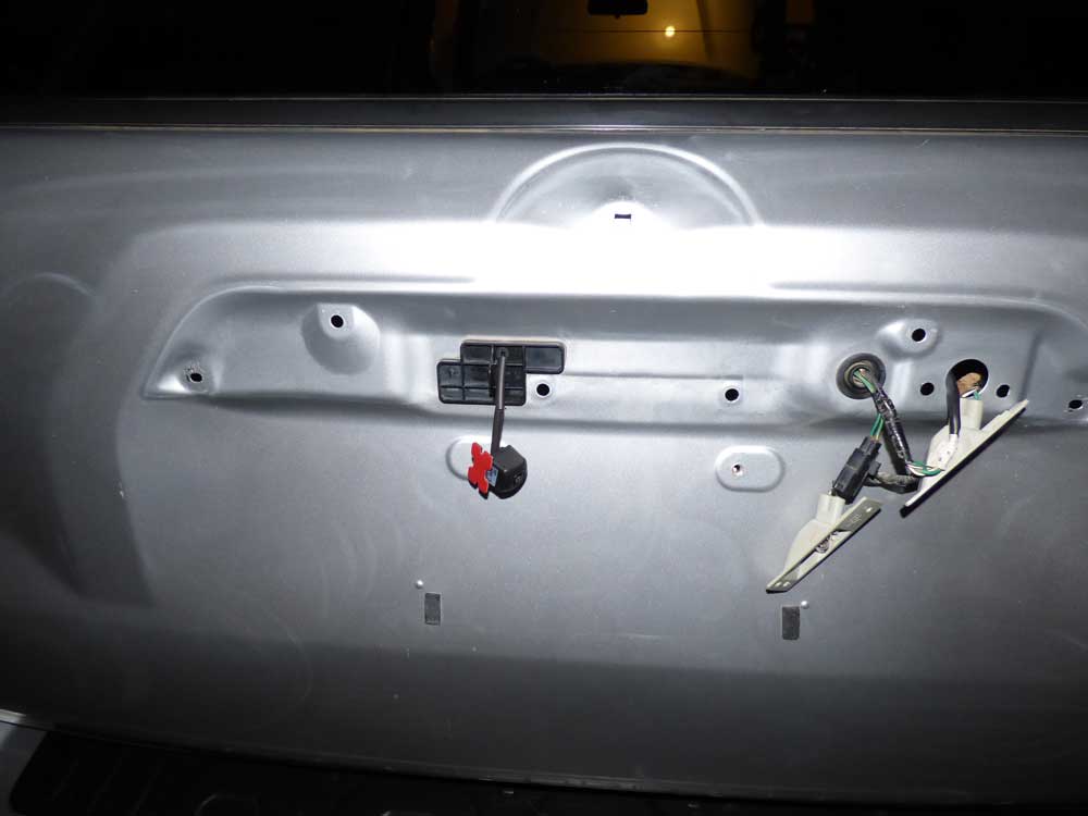

So I decided to work on the tailgate. Another 2 hours of cleaning.

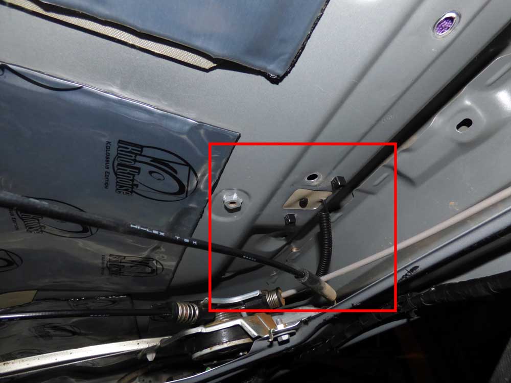

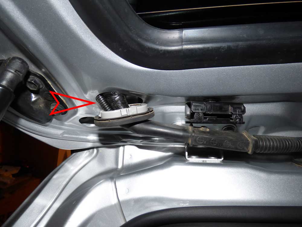

Decided to run the camera through the tailgate and into the Toy. Yea, that was fun... NOT.
Also notice the paint damage from the rear handle.
Oh, and trying to open the tailgate when you have no power is really fun. Getting that stupid little cover off to reach the latch is a real pain.

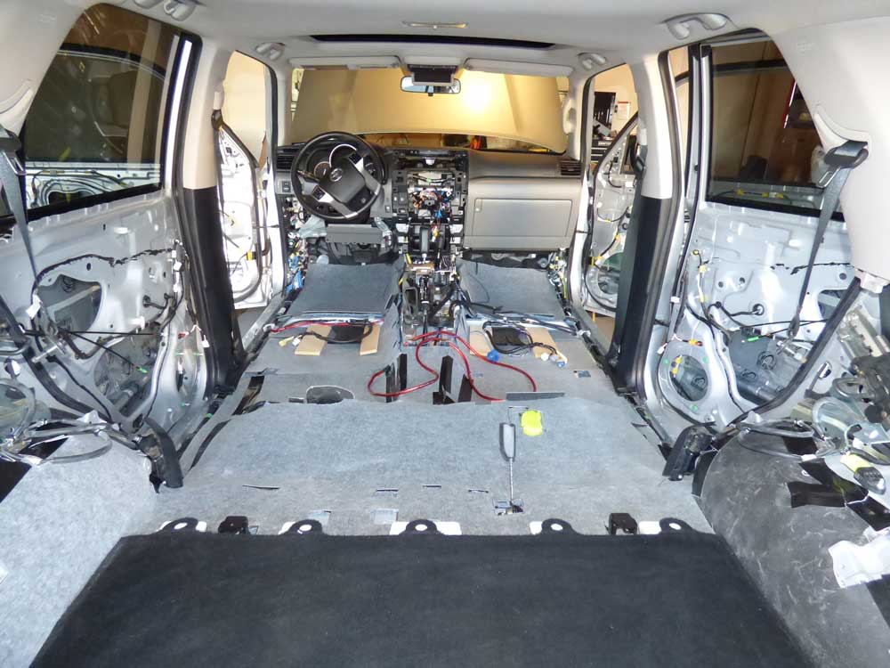

So it doesn't look like I have gotten very far and I sure don't feel like i have gotten very far. But I am making headway. All of the Radiant Barrier has been cut. All of the MLV has been cut. Stereo is hooked up and functioning, mostly. Need to program a few of the steering wheel controls. Front speakers are mounted.
MLV on flat surfaces (1lb per sq. ft.)

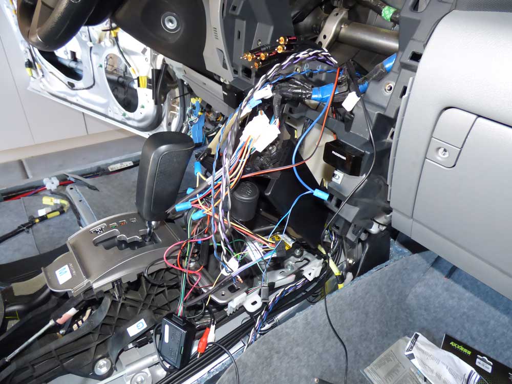

(Notice the simple 1 wire hook up )

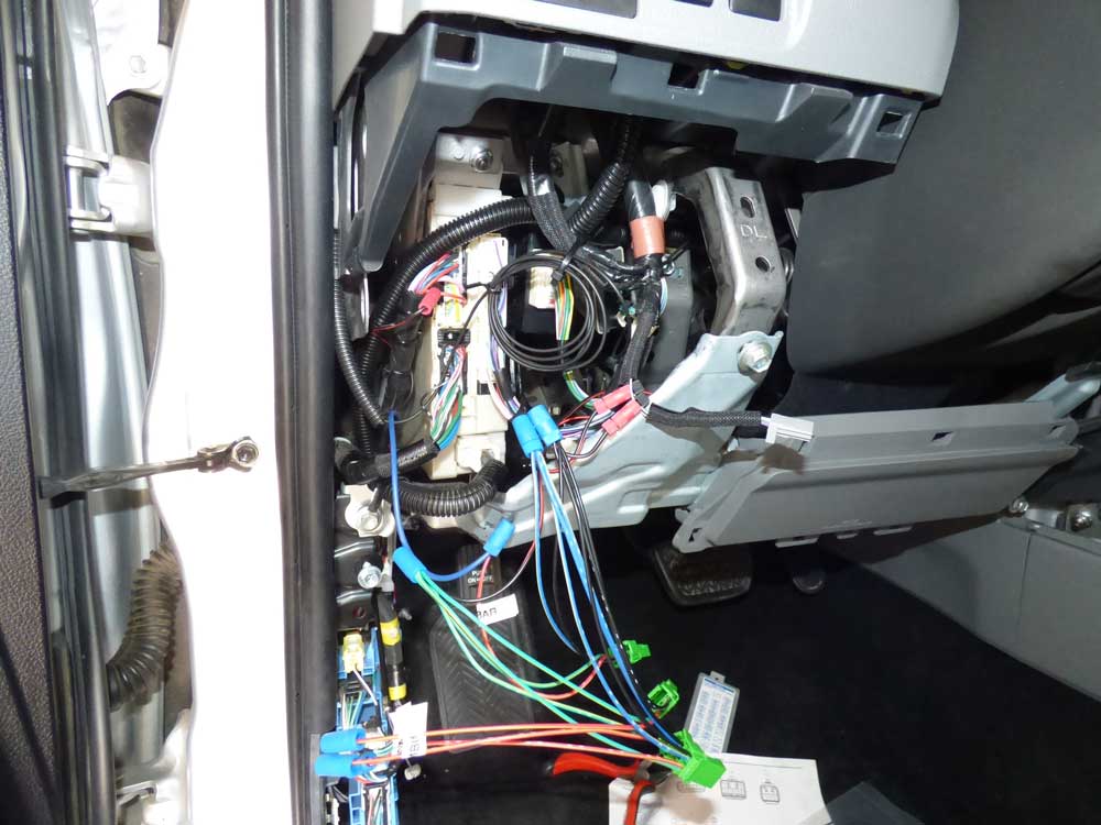

So cleaned up the rats nest a little. Not sure how all of this is supposed to fit behind the head unit but there is some room off to the right behind the glove box.
So the original plan was to rape the Honda for the stereo components for the Toy and put the smaller stuff in the Honda. Decided to hook up the new amp and see how it compared to the PDX series. I have to say I am very impressed. I didn't think this would be able to power the Boston's very well seeing as it is only 75 watts per channel and I am currently running them in the Honda bridged off of the PDX400.4 at 200 watts. I grabbed the Alpine 10" type R out of the Honda to test with this amp. In the Honda it is running off of the PDX 600.1. This little amp only puts out 350 at 2 ohms and has no problem running the sub. Will be interesting how it sounds with a smaller sub at 4 ohms and only 250 watts. For now, I will be running this in the Toy and not mess with ripping the amps out of the Honda.

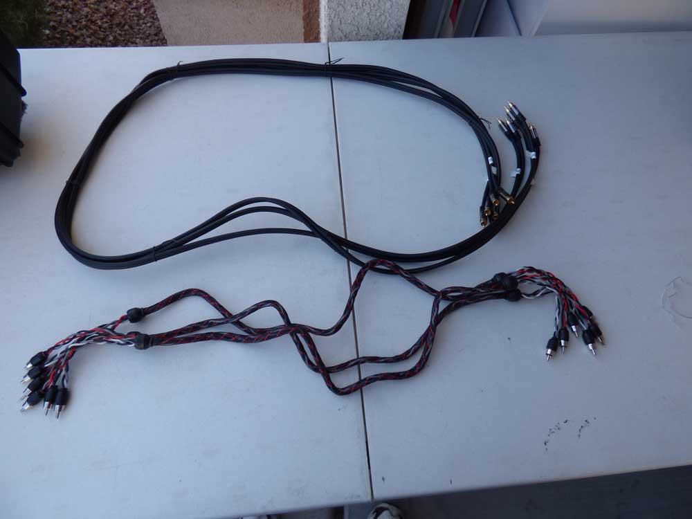

I have to order shorter RCA cables. The 6' are too long and even though these are a really nice set, they are just too thick to run in the car. I am replacing them with some V-12 Phantom Braid cables from T-Spec.
Testing out the mounts Crutchfield sent. They work for now. Will probably make something a little more solid at some point. I just need to get this thing back together soon.

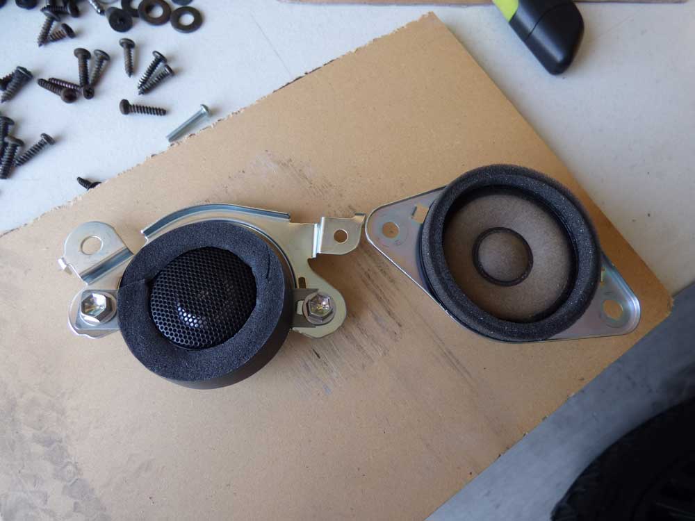

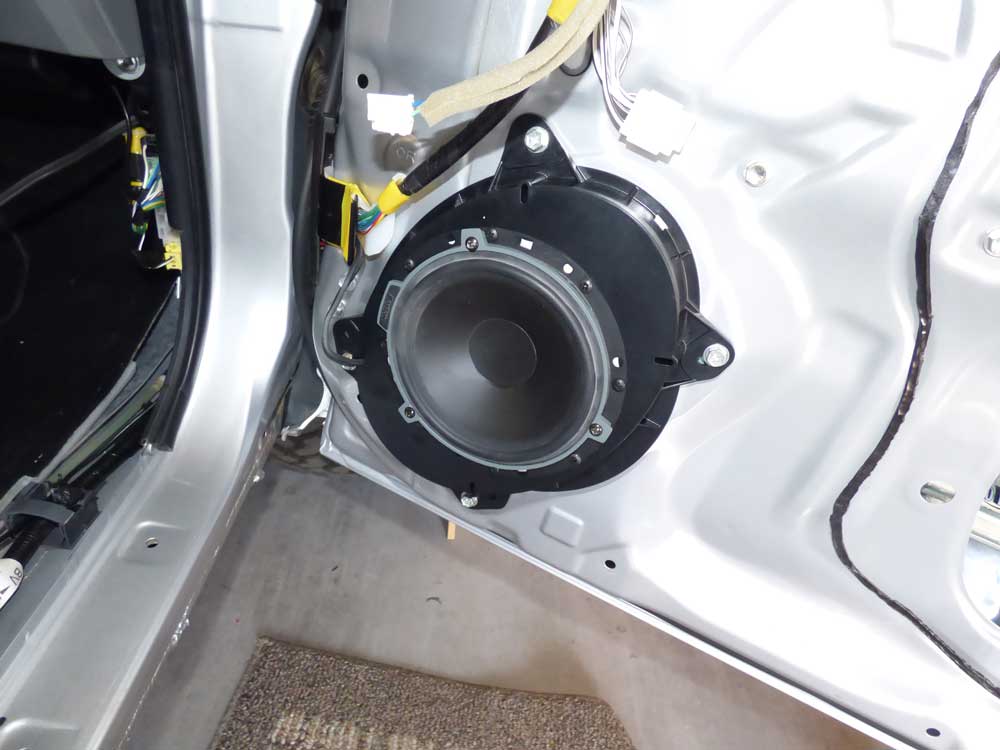

Got the Boston Pros mounted in the front. Still need to pull the other pair of Bostons from the Honda and install the Polks.

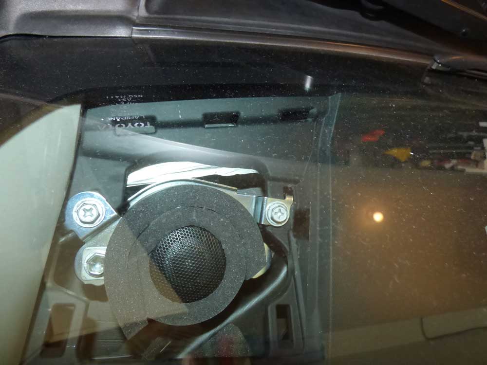

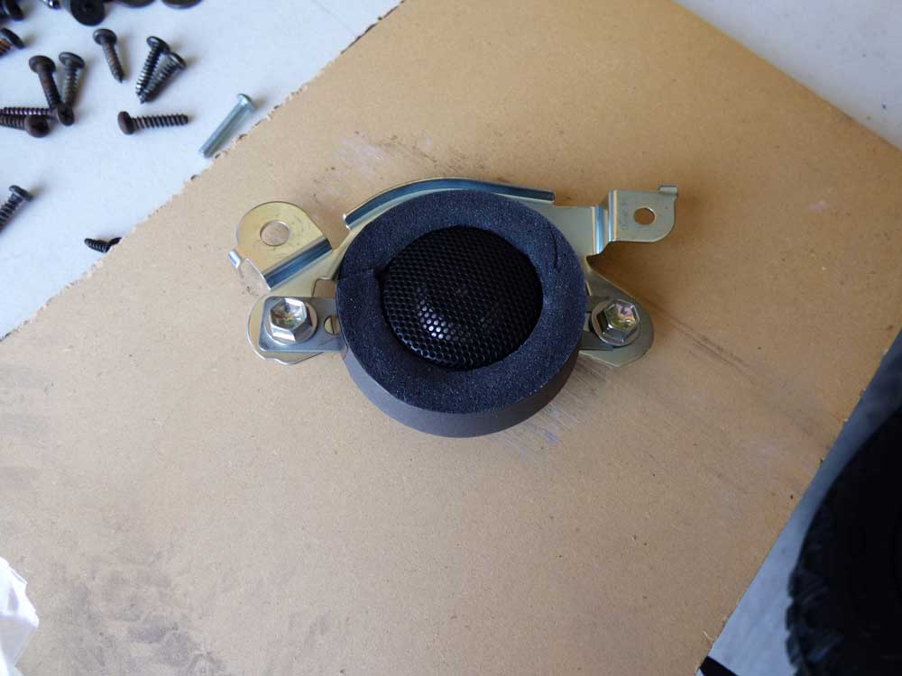

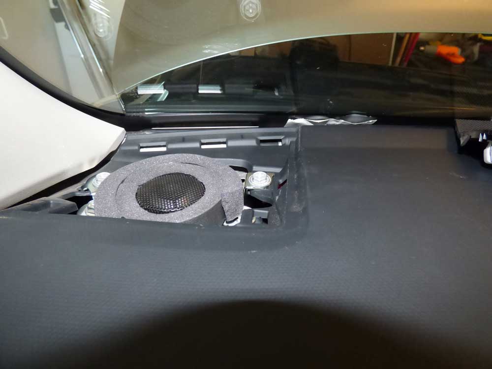

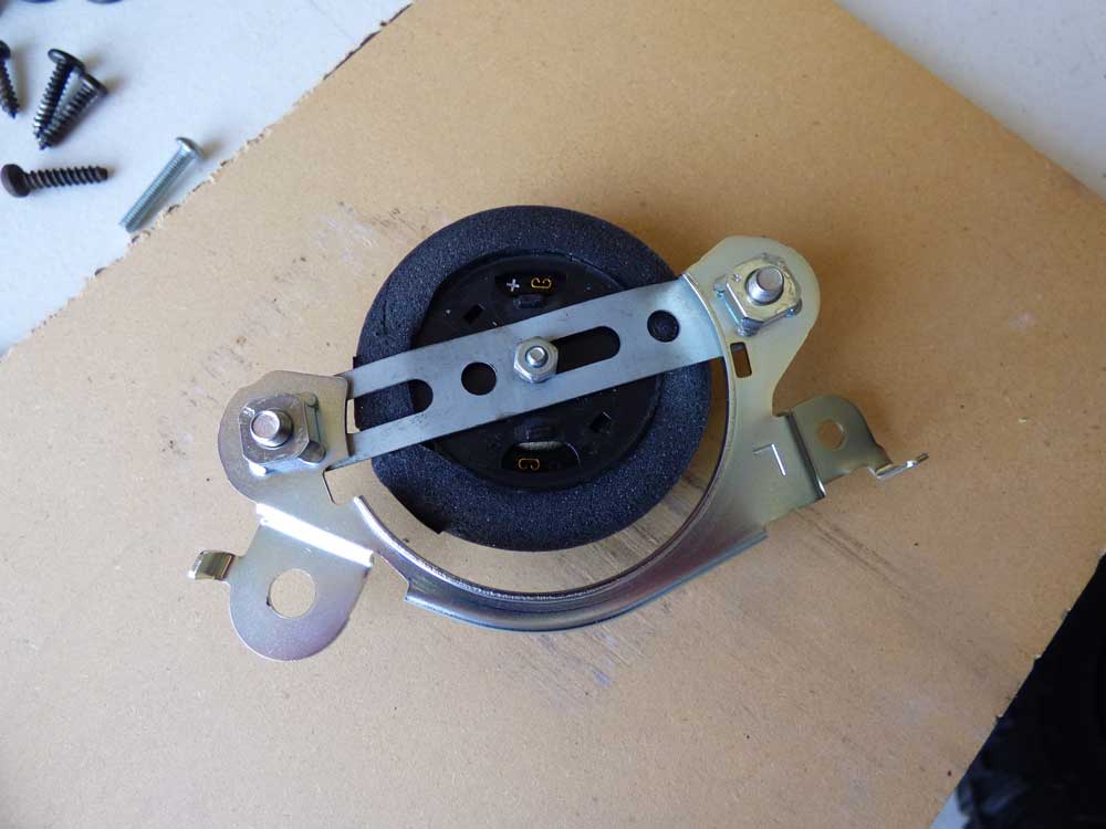

Had to get creative with the foam on the tweeter. Seems the stock speaker is offset a little.

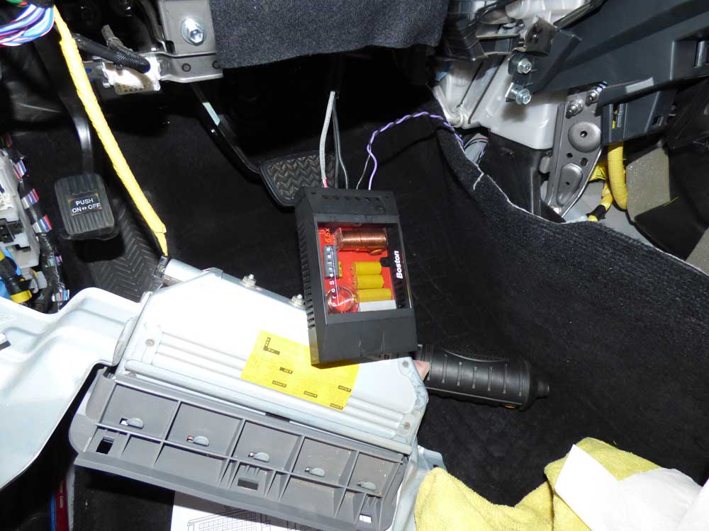

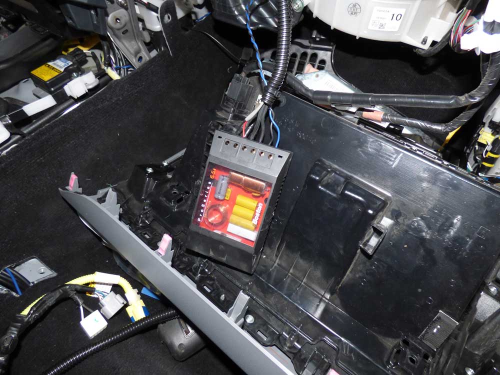

Crossovers were a pain. Should have bought all new wire, but no, I had to use what I could scrounge from old installs. Nothing matches. But it works.

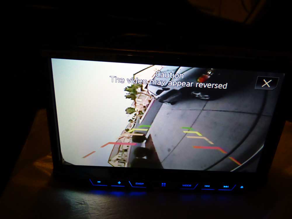

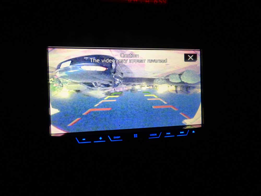

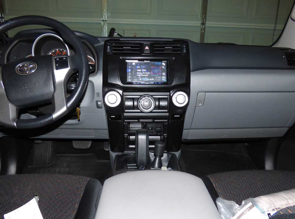

Tested the head unit out. Works pretty well. Got the reverse camera working (even though it looks like the Toy tipped over). Need to do some testing on the correct positioning of the camera.
My garage is fairly short and there are built in's along the walls so the Toy just fits. I have to use a towel on the tailgate when I open it as it hits the stucco on the house. What I didn't realize one day is that the camera had moved and was jammed sideways between the tailgate and the house. (I had the garnish off at the time) The mount was pressed against the paint and as I was in and out of the toy, it scratched all of the way through the paint to the metal. Always something.

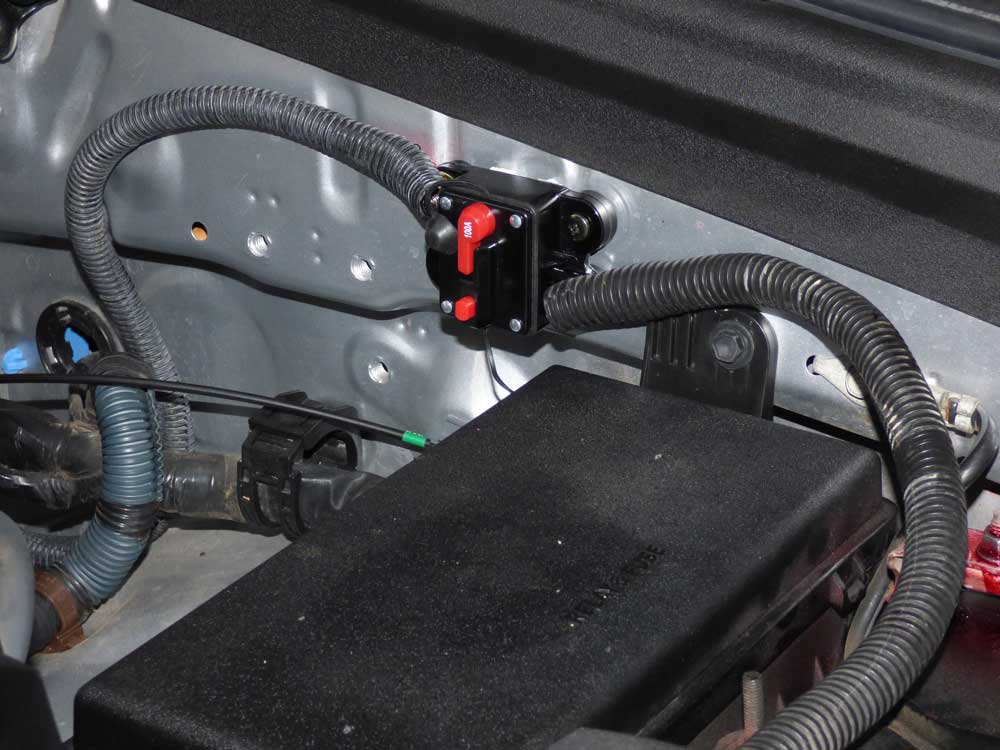

Got the power hooked up. Used a 100 amp breaker. Also, here is the location of the Reverse Sensing Wire on 5th gen in case someone needs a visual reference. (I really needed one)

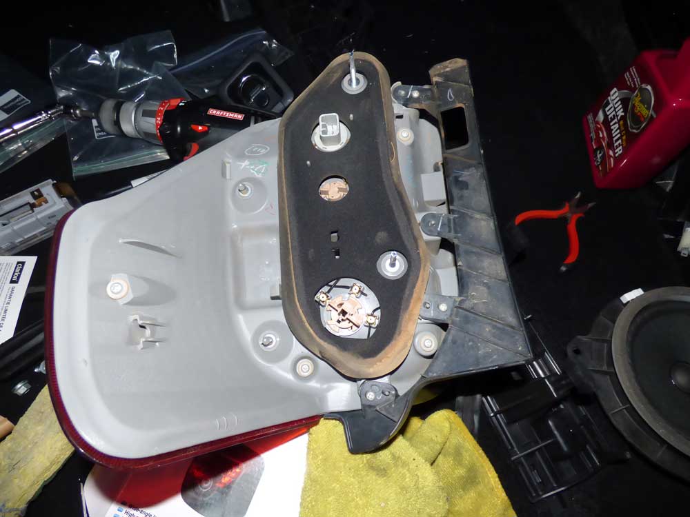

Once it got dark, I decided to pull the tail lights off and clean behind them. The red dirt is never ending on this beast.
It was another day from hell. Anything that can go wrong is going wrong. Got the radiant-barrier installed on the door, then installed the MVL. Could not get the door panel on. Pulled off every piece of the panel that I could but still couldn't make it work. Just too thick. So pulled it apart and went on the hunt for some thin Closed Cell Foam. After striking out at Home Depot, I found some flooring underlayment at Lowes. So all of the hours spent cutting and fitting the radiant barrier wasted.
Got all of the doors put together and finished up the hatch. The mailman delivered the new RCA cables. A little thinner, shorter and easier to work with. Only one problem, they are 6" too short. So off to Best Buy. They only have 3' or 17' in mobile audio RCA cables. So I pick up 3 sets of 4' RocketFish home theater cables. Right length but back to the really thick cables. Oh well, tired of messing with it. And now I have $80 in RCA cables that I can't use.
I decide that I don't want to use the crappy plastic supports that come with the faceplate, so just bolt the metal ones back on. Unfortunately the stereo won't line up with the face plate. It's a little to high and too far forward. So I try the plastic ones and there is just no easy way to make them work and trying to program the steering wheel interface. And they are just too flimsy. So I spend the next two hours fitting and adjusting and drilling holes in the metal brackets and finally get everything to line up. So I hook up all of the wires, jam everything behind the head unit and fire it up. Sound is pretty good. Steering wheel buttons all work except for the voice activation, which I knew wouldn't. Then I press on the brake to move into reverse and the stereo goes out. I let off the brake and then it comes back on. I try it again, same thing. Crap, where's the short. No short, battery is dead. Throw the charger on and try again. Stereo stays on this time, but now we have a new problem. The text on the display for the camera is wrong. It should say image may be inverted because the idiot installer put it in upside down. GRRRRRRRR. I don't think there is enough cable to flip it over so will probably have to pull the hatch apart to get a couple inches of play. And for some reason, the head unit doesn't dim with the lights. One more thing to troubleshoot.

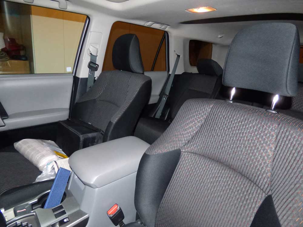

Started putting the rest of the interior back in. That radiant barrier makes it a real bear to fit the panels in. And not everything fits right. The separator piece between the back seat and rear carpet won't lay flat. And I can't put the feet covers back on the seats. Will have to see if I can live with the little issues.
Still need to finish balancing the levels on the amp and programming the steering wheel control then I can put the passenger seat back in and finish the dash. Everything will be wrapped up by Monday.
Still need to pick out speakers for the rear and hatch. Thought the stock ones would do for now but they just sound so flat.

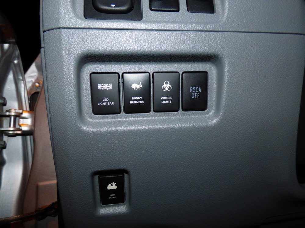

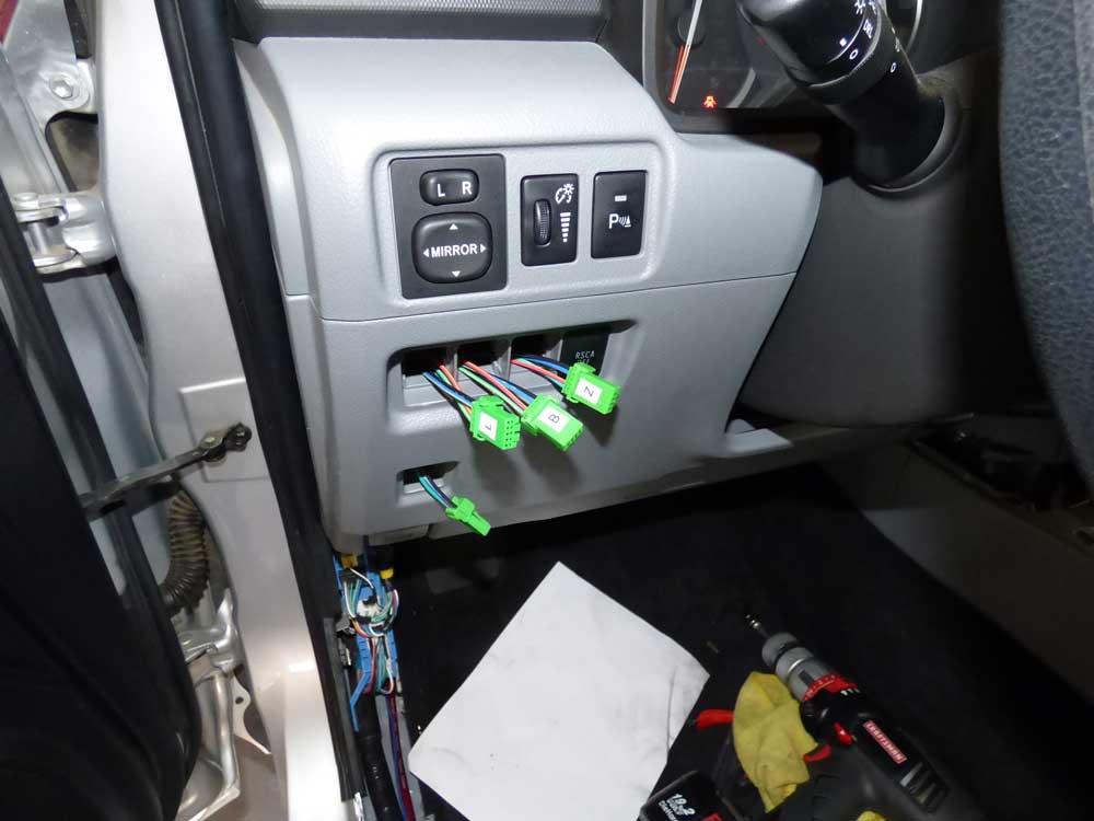

Got the switches installed. Now to get some lights and compressor to hook them up to.

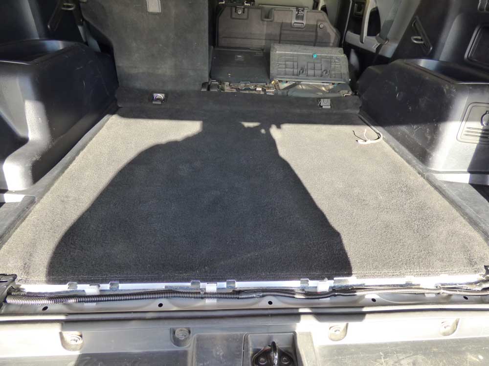

Took it for a drive today just to put on some miles to settle the suspension. It is really quiet at low speeds. But once I hit highway speeds, it is really quiet from the windows down, but sounds like a jet engine above me. That roof rack and light bar are crazy loud. Not sure what to do there. Really like the way it looks, but may have to scrap that part of the project. Will try to create a new fairing and see if that helps, but not counting on it.

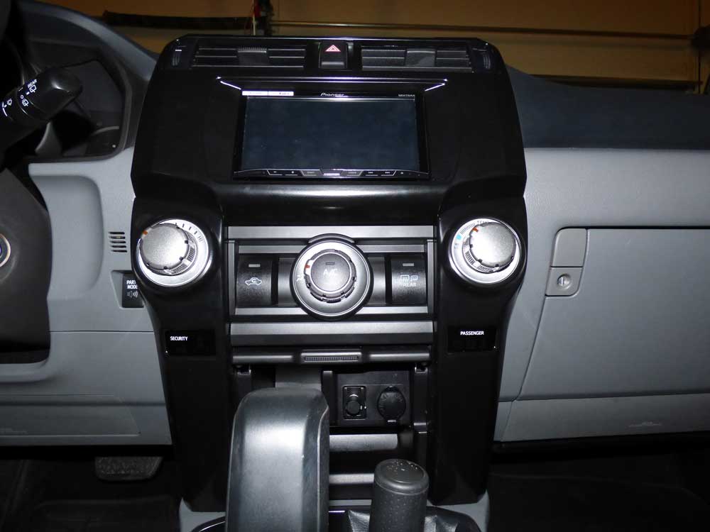

Got it wrapped up today. (4/12/15) Happy to be done with this project for now. Still more to do later.

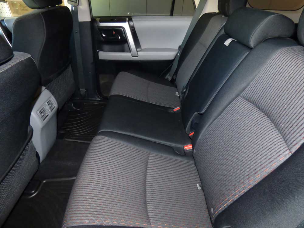

Proof that I got the interior back together (mostly)

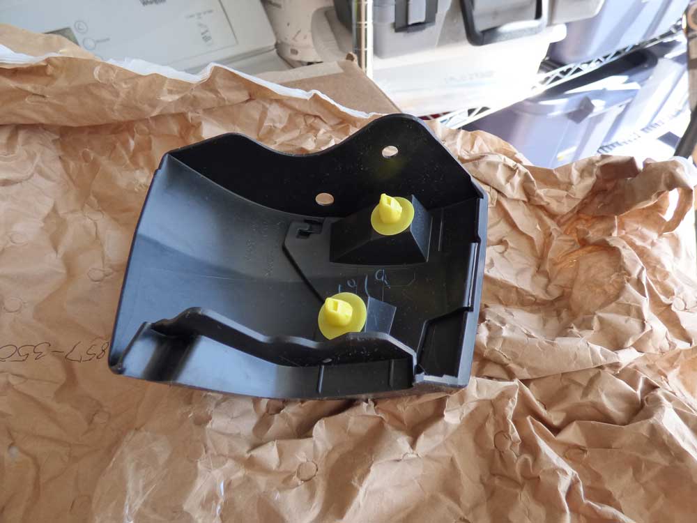

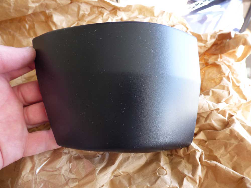

I decided to paint the trim black. I like it better than the silver but not sure I love it. May wrap it with some vinyl and try some different looks. For now, it is more than functional.

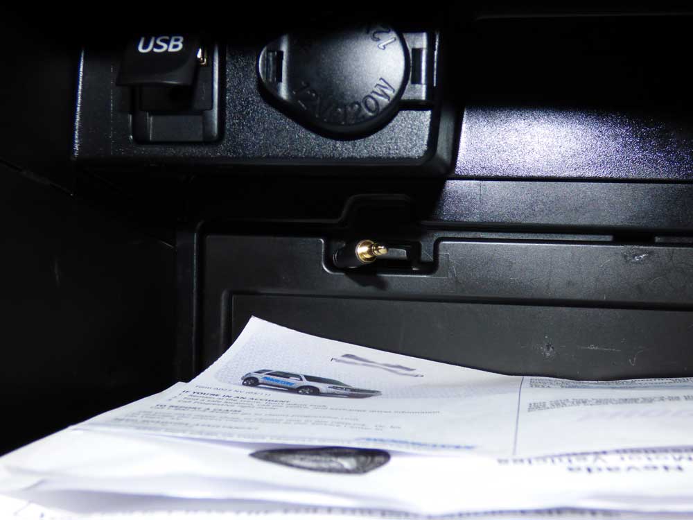

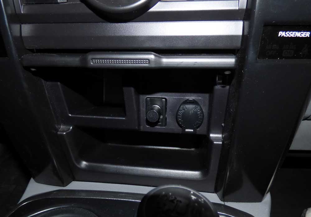

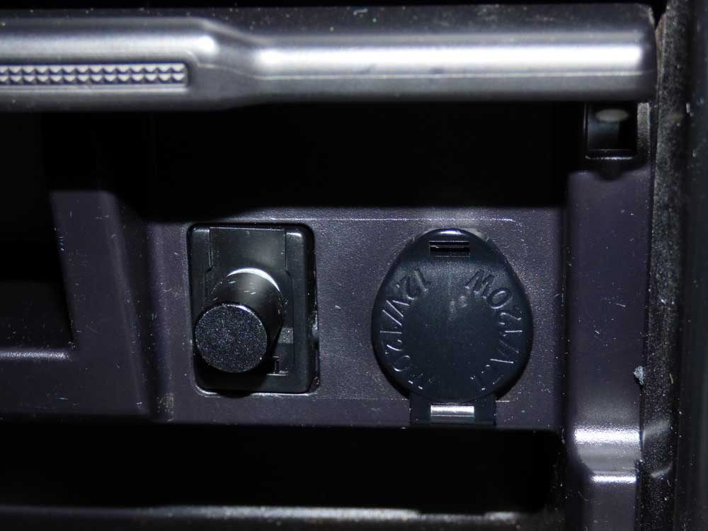

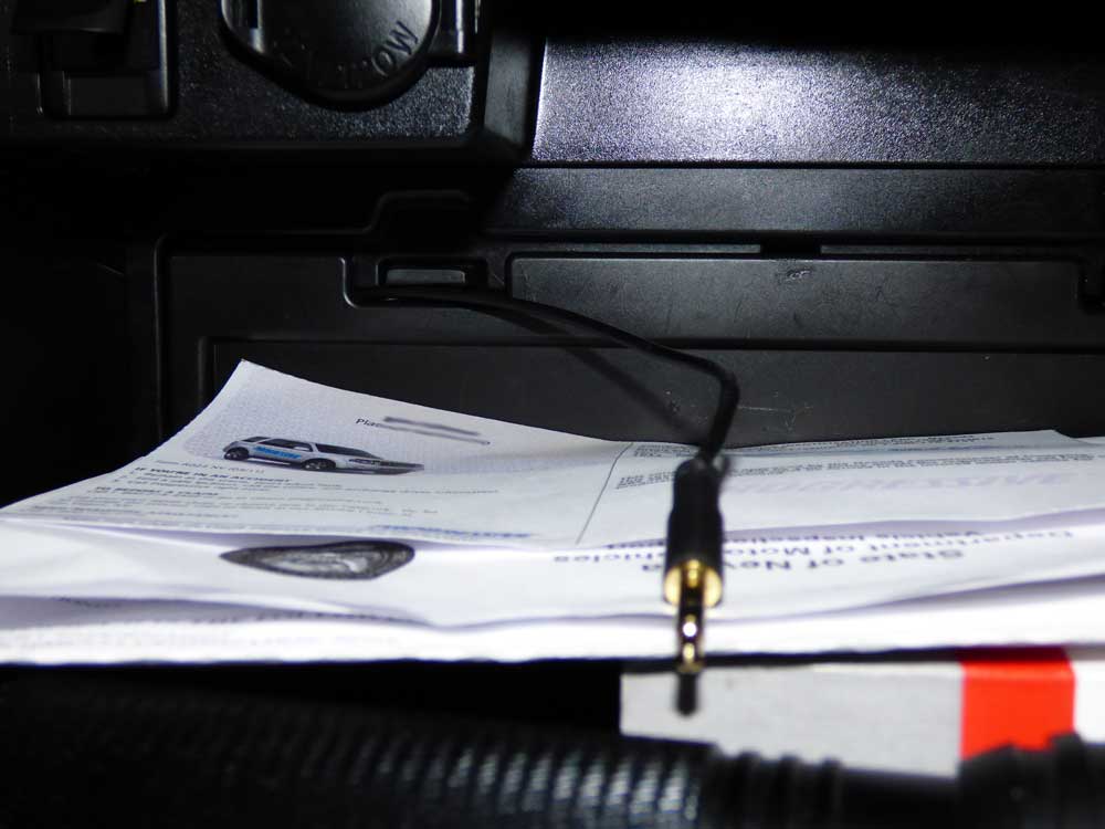

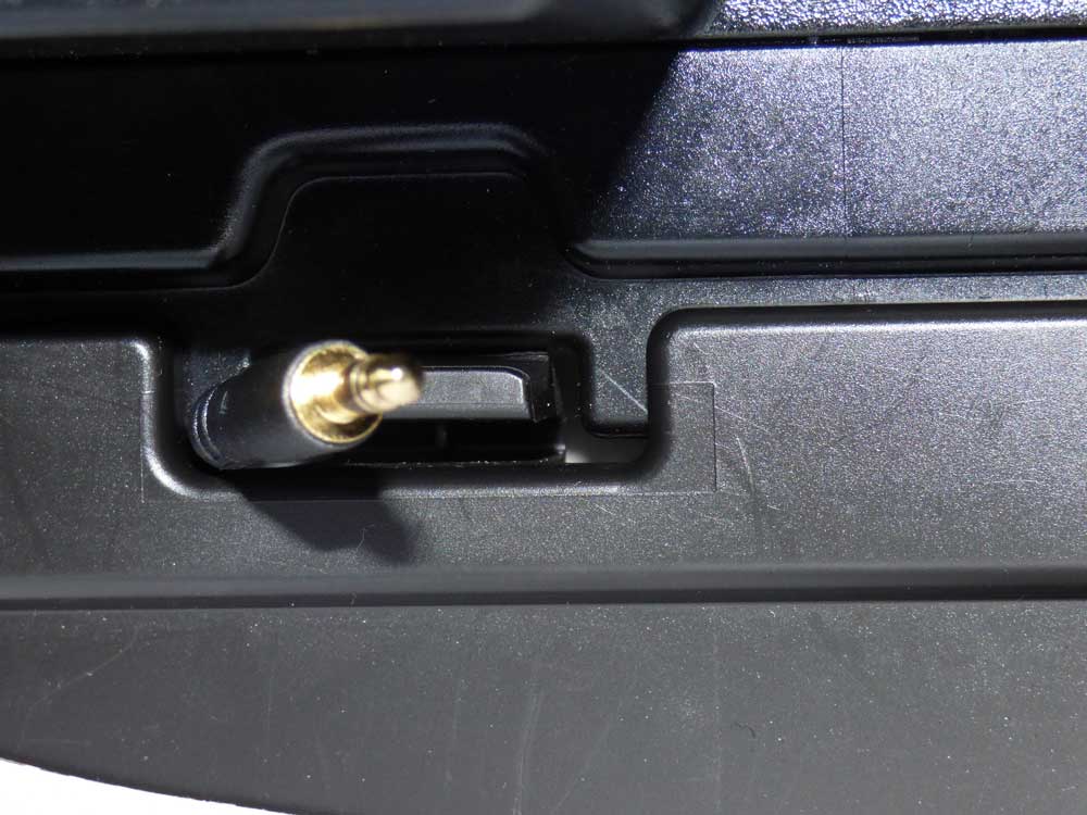

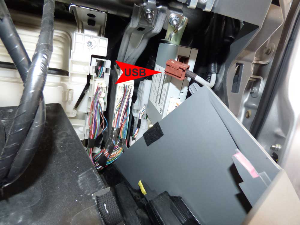

In the process of the swap, I lost the aux input below the stereo. Didn't want to pay the $15 for the adapter for something I may never use. I needed a place for the sub control and that looked like a good area. It took a lot of patience and some detailed trimming but was able to pull the circuit board and knob out of the control box and mount it into the aux input panel. I kind of like it there.
But since I didn't completely want to lose the possibility of using the Aux in, I found a very thin 1.5' cable on Amazon. I was able to route it behind the glove box and there is enough room around the cabin filter access door clip for it to slide through. It's out of the way, but still easy to get to. And no trimming required.

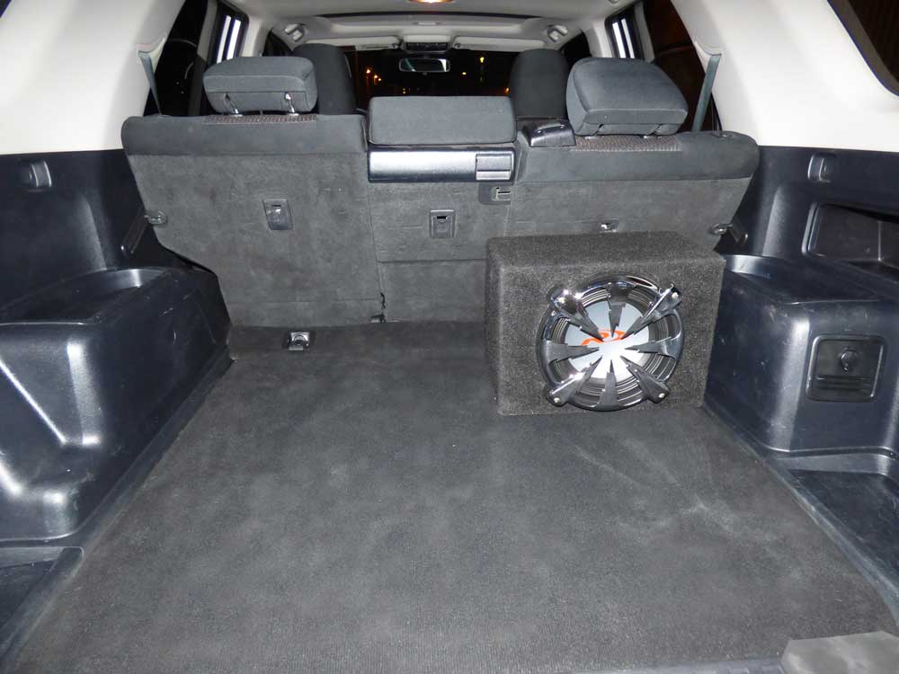

The sub is a 10" Alpine Type R DVC in a sealed box.

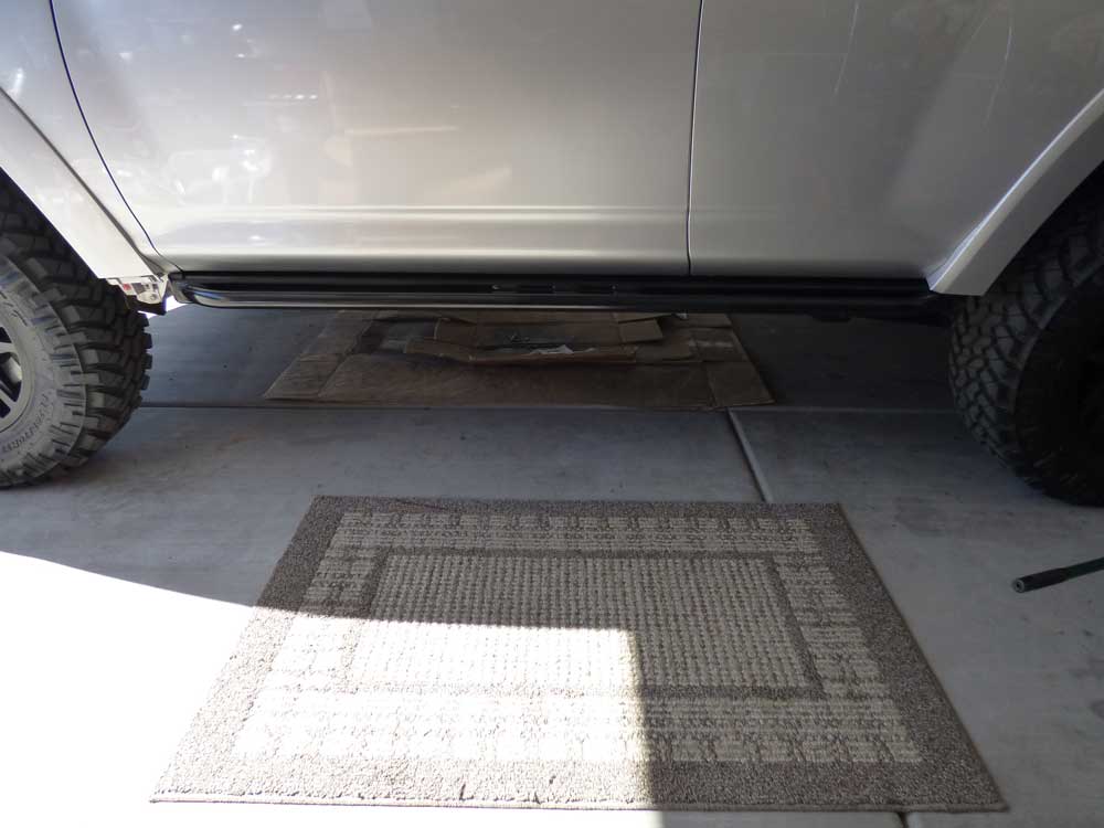

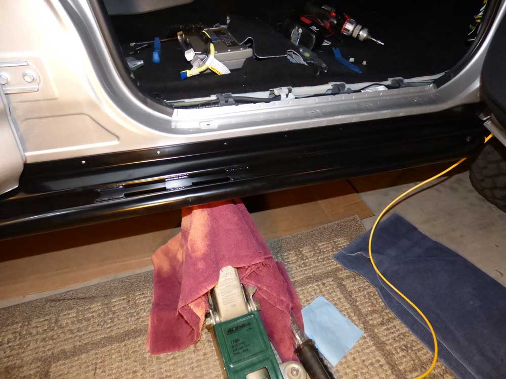

Sleekster Sliders

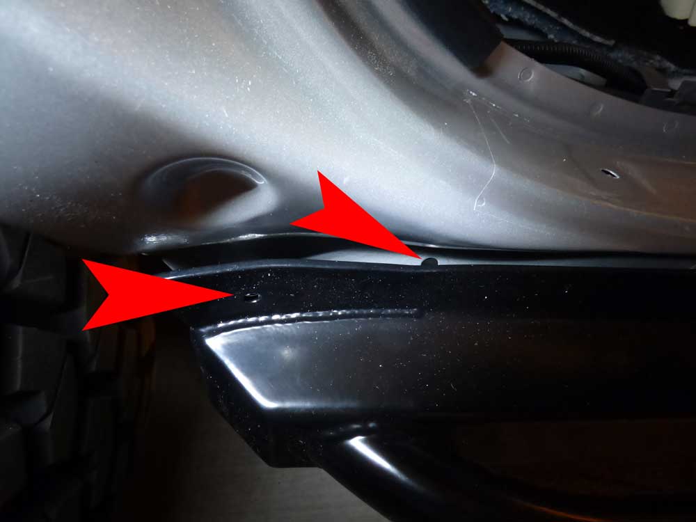

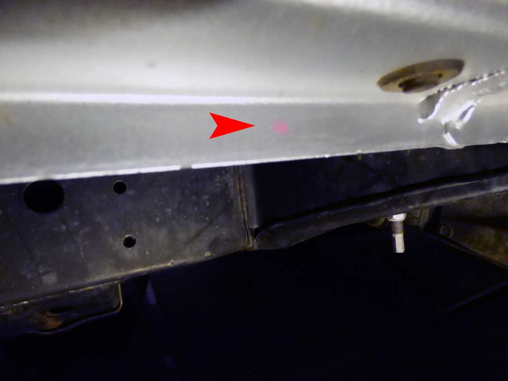

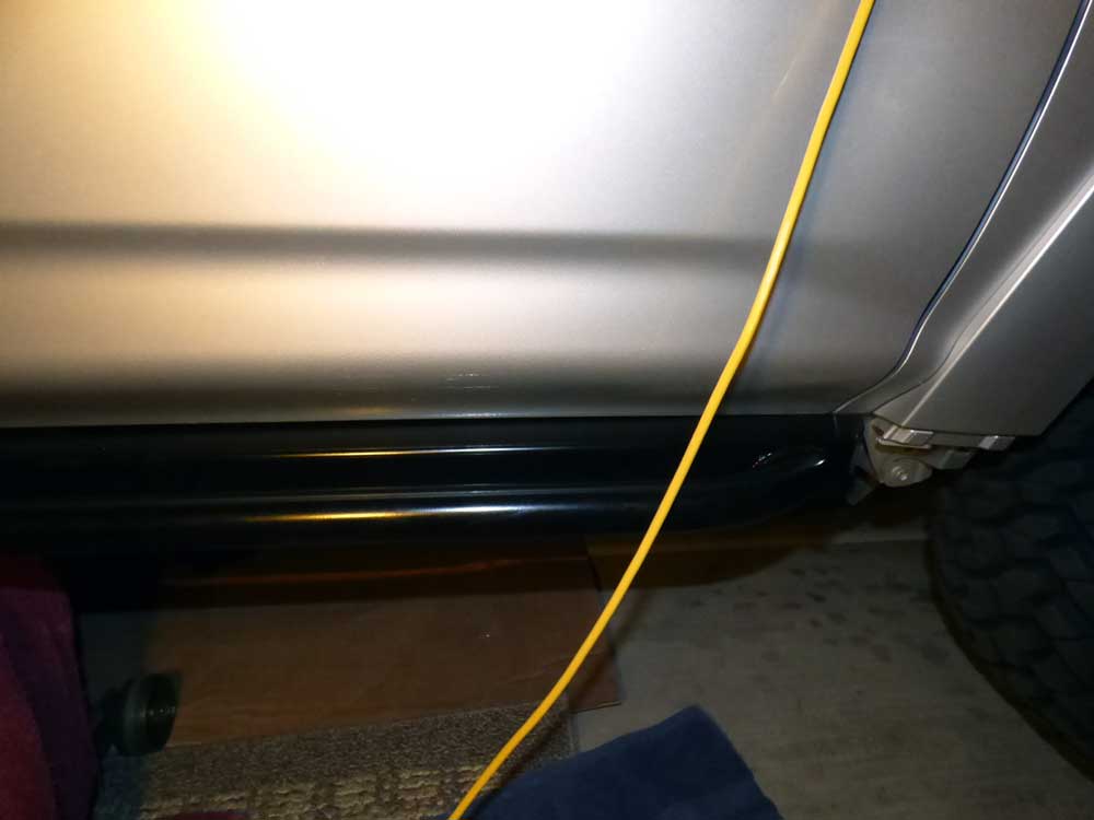

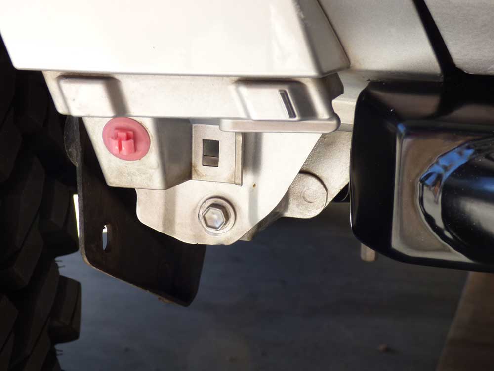

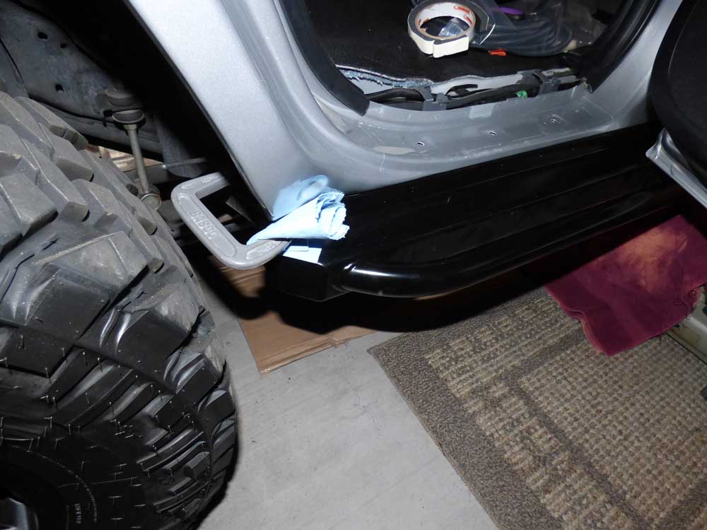

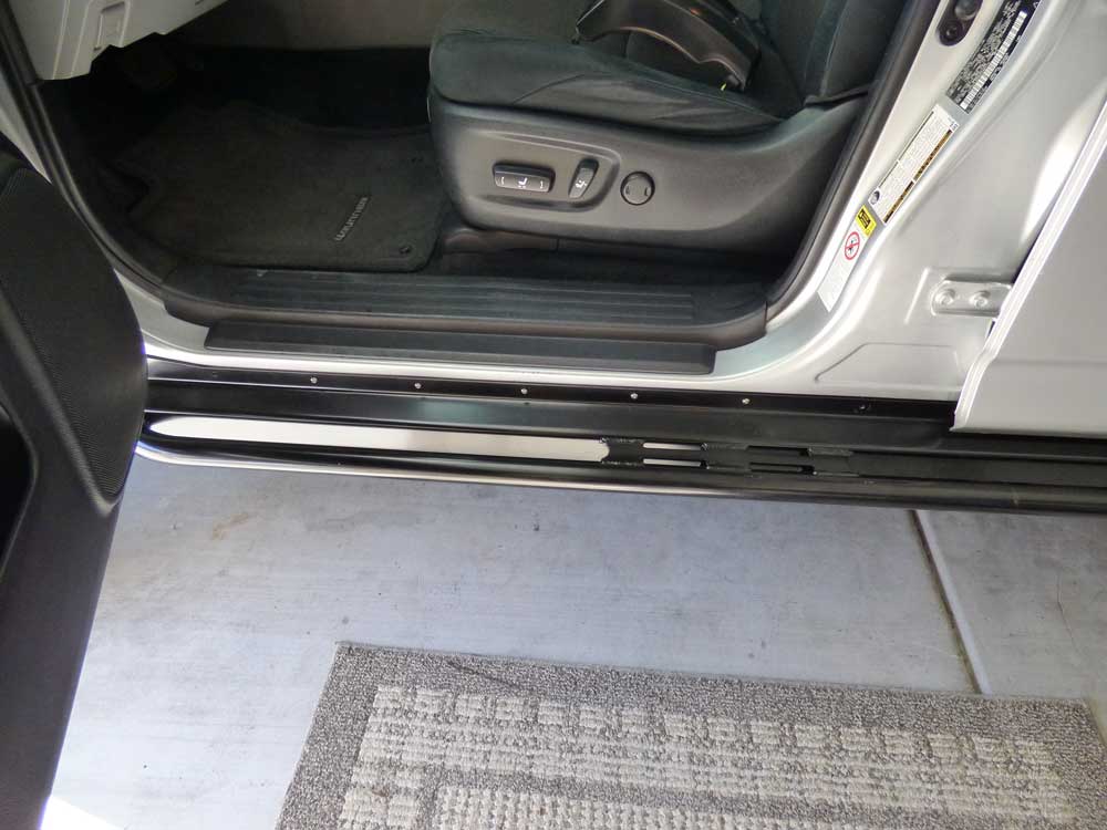

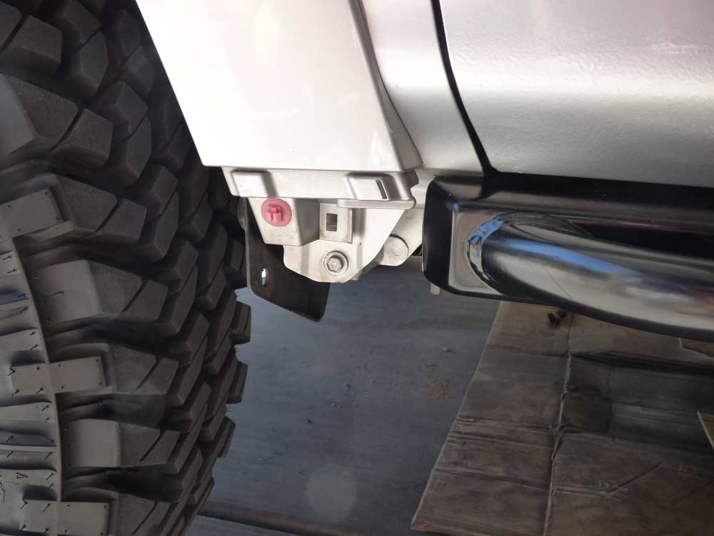

I finally picked out some sliders and got them installed. I chose the Sleekster sliders from RED as I have used this style of slider before on my Jeep, and I like that they tucked up tight and didn't require cutting the rocker panel (it is completely removed) or any type of filler panel (except for two end caps that Toyota charged $30 apiece for)

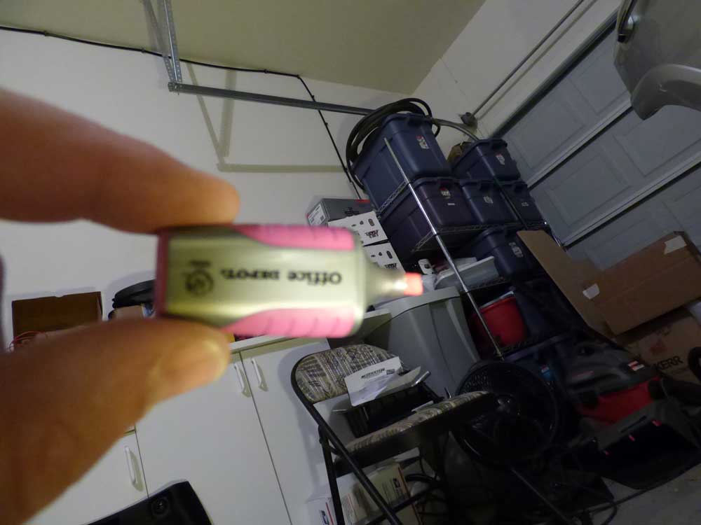

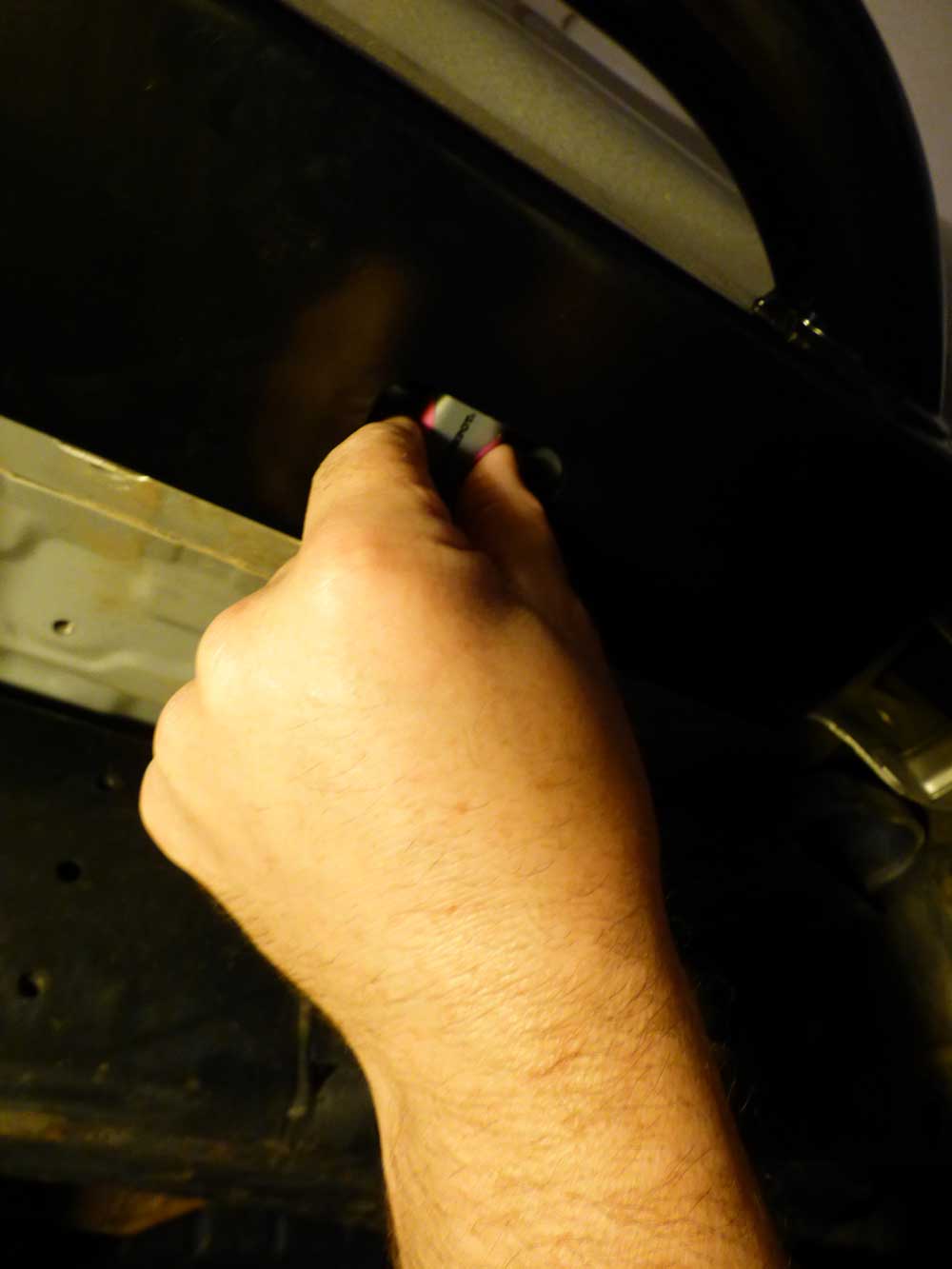

Following the advice on one of the threads I decided to use Rivet Nuts instead of rivets to mount the upper part. Although it may allow me to remove them later for cleaning, it made it almost impossible to install them in the perfect spots. Because the holes don't necessarily line up with flat sheet metal, there are a couple that end up on the slope of contoured metal. The end result is that there were a few of the upper holes without bolts in them. As these are not really for structural support, I think I will be OK.

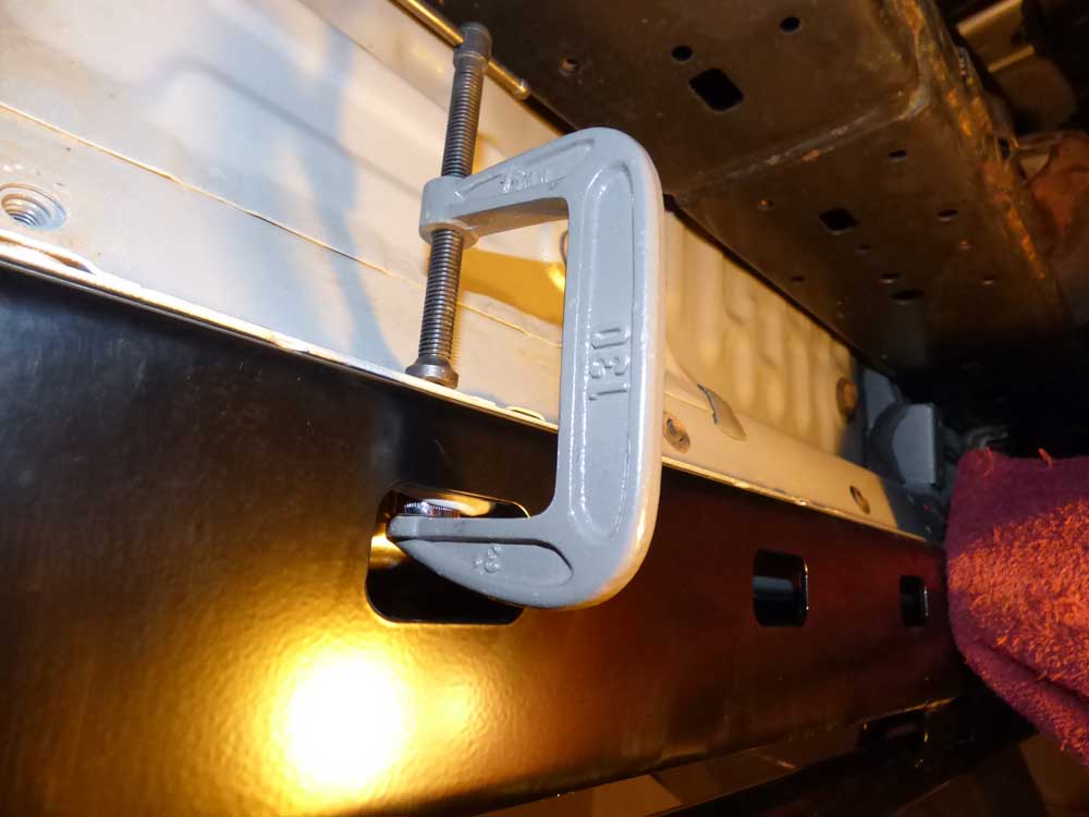

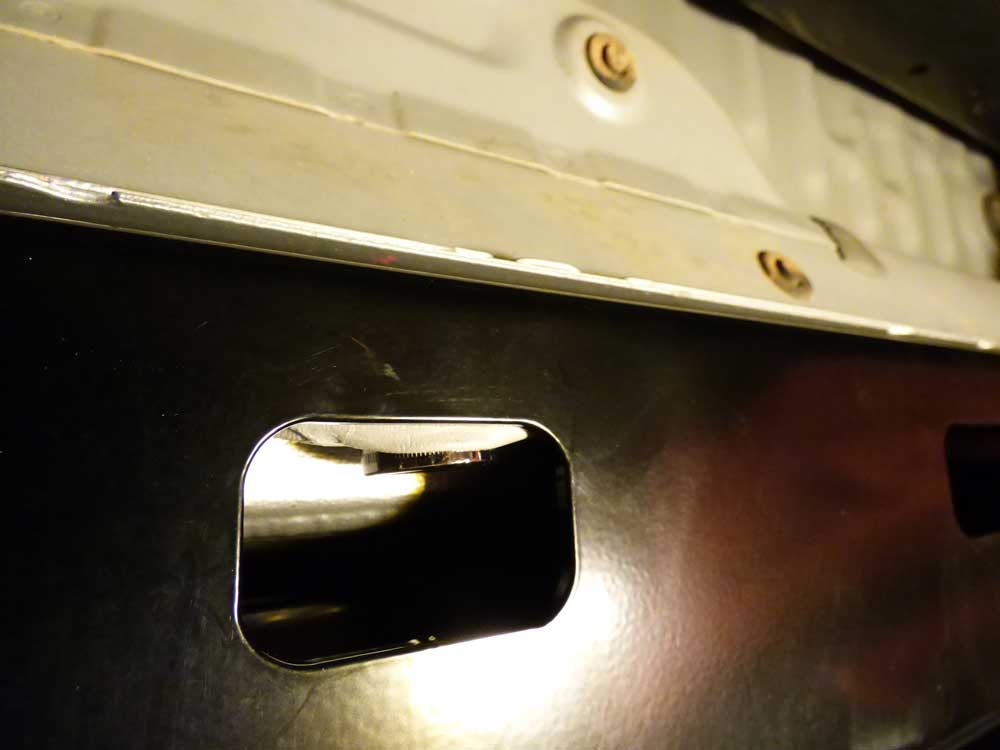

Install requires marking holes on the pinch seam through small windows on the bottom of the sliders. There is very little room to work with and if you hands are any bigger the a 4 year olds, you will have trouble.
I found a small highlighter that I had that worked pretty well. Other than a few holes not lining up correctly, the install went pretty well.
The instructions say that the rear upper hole lines up with a hole that the rocker panel uses. This is not the case on an SR5. You have to drill out that hole as well. I believe they will be updating their instructions to clarify this.
You have to clamp the slider to the body while you mark it. Since my clamp wouldn't reach the body through the little window, I used a socket with some duct tape on it (to keep it from rolling down the slider)

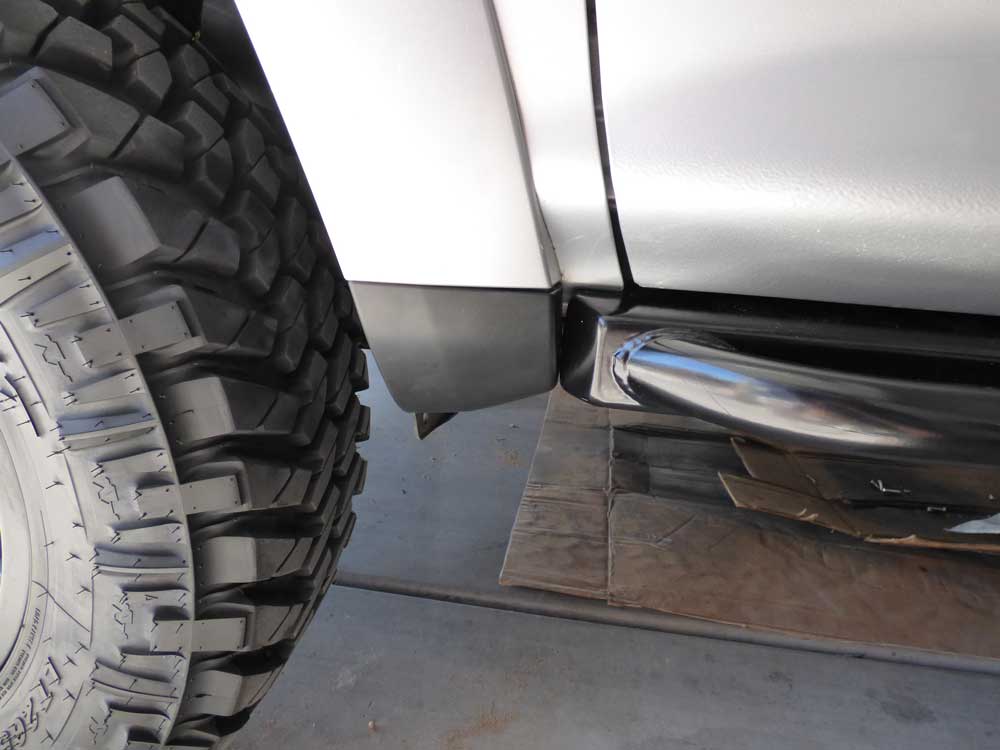

Can't say I am pleased with the fit of the end cap. No matter how hard I tried, I could not get the slider side to fit completely flush. Not positive why it won't snap into place. It's not going to fall off as it is screwed in from the front as well as clipped. (the image shows two clips. On the SR5 only one fits. The other may fit on the 2014 and up which is what these are for)
Overall I really like the looks of these. They are not really functional as a step up since they are nearly at the door sill height. There is just enough room to get a couple of toes on to reach the roof, but it's a little awkward.
Was informed there is a way to fix the end caps. I have yet to do it, but will someday.

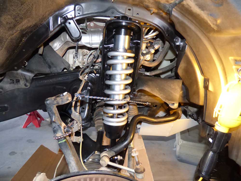

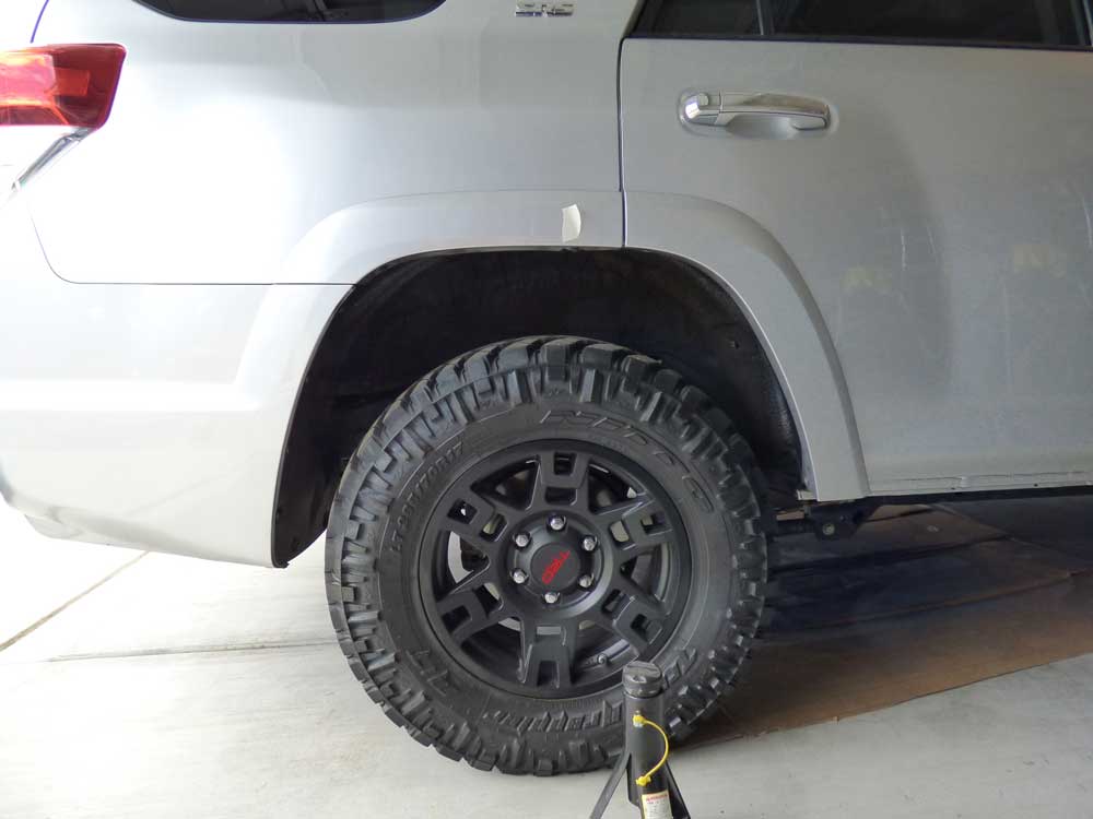

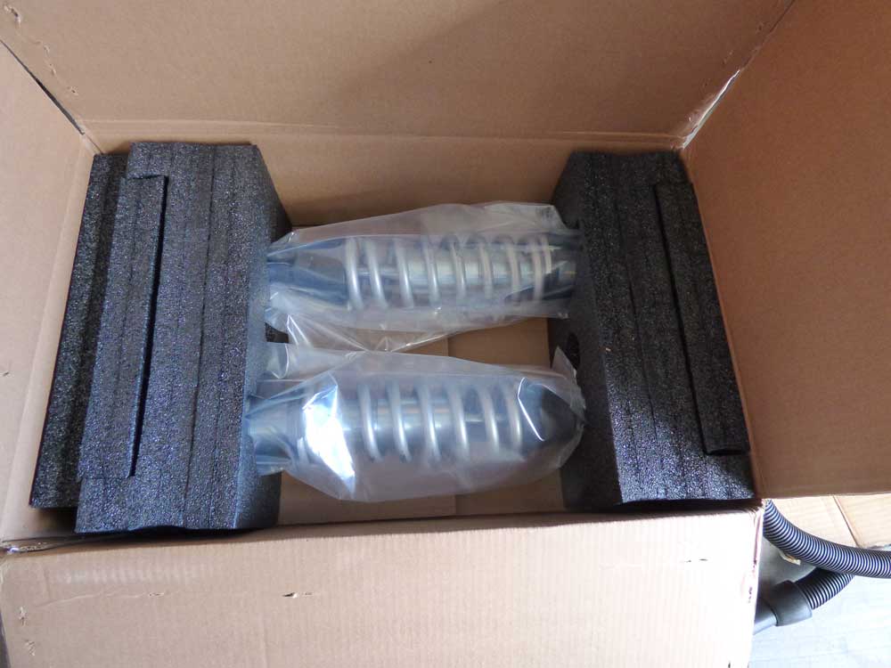

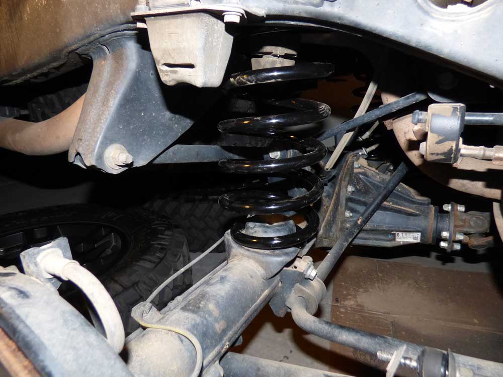

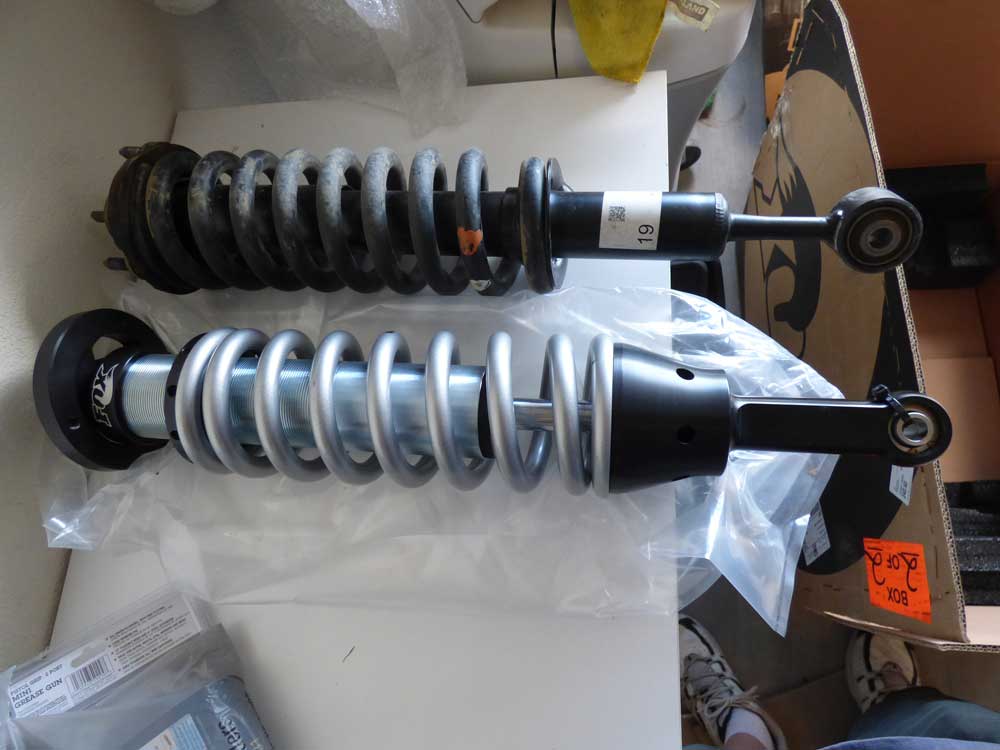

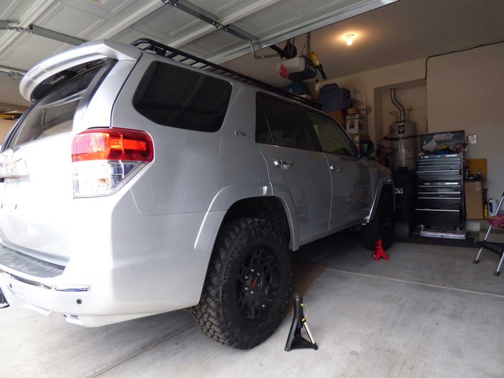

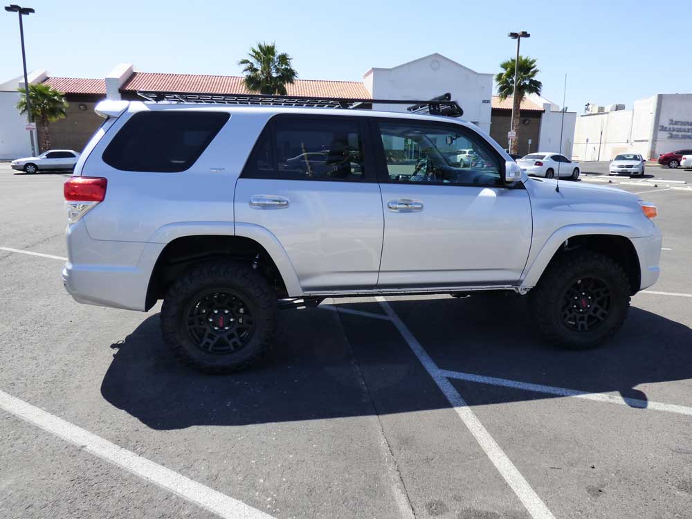

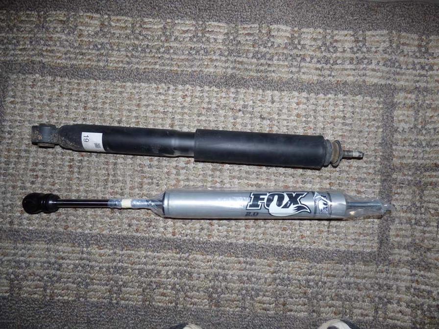

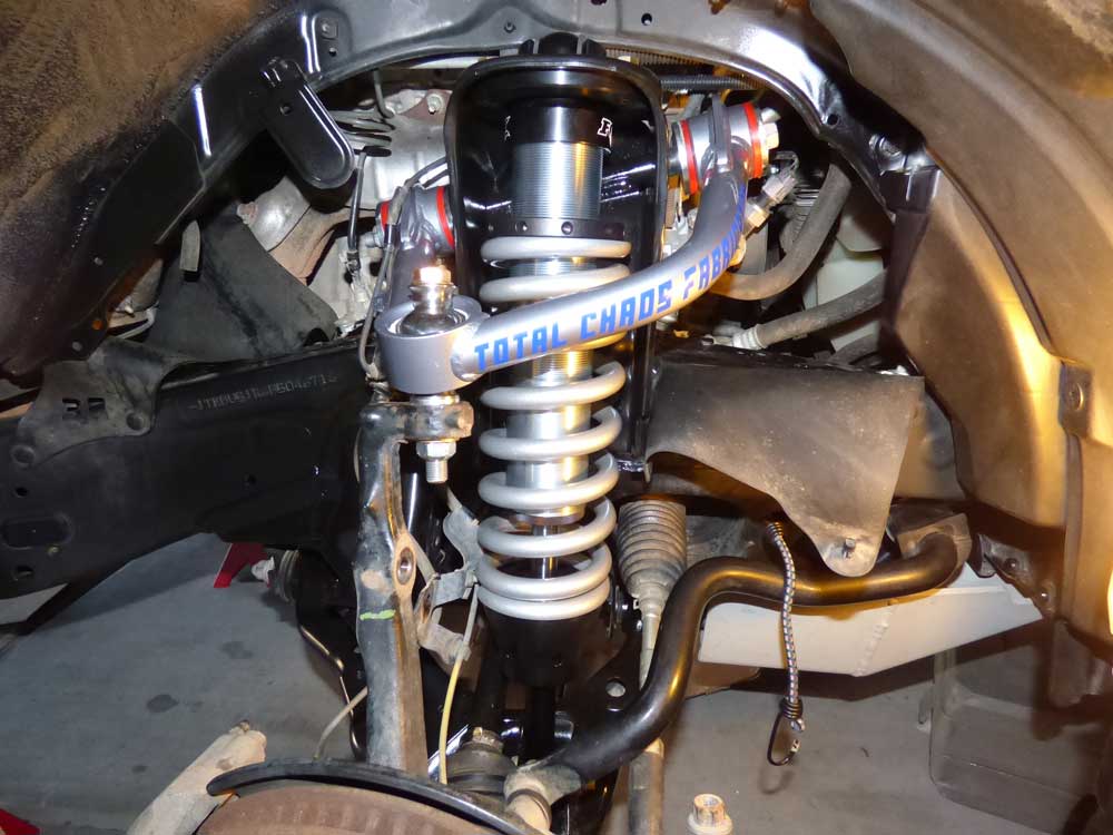

So after making a few offers on lifts in the classifieds, I ended up ordering some Fox 2.5 Factory Series Coil-overs and Fox 2.0 rear shocks. Picked up some Superflex rear coils and Total Chaos UCAs.
Did a 25 hour install marathon. (2 hours cleaning for every 30 min of wrenching)
Took breaks to get new jack stands, longer bolts for the front skid, meals and a run to Walmart for butterfly closures for the gash in my head.
Found out my jack stands were too short. One set worked on the cross member, but the other was 4 inches too short, so picked up some 4 ton that would reach. But the old shorter ones I used, nearly failed on me and I was within a few yanks on the wrench from being crushed under the engine bay. Guess I will be replacing those as well.
Install went pretty well. Took longer as I was working all night so kept having to open and close the garage door to get around the vehicle. (I really hate those built in cabinets.) That slowed me down a lot.
Fox was kind enough to not include a spanner wrench with the coil overs. Went to 4-wheel parts to pick one up. They don't stock them. 3 - 5 days to order one. I need it by Monday. Leaving Tuesday. Only one other place in town that might carry them, Nevada Off-road and Buggy to the rescue. They have them in stock and actually have the steel ones so didn't have to lay out $50 for an aluminum one that I would probably break.
It rides much better. Not nearly as floppy as the stock setup was.

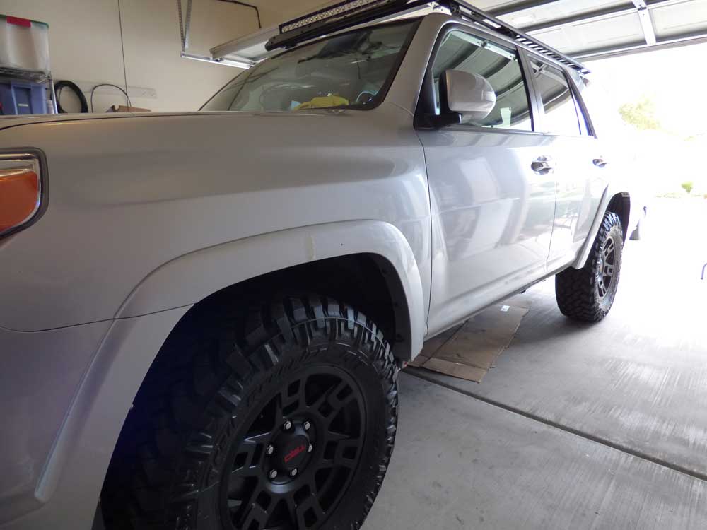

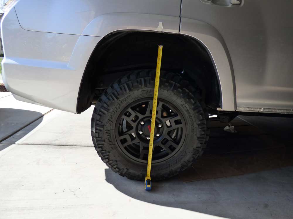

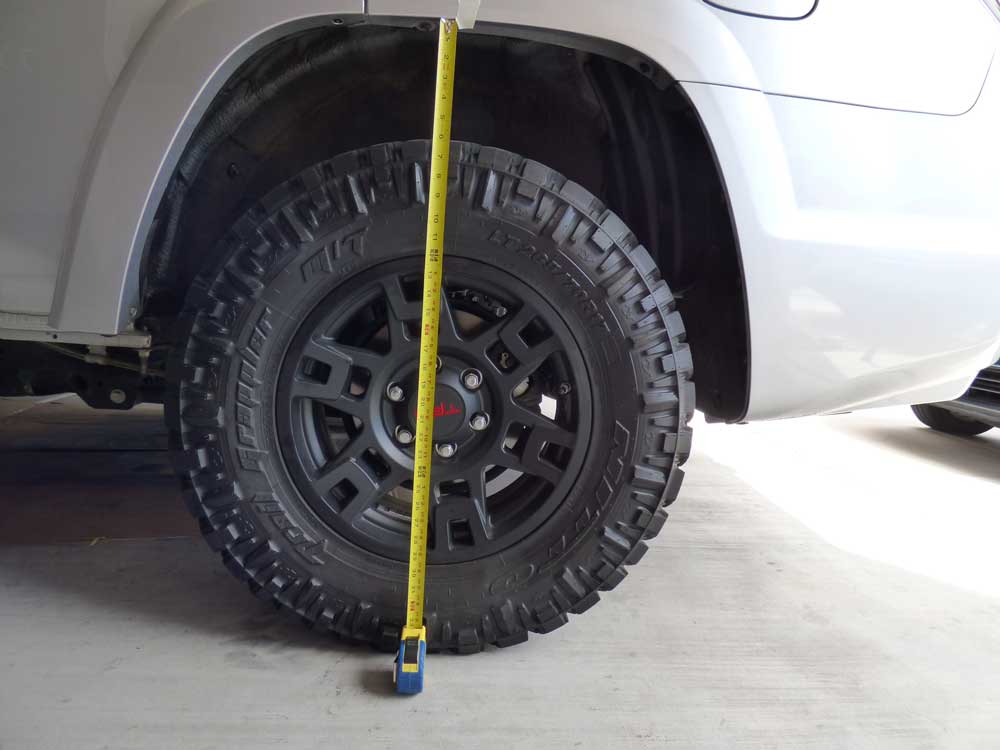

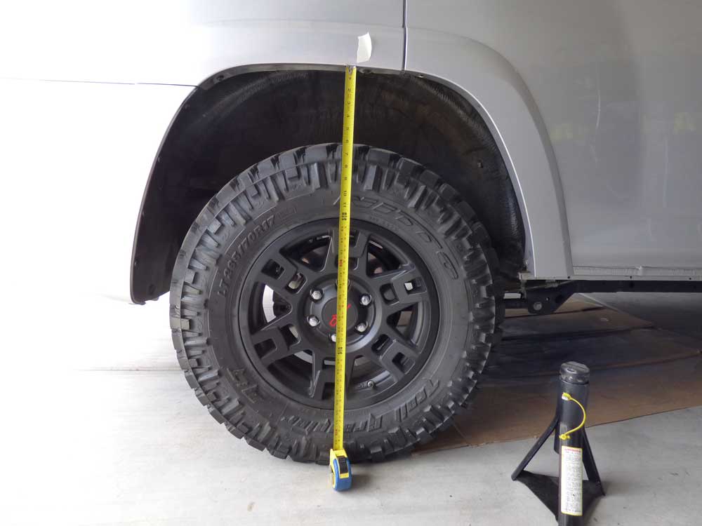

Before and after pics

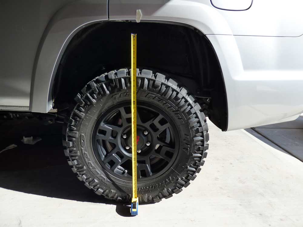

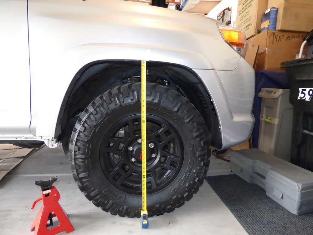

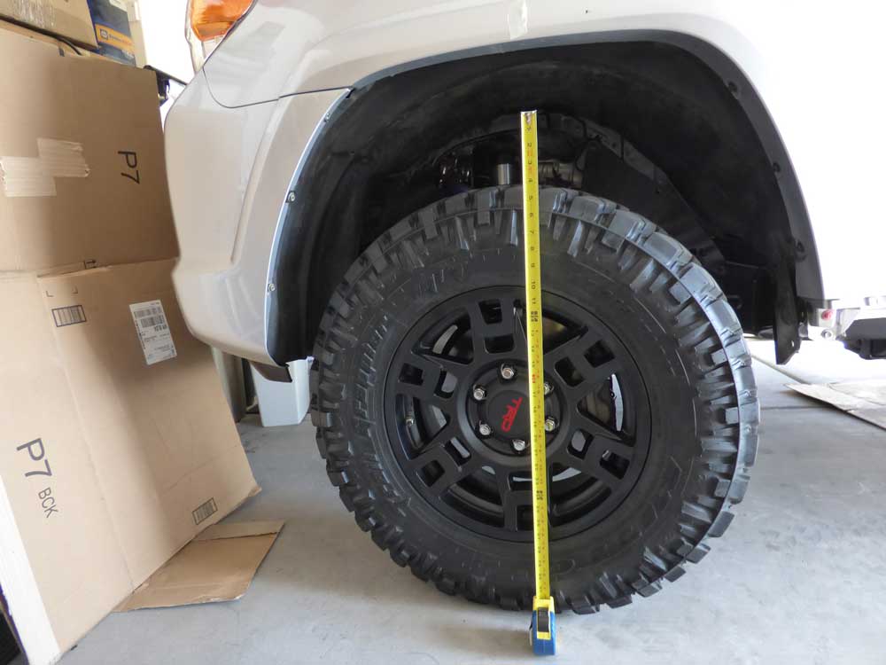

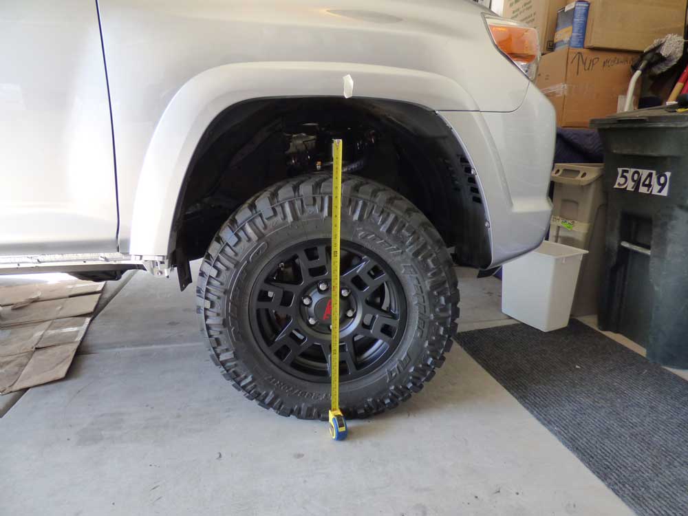

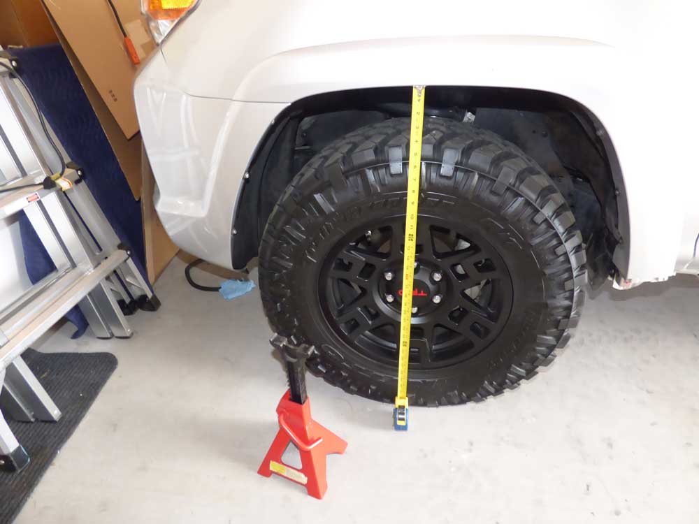

So I got the numbers of the before, immediately and after settling after 40 miles.
I will try to take final ones before the alignment
Driver Front
Before Floor to wheel well 35"
Center hub to wheel well 20"
After Install Center hub to wheel well 23 5/8"
After Settling Center hub to wheel well 22 1/4"
________________________________________
Passenger Front
Before Floor to wheel well 35 1/8"
Center hub to wheel well 20 1/8"
After Install Center hub to wheel well 24"
After Settling Center hub to wheel well 22 5/8"
Driver Rear
Before Floor to wheel well 36 3/8"
Center hub to wheel well 21 3/8"
After Settling Center hub to wheel well 23 3/8"
Passenger rear
Before FlLoor to wheel well 36 3/4"
Center hub to wheel well 21 3/4"
After Install Center hub to wheel well 24 5/8"
After Settling Center hub to wheel well 24 1/4"
Initial thoughts, floppy is gone, but this is no way a stiff suspension. I actually expected it to be firmer. It rides very nice on the highway. I need to find some streets with speed bumps or dips and see how it handles it.

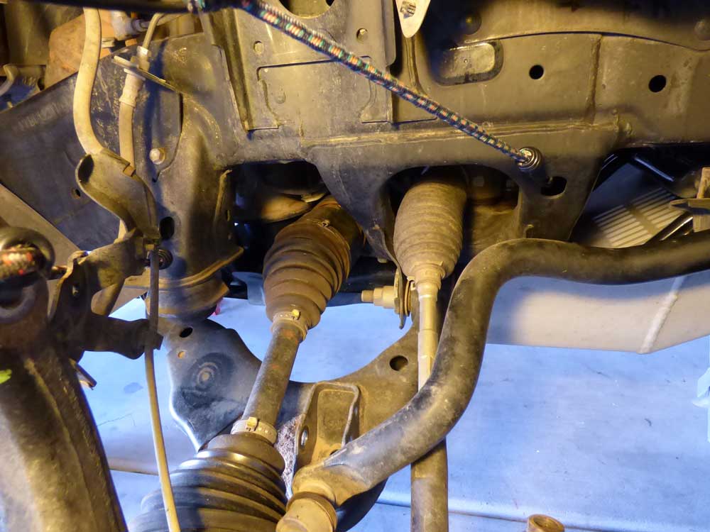

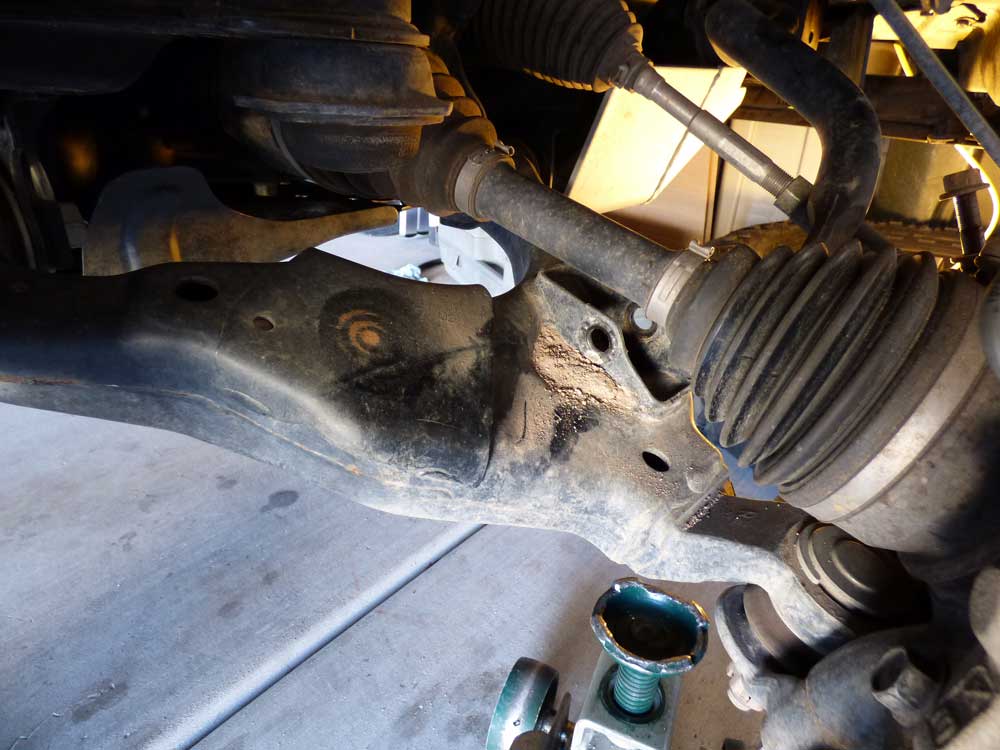

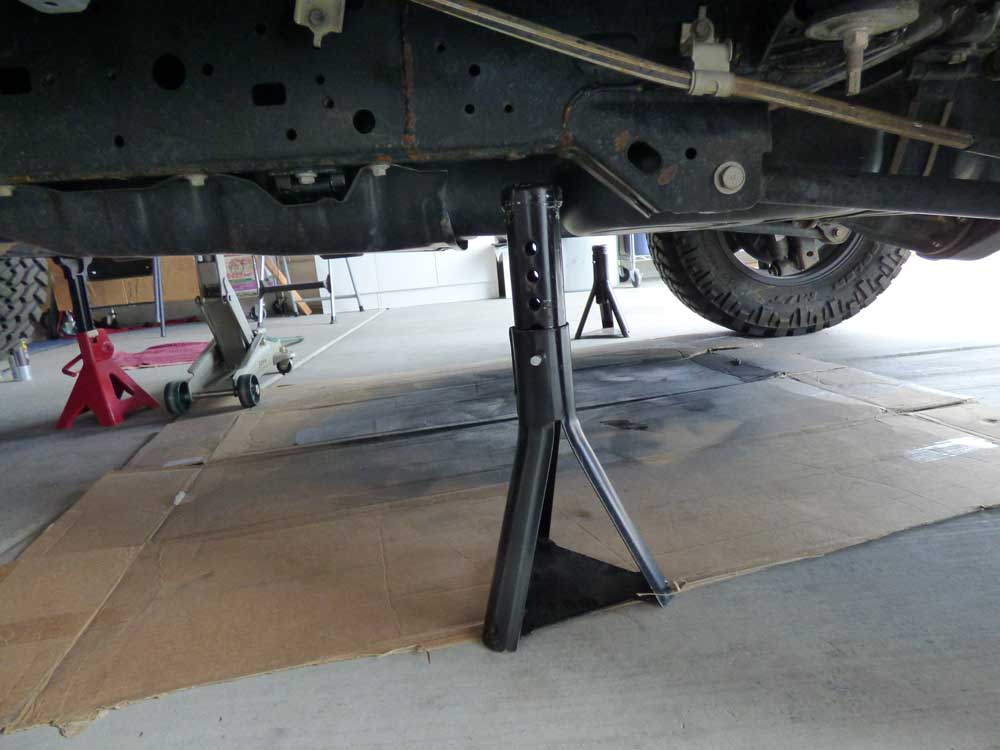

So I am working on the lift, and have most of it done. I have replaced the front coil-overs, upper control arms, rear shocks and rear coils. Nothing traumatic happened and things went fairly smoothly for once, although it took a really long time to complete. Unfortunately I have to spend about 2 hours cleaning for every 30 minutes of wrenching. So what should have taken 5 or 6 hours took 20. Straight through with a couple quick trips for new jack stands and meals.
So I finish up fighting with the front sway bar brackets. They are being a pain. So here is the one negative thing that did happen. I dropped one of the brackets and it fell perfectly splitting my head open right above the eyebrow. Luckily it wasn't my eye.
Anyway, on to the stupidity part. I am cranking on the bolts for the sway bar and re-installing the skid plate, all the while laying under the truck. Get it finished after a trip to Walmart to find butterfly closures for my head and Home Depot to find longer bolts for the skid-plate.
I decide I need to paint some of the rust spot underneath. As I am getting ready to crawl under again, I notice something weird about the jack stand. What hell? Then I look at the other side and see it has slipped off and is hanging on by less than a 1/2". And all of this time I am laying under the engine just torquing away on bolts.
I am really lucky one side or the other didn't give out. These are 3 ton stands. Looks like I will be getting a second set of new stands. (at least they will match now) This is why you don't work on a vehicle for 25 hours straight.
(And no, the front tires were not installed at the time)
I have upgraded to 6 ton jack stands... I am capable of learning... sometimes it just takes a smack in the head :brick:
