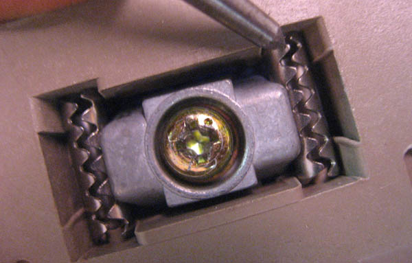

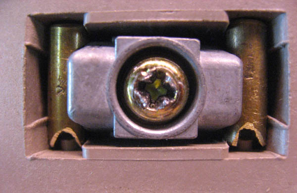

Sense no one has posted what the "worn parts " are here's a photo of the worn parts and my own fix.
I used 3/16" diameter brass rod and just cut a groove in one end.
Mirror will never come loose again....I hope.

You don't even need to put new bits of tubing in there. I just took a screwdriver and opened up the 2 pins a bit and put them back in. That was over 5 years ago and it has been rock solid ever since. The whole thing took about 5 minutes.
Bill.
