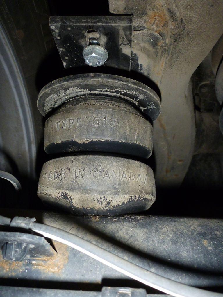

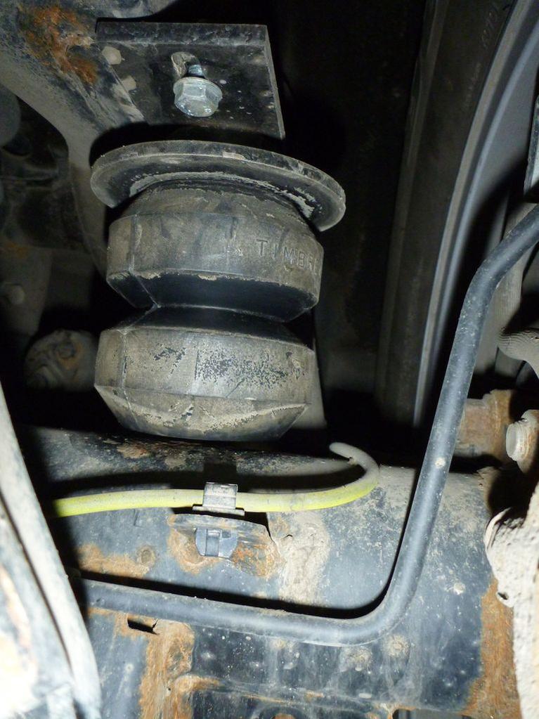

Review: With no trailer, I didn't notice anything which is exactly what I wanted. There was about 1"-1.25" of gap between timbren and axle. The only time I could tell they were there was going over speed bumps, I could feel the axle rebound and kick off the rubber.
Once I had my trailer hitched up, there was still about a 1/4" of gap between the rubber and the axle. (See pic). Towing with the setup was a good experience overall. I could feel the rubber Timbrens squishing on dips in the road and G-outs. When it would rebound off of the rubber I could feel it kick but it still felt controlled. I have a set of bilstein 5100's on order so I'll be curious to see how, if anything, it changes things. I think with an aftermarket rear shock with more rebound dampening you could eliminate the slight kicking. But like I said it was more than fine just the way it was. It made me feel more confident too, like if I had to do an emergency swerve my 4R wouldn't body roll like it does stock. Pretty happy I would say overall. Best part was the installation, 15 mins, that was great. I'll report back when I get the 5100's on and see if it improves things.

With trailer on, about a 1/4" gap.

Rear Timbren bumpstops.

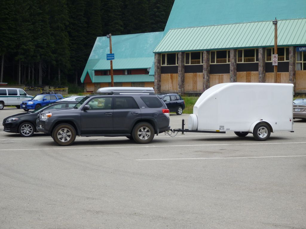

So somewhat over a month ago I was rushing to get out of town on a 2 week family camping trip. Last summer I'd bought a covered utility trailer to put 4 bikes in and allow lots of space for camping gear and give us a bit of space to sift though gear when in rain. You can see the rig in the photo below. There is a man door on the other side. Yes I know I probably need another 1" or so of drop on my tow bar and actually have a new one now @ 5.25" to try, old was only 4".

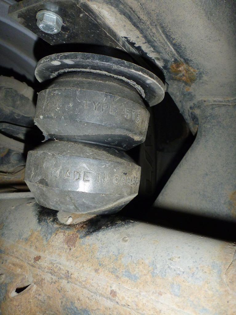

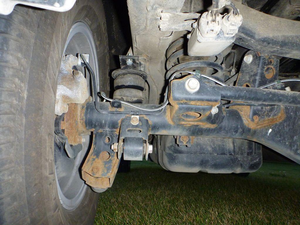

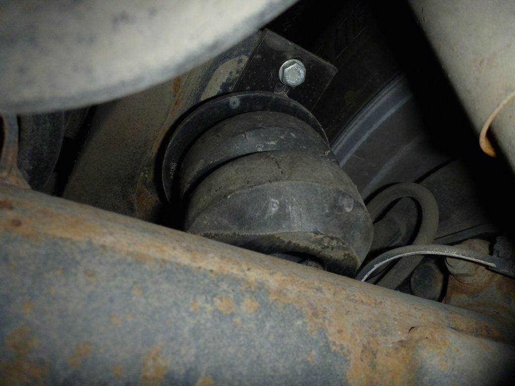

Really made a difference with the ride and stability on highway. Even with the trailer off when 4WDing on logging roads, the Timbrens still contact with the load of the back and rooftop having cooler, gear, and people. I think this makes it a stiff but relatively bounce free ride. I probably noticed a few rebounds when hitting some really bad bumps or holes but it was acceptable.
Back in town and unloaded I finally got to see the empty ride height. Definitely does not make contact. Ride unloaded is actually pretty good and I haven't really noticed contact bounce. Since when not traveling the truck gets little weekly use I don't think it's a big issue leaving them on. I had contemplated swapping them out when back.

You do seem to be riding about an inch lower in the back. Is that a bit of an illusion? If not those Timbrens must be almost fully compressed. That could be pushing the tongue weight somewhat. If it's still within spec you might need to move up to bags.
Next time I'm fully loaded and fueled I'm going to have to snap another profile and see. My goal is to stay pretty level, particularly since stock has a decent rake to it.
I do think the stock springs are a little soft; sacrificing load for ride. IMHO a mistake for a niche product; one of the only remaining small "truck" SUVs. I would think we are usually carrying a load. If you are using your 4runner to toodle around town you have the wrong vehicle; get a Highlander or something. Don't get me started on the lack of V8.
I don't think it's compressed to its limit. There is a inch or inch and a half when unloaded so I think when it's loaded it appears worse. My trailers tongue weight is ~175 lbs. My trailers done for the season so I won't see this again til next summer. The drop looks almost identical.
