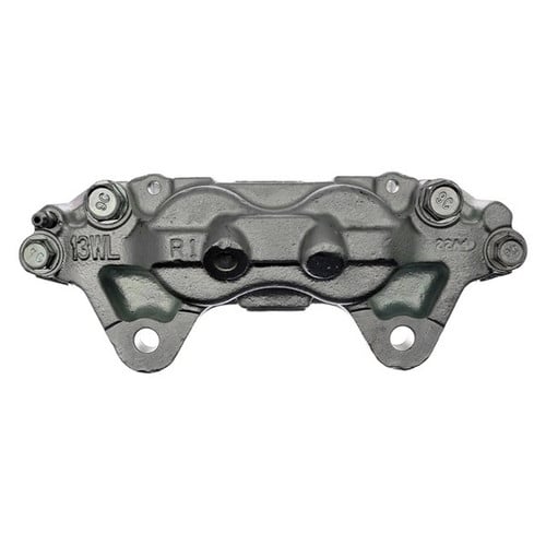

Those red rotors might be oversized Tundra rotors. Mine are also red, that's the Powerstop brand. The photo you posted didn't work, can you tell us the manufacturing stamp on the rotors? Is it 13WL?

Fronts are red calipers and I see a "13" on them

Sorry, the casting mark is on the opposite side where the brake line is. I should have been more specific. I can see your photos now though and those brake drums look horrendous red! I can see why you want to get rid of it. Some high-temp paint from your local hardware store should do just fine for the drums as it's just a chunk of metal. Painting the calipers is a bit harder to do though as you don't want paint all over the pistons.
Pic for reference on where the casting mark is:

I see S13WY

I looked at the photos in your google drive. You have S13WM which is the stock caliper for most 3rd gen 4Runner's.
