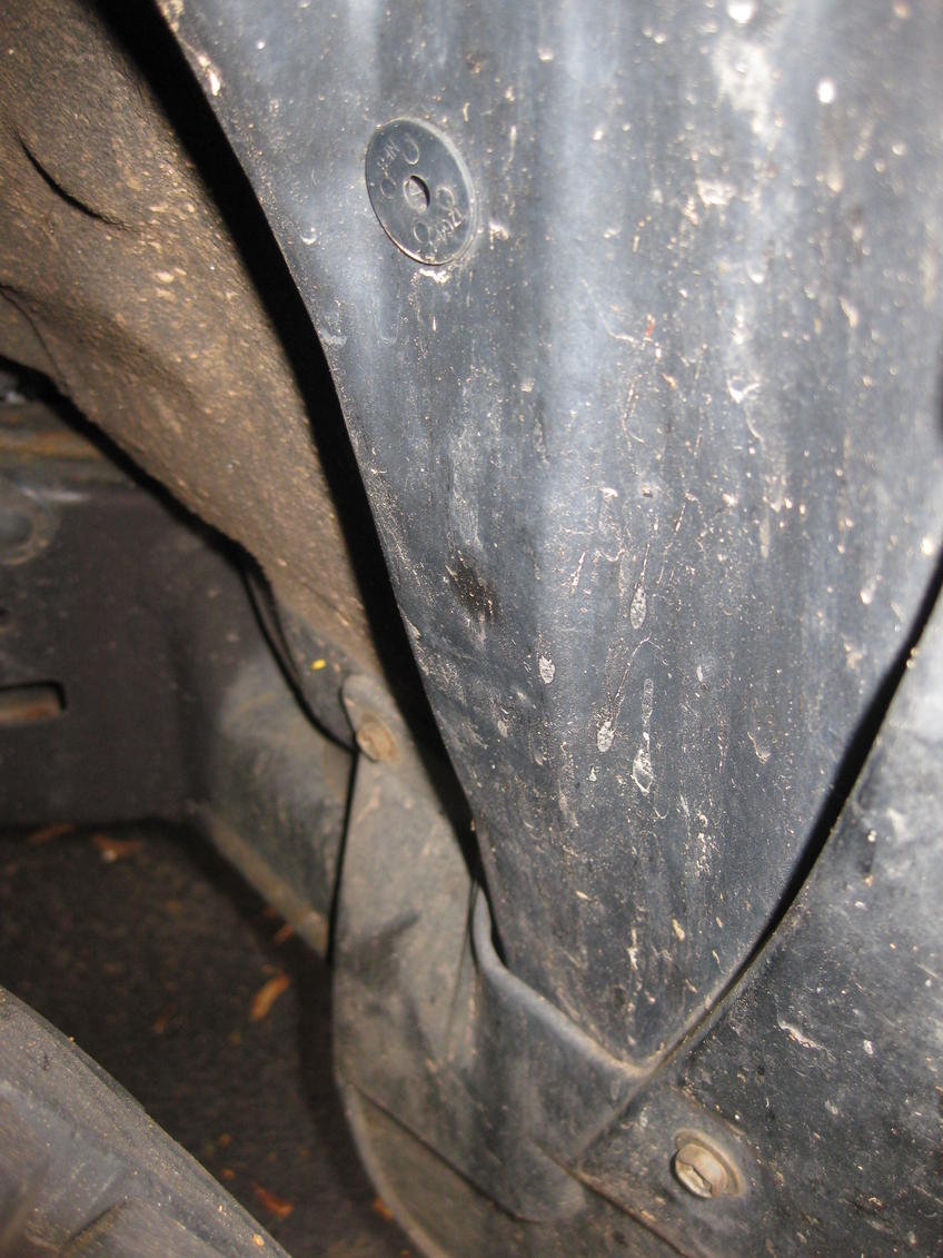

After checking on this forum, I got a set of FJ Cruiser 17 inch wheels with Goodyear Wrangler tires, 270 65 17. I understood that they would fit without any issues or rubbing.......well not exactly. The driver's side is rubbing on the bottom of the mud flap and on the protruding section of the fender liner directly behind the tire (driver's footwell area). I really like the FJ Wheels, but the rubbing is not acceptable, not to mention the really noisey goodyear tires. Is there a fix for running the 17s, with the 270 65 17s? Would switching to a 265 65 17 be a reasonable option? Can the rear fender liner be modified to allow me to use the 265 70 17? Thanks Phil
the stock wheels on my SR5 4WD were 265 70 16. I installed some 17 inch wheels off of a FJ Cruiser with 270 65 17 Goodyear tires on them. The front driver's side is rubbing on the protruding section of the fender well. Trying to figure out if I should just dump these wheels and tires or if there is a way to trim the fender liner. thanks Phil
the stock wheels on my SR5 4WD were 265 70 16. I installed some 17 inch wheels off of a FJ Cruiser with 270 65 17 Goodyear tires on them. The front driver's side is rubbing on the protruding section of the fender well. Trying to figure out if I should just dump these wheels and tires or if there is a way to trim the fender liner. Would running the 265 65 17 tire resolve the rubbing issue? thanks Phil
Just push the fender liner forward. Most of us have done it when we went to larger tires.
I don't seem to be having issues with the front of the liner. My issue is to the rear of the tire on what would be the front side of the footwell. There is a popout on the liner about 3x3 inches. It also rubs on the very bottom of the mudflap. That would be an easy fix. What can be done with the box popout part. thanks phil
What does your alignment look like.
Can you post a picture of said pop out?
I forgot to mention many of us remove the mud flaps too
is this the area you are referring to as the pop out? if it is, 3 questions, is it stock height(no lift), how far out do the wheels stickout from the fender, & again, when was the last time u had an alignment?
I can't get a photo right now. As you face the front drivers side, it is on the right and about 8 inches to the inside from the outer edge of the wheel arch. It looks to be part of the wheel well liner aft of the tire. It is molded into the fender liner. About the size of a pack of cards. Phil
actually, yes, I just went down and took a look. That looks like the part that is rubbing. It looks like it is part of the mud flap. I assume that the mud flap can be removed without creating any issue. Correct? Phil
you could also just cut out the 3x3 section where it rubs but removing the MF completely should solve ur problem.
I took the 4runner over to a local shop to check the alignment. I knew that it was out, but didn't know that is was sooooo out. the toe in was consistent on both side, consistently way out. The inner tie rod end on the driver's side was also worn. They changed the inner tie rod end, did the alignment and what a difference. I thought that the steering was just the goodyear ats tires, not so. It now drives like a brand new truck. I was also able to reassess the tire rubbing. I will either remove the mud flaps completely or trim them today with the dremel tool Also, as was suggested by many of you, the tires were rubbing the front of the fender liner, I will move the liners forward as well. Great forum, tons of very useful info. Thanks to all of the contributors. Phil
