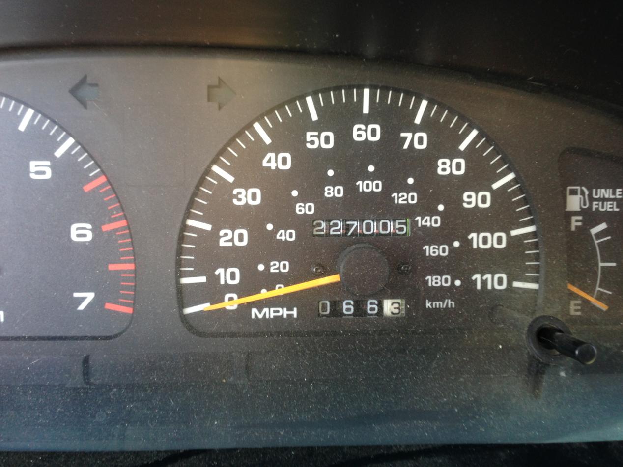

Time to get a lift kit, suggestions? And look what marker I just hit!!
