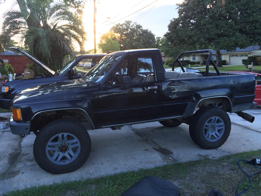

Its aliiiiiiiive! So many thanks to Thefishguy77 for sending me the ECU and getting my Rex running again! After sitting for almost 2 years it fired right up like nothing happened! Once I get brakes put in it and a few other things tidied up it will be all good to hit the street and then the trails!!!
Here my Rex! Out of the garage and moving ynder its own power! Gave it a quick wash and took the top off for the first time!
