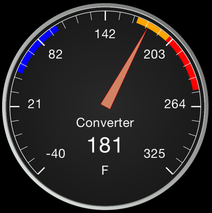

I bought an OBD II wifi dongle for Basecamp and have been watching the transmission temps and pan temps. In day to day driving it stays pretty cool below 170 even on 100deg days. But when I load up my camping trailer which weights between 2000 and 3500 lbs loaded on those same summer days the tranny converter and pan stay in the low 180s with very casual driving and spike up into the 190's on any kind of hill. That's too warm for my taste.

190 on a hill at highway speed with 3000 pounds really isn't high at all. That is pretty normal for a load of that size with a v6 powered aerodynamic brick 4x4. Lower would be better, but I wouldn't be concerned unless it stayed at 200 or more all the time while towing.

Agree on all points. Most post's I've read say tranny life drops off quickly with sustained temps over 170. Even though the transmission will run into the low 200's like it's no big deal. I'm going to try to get a towing temp of around 170 ish after the cooler install.

Frankly, these temps look good. Below 200 is fantastic, and a testament to the modern transmission and trans cooler. Many of the vehicles I have seen that needed a trans rebuild had seen temps on a regular basis (I'd suspect daily) in excess of 240 or in some cases much higher.
This engine/trans combination is proven, so I'd rather leave it alone than enter some additional leak or failure point in to the hydraulic system (i.e trans cooler).
The key is sustained temps which is not what you are seeing.
Also 170F is extremely conservative. Sustained averages of 195F still give you over 50K miles for most ATFs in a non sealed transmission. And your temps are only occasional while in a sealed transmission.
The problem with higher temps is oxidation of your transmission fluid. This is both a time and an environmental factor. If you create a low oxygen environment (Like a sealed transmission) oxidation is drastically reduced and the ATF becomes less temp sensitive. The funny thing: everyone is filling their tires with Nitrogen when really they should fill their crankcase and transmission with it. Hot oil is more affected by oxygen than rubber.
Apart from the condition of the ATF the metal parts like bearings and such are not affected until the temps get >400F.
