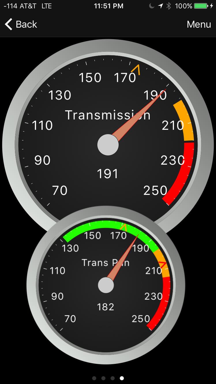

A little more data
I've been watching the tranny temps the last couple of months and I thought I would share what I've observed.
The first pic is an example of daily driving without a trailer in Austin. On this day it was 85deg and the tranny stayed cool despite a couple hours of driving all over the city in stop and go traffic. Unloaded the tranny stays cool and it's hard to get it over 170 in the pan.
The second pic is an example of a road trip with my ~3000lb trailer also around 85 deg ambient. When the tranny is locked by putting the tranny in 5 or 4 the temp stays pretty reasonable. But the problem is the tranny is constantly unlocking itself (even when you have it in 5th gear with the shifter) and when it does the temps quickly climb. The high and low indicators show the range on this trip (about 600 miles) and in actual practice the tranny temps stayed in the 190/200 range. However, this was because I was actively managing the transmission manually. In the past if I've just left it in D the pan temps will get up into the 220+ range especially in the hills. I don't have a screen cap of this as I don't want to do it to the truck.
Other observations. When in 4L pulling the trailer at low speeds, the tranny has no issue keeping temps down. When at highways speeds and the tranny is locked in 5 or 4, it has no problem. But at moderate speeds 30-50 in hills the temps skyrocket because the tranny stays unlocked regardless of what you do. I was really surprised by how fast the temps spiked.
My conclusions: When towing keep it in 4th gear or proactively downshift from 5 to 4 before a hill. In slow speed winding mountain roads, watch your temps if towing.
Hope this is helpful.
