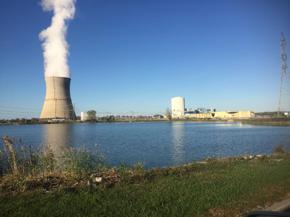

Little update. Off to work for 2 weeks working on a different kind of diesel. Little more power than a VW..
Sent from my Galaxy S8 using Tapatalk
Looking forward to the swap! Until then, I trump your power generator. Haha.
