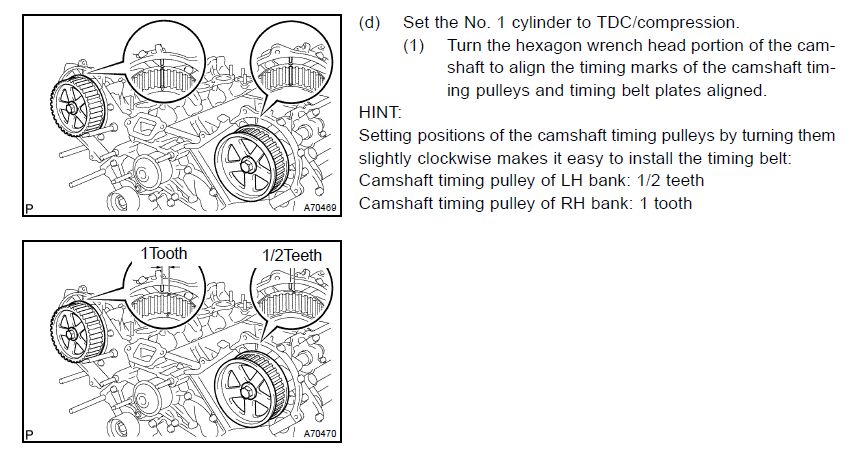

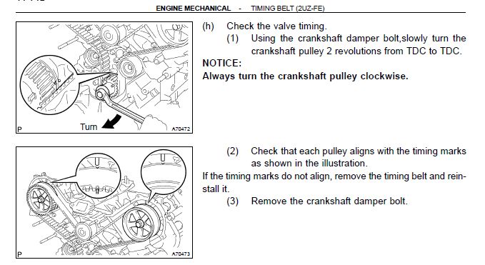

My guess is that when he lined up the timing marks on the camshaft teeth with the marks on the block he did not offset the marks by 1/2 tooth (LH bank) and 1 tooth (RH bank). You have to line the marks up this way, then after you release the tensioner the marks will line up perfectly. Either way he should have checked to see if the marks were lined up after releasing the tensioner, and if they weren't, start over and repeat the process.

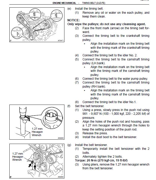

The arrow on the belt should be pointing towards the front of the vehicle. I had a similar issue where for the life of me I couldn't get the timing spot on because I had the belt backwards.
that's what I was remembering but didn't want to call it out without being certain. for some reason I could of sworn the arrows were supposed to point towards the timing marks lol, nope they're pointing to the front of the vehicle lol.
Trust me I spent an hour retiming my V8 yelling at myself, "the arrows point at the marks how god damned stupid are you!?" Until I looked at the instructions (the pictures above actually even tell you to point the arrows to the front) and it finally clicked in my brain and I was like...doh! :rofl:
So I am well qualified in being the one to point out making such a simple mistake! LOL
