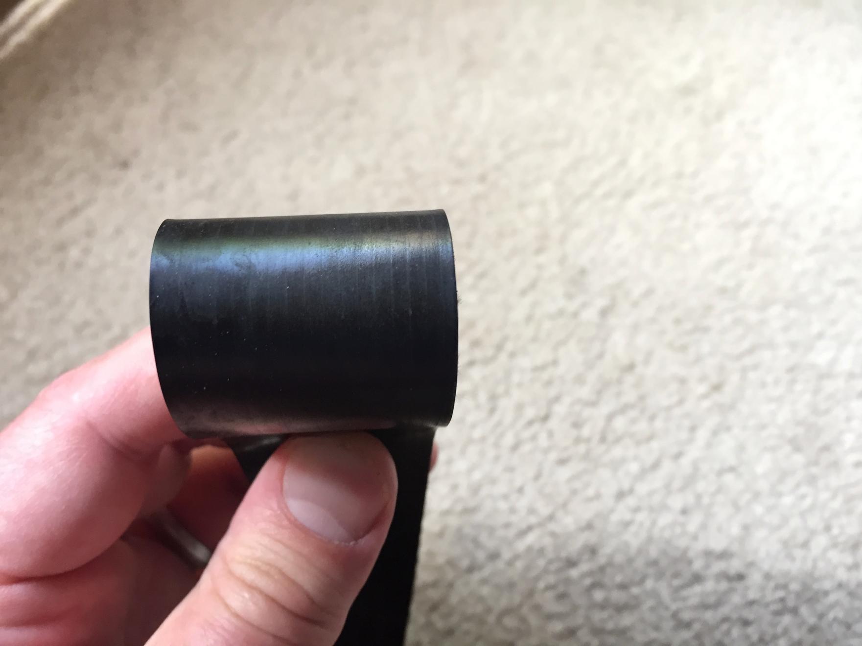

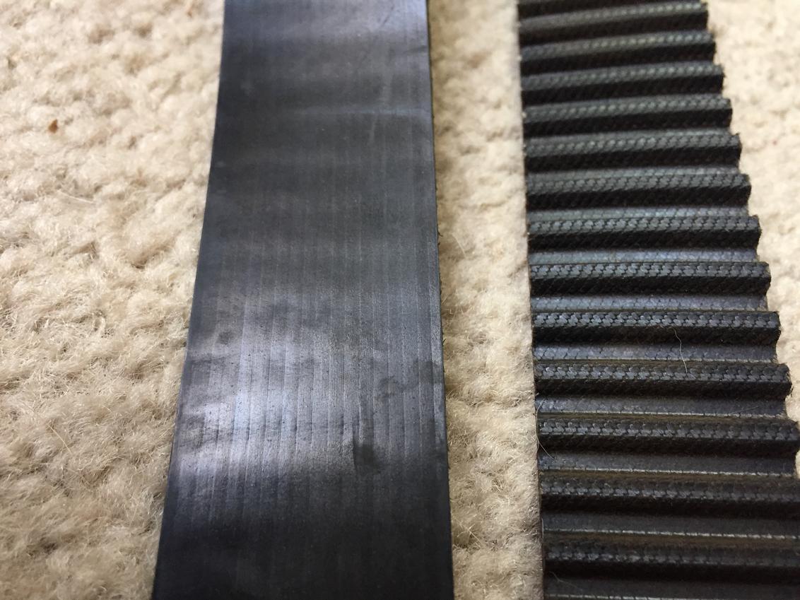

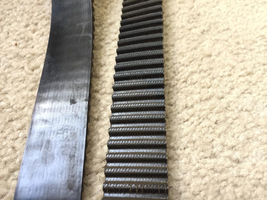

I finally had my timing belt replaced along with the water pump (and all of the accompanying belts, etc.) and I told the tech I wanted him to keep the belt so I could see the wear on it since my rig has just over 127,000 miles on it! I know I should have done it earlier, but along with the above quote from Mike and reading other anecdotes on this site about the TB I wasn't worried to let it go a few extra miles. Well, you know what happens, 90k turns to 100k, "it's still fine, I won't change it until my next service", then that comes and goes and next thing I know I'm targeting 125k as the change date. 37k miles after the Toyota recommended maintenance and here are the pics of the belt. It looks brand new. The tech was surprised at first, then said, "But that's Toyota for you."
As you can see in the last pic, even when squeezed together, there aren't any hairline cracks or anything else I can see. That being said, glad I had it done finally, not that I was too worried about letting it go as long as I did. Peace of mind. This, of course, is just my own opinion and NOT a recommendation. I urge everyone to change their timing belt at the Toyota appointed mileage interval.

Had mine changed at 145k miles, belts and parts still looked good. I read a blog post where a guy replaced the original TB/WP on his neighbor's 1998 LC at 187k miles! That's Toyota quality.
