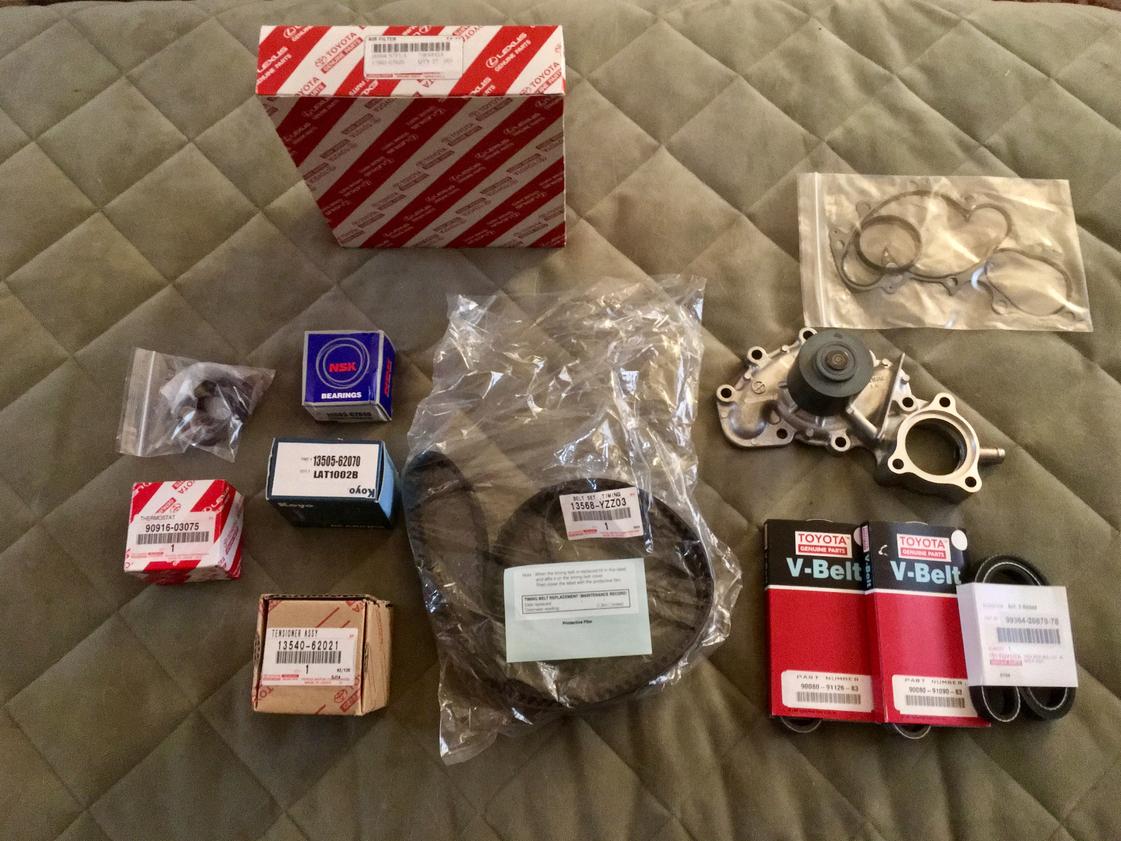

Ordered the ebay kit as well with all toyota parts.
What extra parts or "shop supplies" are also needed to complete the job?
Ordered a seal puller -- What's needed to install new seals other than press? Grease of some kind?
Ordered new crank bolt -- Need thread locker. What brand/strength?
New Aisin water pump -- Just use Aisin gasket in kit?
Ordered pulley holder -- Plan to try (in order) impact, breaker bar, bump starter.
Trans fluid to replace any lost in disconnect.
New coolant after radiator reinstall.
Any other supplies that are commonly forgotten until your elbow deep in the project?
Normal stuff. I would degrease the engine first.
There's no press needed. You need a way to hold the camshaft sprockets when you loosen the bolts. I used a chain wrench and wrapped the sprockets with the old timing belt.
The new bolt comes with threadlocker on it
Yep. The aftermarket WP comes with those crappy paper gaskets. Took me 45 minutes to scrape the old sealant and gasket off the engine. Had to use a wire wheel and that was MUCH easier. The Aisin metal with the sealant bonded to it is so much nicer.
I recently found a special socket which is much heavier and creates more inertia with an impact and is suppose to work pretty good. It's made by Lisle. I think it was mentioned in this thread.
You wont lose a lot. Maybe a pint. Just top off what you lost.
I would do this. HOAT brand Toyota red or pink or the Zerex Asian. Pep Boys sells "OEM" aftermarket stuff that I used before.
I would replace the little oring on the oil dipstick tube. If your radiator has more than 125000 miles, I would replace that too
When I did my water pump, the old water pump was OEM Aisin with the proper rubber bonded metal gasket. The rubber still fused with the engine block and required some scraping. Probably because of the heat and time. Still better than those crappy paper gaskets or silicone sealants though.
Actually, the OEM pump, while made by AISIN, was made with a channel in the pump flange which was filled with FIPG sealant when installed. The AISIN/TOYOTA replacement pumps were that way for a while. Then Toyota redesigned it around 2010 I think, as it leaked like a sieve and AISIN made the rubber/metal gasket version as OEM replacement.
The FIPG was a pain. Good riddance.
