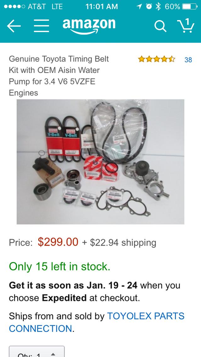

Thoughts about this kit?
I also noticed a 27 and 52 piece kit too.

That one looks like a good complete kit. Looks like the same parts list as the 15 piece kit that aircabinman sells on eBay that many have gone with but the amazon kit comes with an oil filter & gasket. The eBay one is a little cheaper & has free shipping. It's the one I recommended to a friend when we do his timing belt/water pump. The 27 piece kit that I think you're referring to has spark plugs, spark plug wires, valve cover gaskets etc.

The AISIN TKT025 kit I used from Rockauto is still only $174US. The kit you pictured does have, what looks to be, a crank seal and drive belts as well. Even with the belts etc, the Rockauto kit would probably be a little cheaper. Don't forget to use Loctite on the crank bolt.... and maybe replace it....
