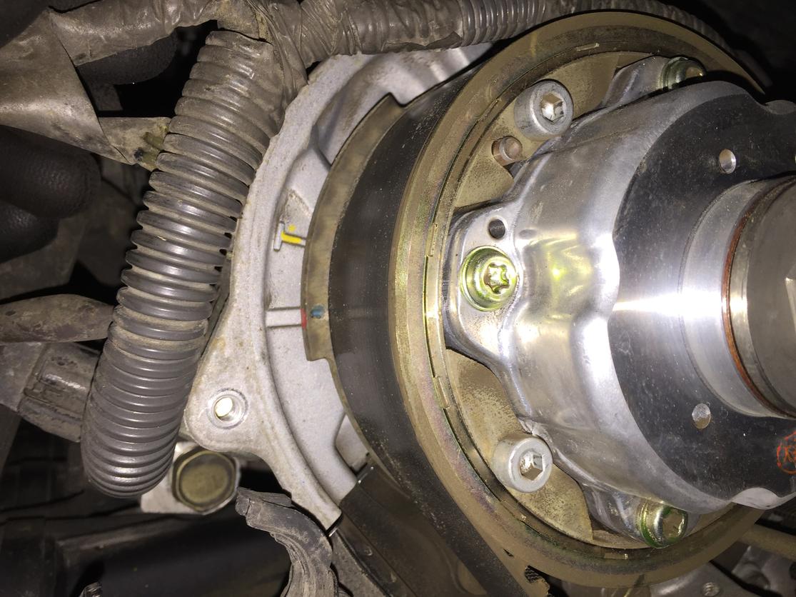

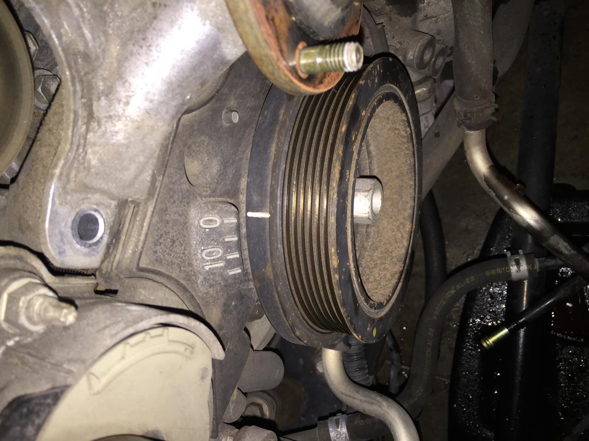

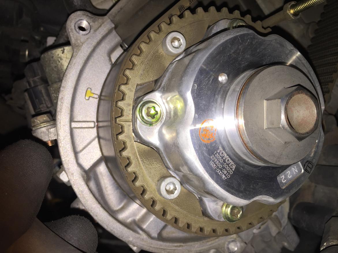

I'm currently in the middle of a timing belt taking a break. I got to the point where I'm lining up the timing marks to be at "0" on the crank and on the "I" on the camshafts when I noticed the crank looks to be off a tooth. Now I have not gone any further than what you see in these pictures. Just wanted to post this and see if this is normal or not because I don't think it is.

ok, is that after rotating the engine 2x?
the tensioner should pull the extra slack out, and the mark will land right on the money.
I ask, because that doesn't look far enough to be 1 tooth off.
Oh, that's the belt stretching over the years. It's more like half a tooth off. Don't worry about it with the old belt (I even mentioned it in my T-Belt thread.) I'd only be concerned if the new belt did that and even then it'd still probably be fine.

Like blackworks said, that looks normal for the old belt coming off. Just make sure to face the new belt the right way and count the teeth. I always mark the old belt on the way off and count to match up with the new belt. New belt should have marks for left/right cam and crank already but never hurts to double triple check! Bar 2 times around by hand when back together, marks on the belt won't line up but marks on crank and cams should be closer than your pics posted here.
