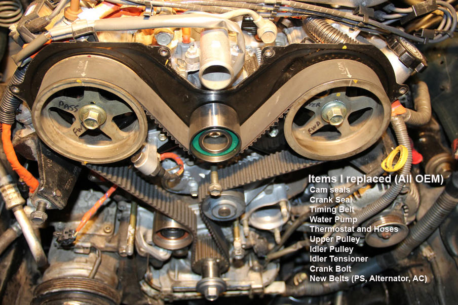

I think it depends on how often you want to tear your front end apart but at 100K miles if I'm going to change a timing belt, then I'm going to change just about everything it comes in contact with.
It's hard to check these items for their true wear and they may only have about 50K left on them. It might be a bit of overkill but it sure is good insurance and allows me to have a good nights sleep.

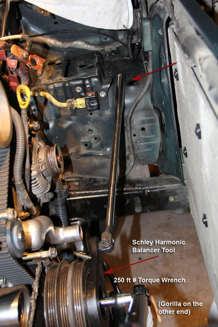

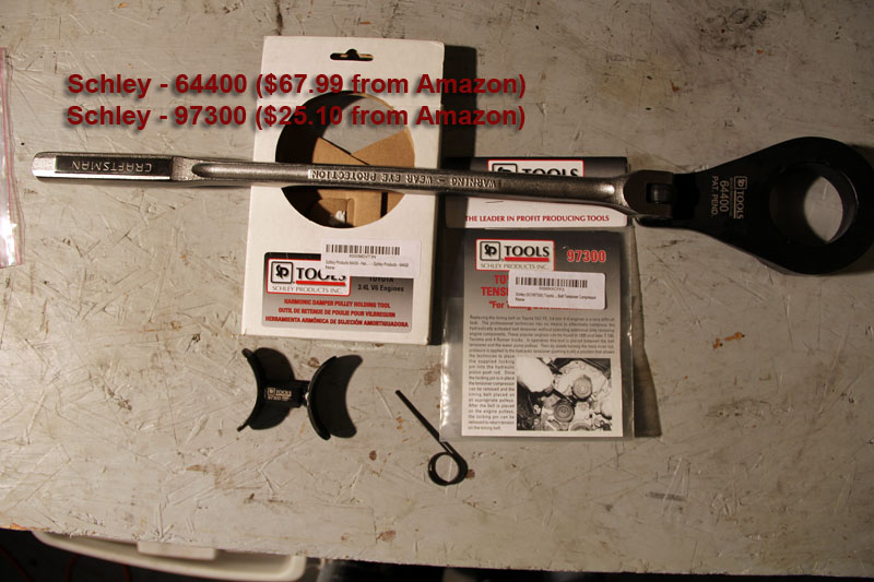

There are a lot of ways to remove your crank bolt, ie: "bump your starter" etc. but I recommend soaking the bolt two or three days, invest in the Schley Harmonic Balancer tool and get yourself a Gorilla from the zoo if you don't have any shop air. Total cost for me to replace everything with OEM was around $750. Took about a day.

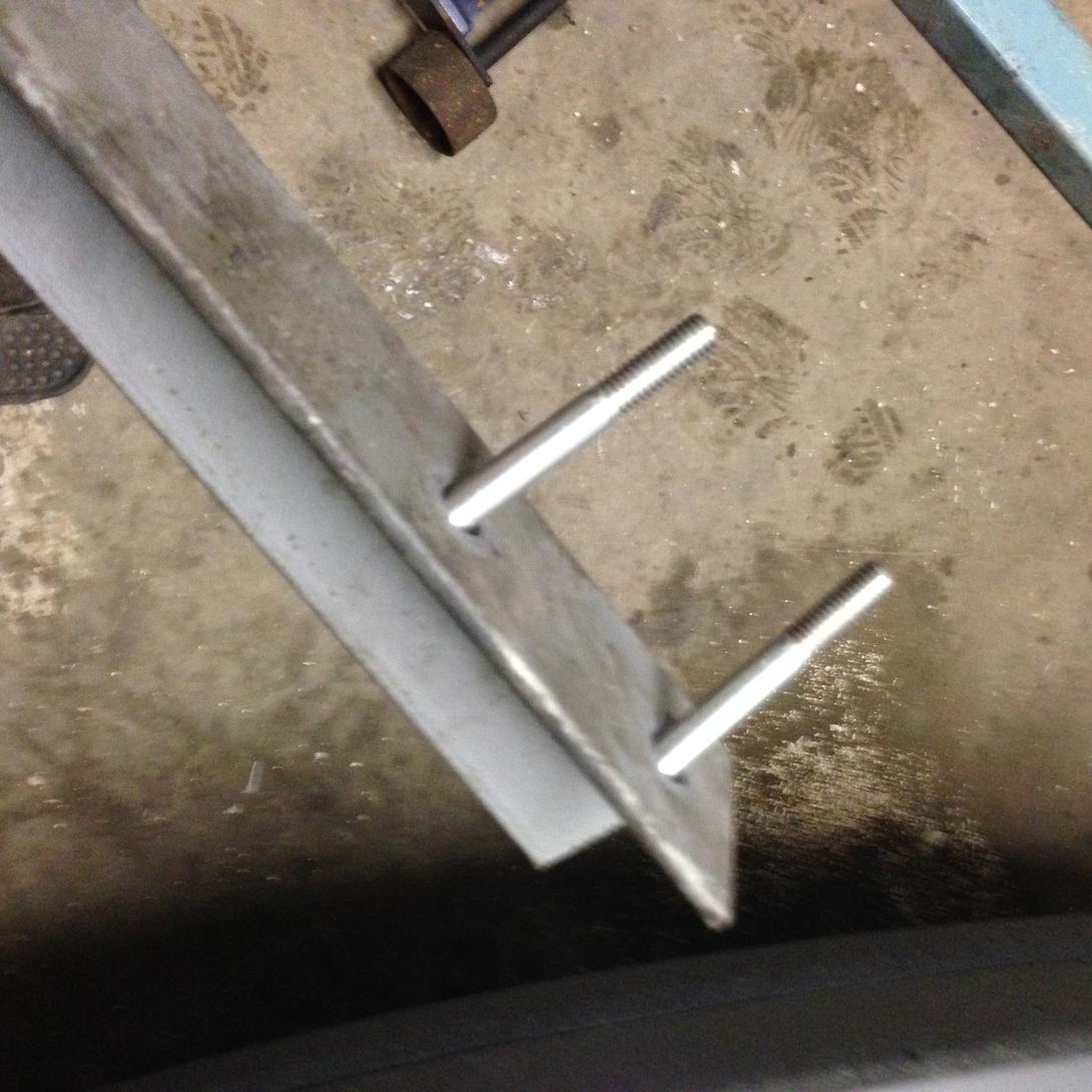

I should add that I built a tool to re-torque the crankshaft bolt out of 1 1/2 inch angle iron with 2 half inch holes with bolts through them to hold the rhs camshaft pulley while torquing. I would encourage anyone considering taking this on to do it.

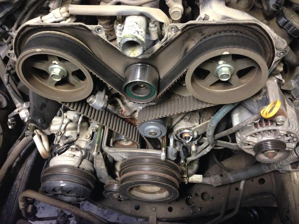

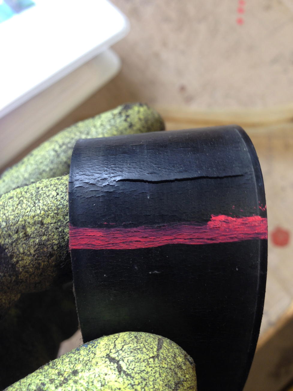

The pic is just one I took part way through the removal. I have one other that I took of the old belt that was original with 307 000 km!
Old belt and the tool for holding camshaft pulley while torquing the crank bolt.
