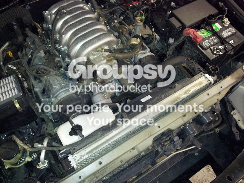

I would look for a sticker somewhere on the firewall or timing belt covers that says the timing belt has been done (almost all Timing belt kits come with this sticker and most technicians put them on.) If the sticker is really faded, I would shine a UV light on it, they seem to highlight the ink even though it looks severely faded. (little trick I discovered.)
Also if you inspect the bolts holding the timing belt covers (the black plastic covers) you should see if the bolts have ever been taken off (they'll have small wear marks or dents where the socket imprinted slightly on the bolt head. Another place to look is the water pump inlet, if it has black FIPG (Form-In Place Gasket, or RTV) then it has been done, factory stuff is usually grey.
In the picture below it is the rectangular aluminum piece just below the throttle body opening. (One of the bolts that secures it is like right in front of the throttle opening in the picture.)
