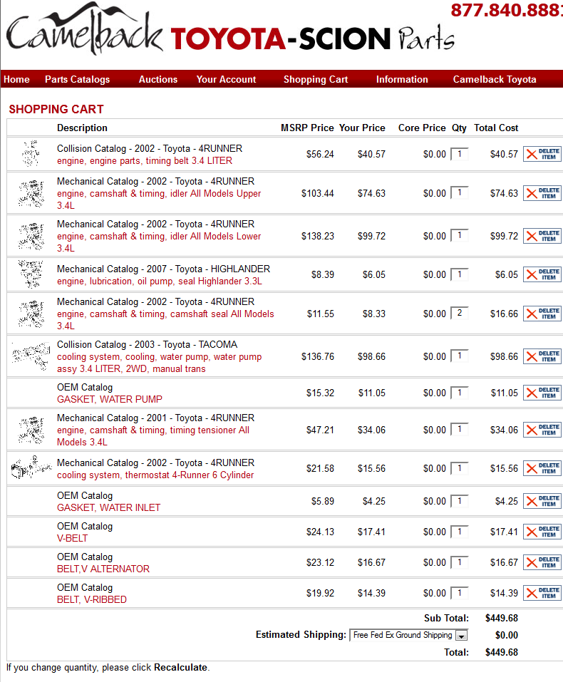

There is the question of whether or not those are even real Toyota parts.
I can buy a Tiffany's necklace on EBAY or Amazon but it doesn't mean that a real Tiffany's piece will show up in the mail. There are lots of fakes on EBAY and Amazon and you have no way to prove it. BUT they do have 99.9% positive feedback and I would seriously consider this kit if I was doing it myself. I buy "grey market" Alpine from EBAY power sellers and have had 0 problems with quality.
And it does seem like a heck of a deal. $355 for the EBAY "Toyota" parts vs $450 for Camelback Toyota Online. You may want to try and call Camelback Toyota to see if they will match this kit price. I bet they would come within $50 of the price.
