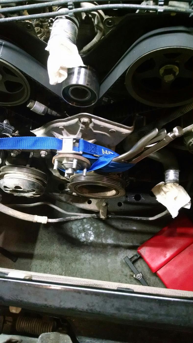

Also, I'm dumber than the average rock and I could still do it within a weekend. I used a chain wrench from harbor freight and a cut up auxiliary belt to break loose the crankshaft pulley bolt.
On a side note, my exhaust seems extremely rich since I did this job. The cams and crankshaft were all lined up, but I still wonder if they weren't perfect. Any thoughts?
Also, the picture above is how I rigged the chain wrench with an NRS 5' strap to hold the wrench while I tightened the crankshaft bolt at the end.
