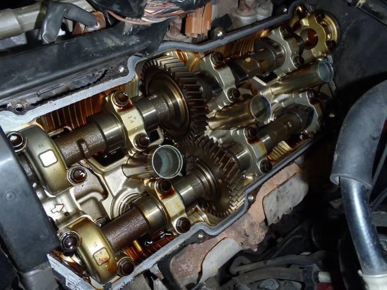

My 2000 Runner had oil leaking from the valve cover gaskets so I decided to replace them. When I was taking the covers off, the bolts were only hand tight. Probably the reason it was leaking but I had already bought the gaskets and had taken the air intake plenum off.
This isn’t too difficult of a job. Just make sure you label everything as you take it apart. A couple of things I noticed were the wiring harness on the driver side crumbled when I tired to move it out of the way and a little piece of plastic fell down the oil return hole :dammit: and the old spark plug tube seals were really hard to get out. I used a large flat head screwdriver to twist them out.
Here is a pic with the cover off. I’ve got 170k on mine. If you just bought yours, it might be a good idea to have a look under the covers.

Valve cover gasket is pretty straightforward. Mine was leaking but tightening the very loose bolts seems to have stopped it. Id tighten the bolts before anything. A gasket is easy though should it come to that. You can leak a lot of oil so long as you keep filling it. :cowboy:
