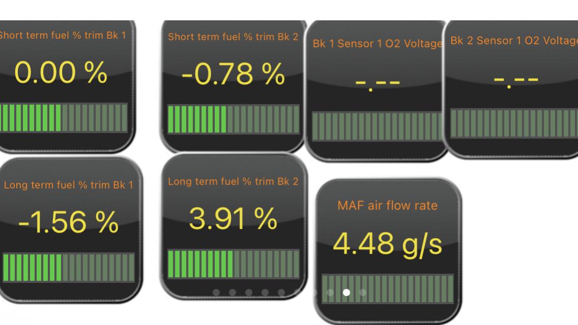

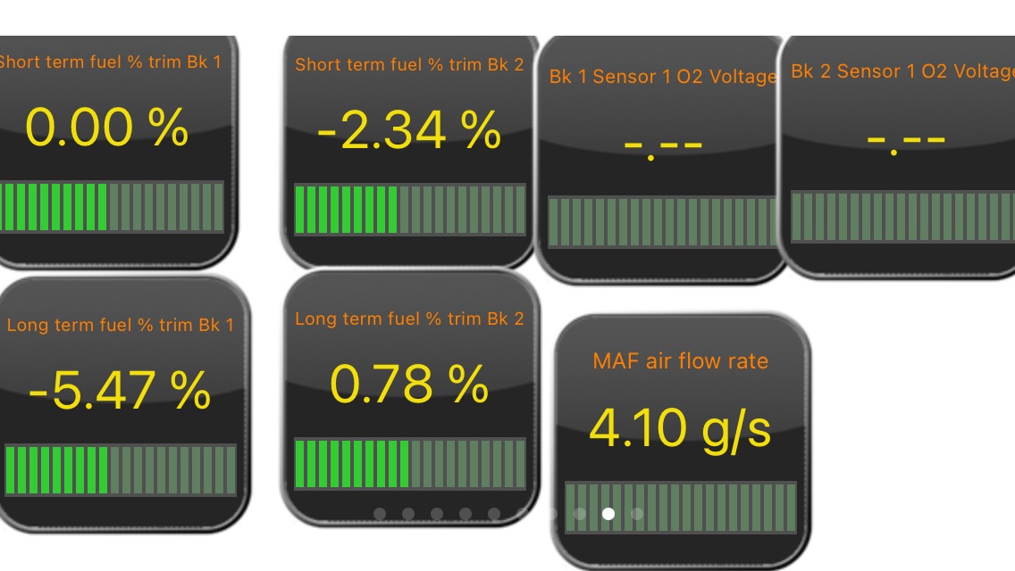

For reference, I had these readings at idle before making changes
371652d1604416702-best-guess-these-ltft-readings-fuel-trims-5aa61cd5-75fe-48bf-aacf-89fac257f175-jpeg
Then I changes plenum gaskets and fuel injectors #2,4,6 and got these numbers.
372580d1606224549-best-guess-these-ltft-readings-fuel-trims-c149501e-2bc2-47ac-be81-85dafb91e19b-jpg
Last week I changed fuel injectors #1,3,5 and now the LTFTs are balanced while cruising and at idle. Under moderate acceleration I there can be some divergence tho. It seems like the LTFT bank 1 runs slightly positive to bank 2 under accel. Im wondering if a weak fuel pump could be the cause. 223k miles on factory pump. Bank 1 gets fuel after bank 2. Could low rail pressure cause an imbalance?

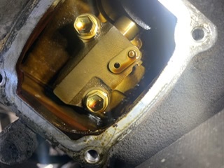

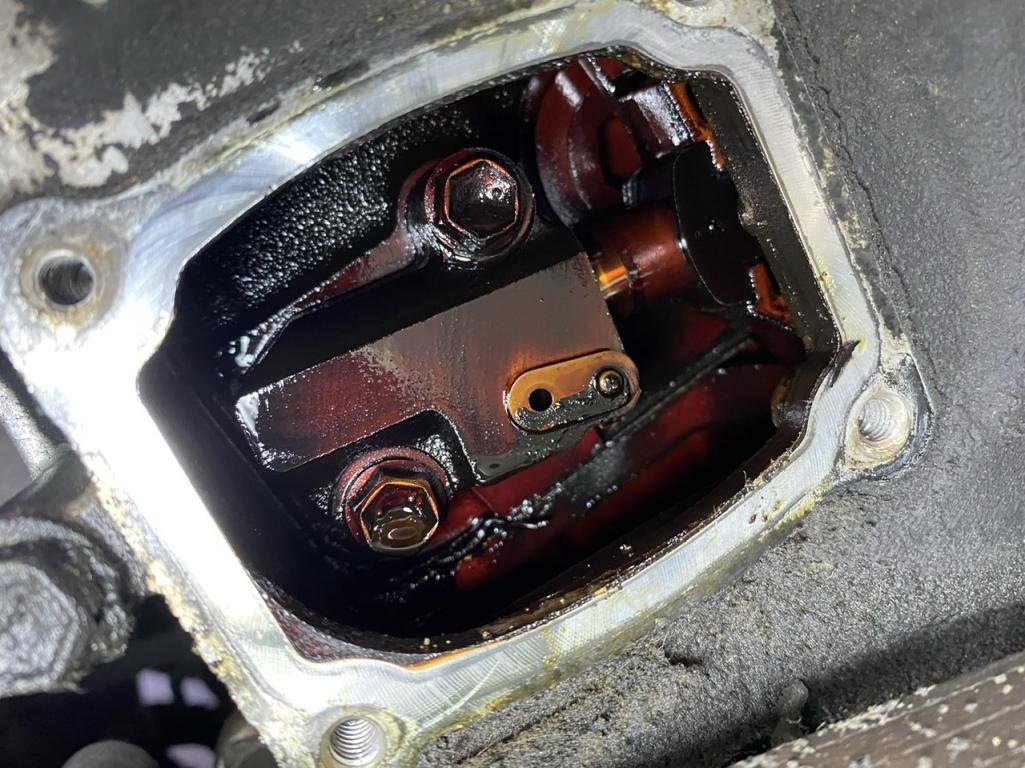

Hi all! I love this thread but dread having to use it. ^^; For those of you with experience, would you mind peaking at my tensioner, please? I’ve been getting code P0016 for a few months now, and attached is a pic of the tensioner. Do I have a stretched chain?...
Unfortunately, yes, your chain is stretched.
Hi all! I love this thread but dread having to use it. ^^; For those of you with experience, would you mind peaking at my tensioner, please? I’ve been getting code P0016 for a few months now, and attached is a pic of the tensioner. Do I have a stretched chain? How long can I put this off? I probably won’t have time for a big job like this until May...
The extended length of the tensioner piston indicates an elongated "stretched" timing chain. It's worn out. The sludge evident in the pic also indicates poor oil change maintenance.
I deferred my replacement for 20K miles while I used a variety of oils known for high detergent loads, e.g. Pennzoil High Mileage, Shell Rotella T6, etc. and on short ~2500mi oil change intervals. Also added a dose of Marvel Mystery Oil around 200 miles before oil change on a few occasions. My goal was to minimize the sludge in my engine before the new chain.
Nobody can say accurately how long you can safely run the engine in this condition, but here's what I found: I measured tensioner length when I bought the truck, and again after the 20K mile cleanup, and the tensioner was at the same exact length when I opened up the engine to do the replacement...no further elongation had occurred while I was running good oil and changing it frequently.
Good luck, ask questions as needed when you bust a move on the replacement.
Best I've seen LTFTs balance is to within +/- 0.78% (where 0.78 is the increment reported by the ECM). The exhaust system isn't tuned for balanced airflow on these trucks, it's a Y-input single outlet, and the exhaust manifold runners aren't equal length. (edit: therefore the backpressure and scavenging characteristics are not equal across all 6 cylinders). And the ECM only has a single volumetric efficiency table (fuel map) which informs injector delivery on both banks. You'll never get perfectly balanced LTFTs under all RPM and load conditions.
I agree your initial LTFT imbalances were significant and replacing the injectors (assuming the new ones aren't aftermarket knockoffs) was a good move. I usually first try a few tanks of gas with Red Line SI-1 fuel system cleaner before replacing injectors...because a.) I'm lazy, and b.) new factory injectors are expensive. The majority of cases result in restoration of reasonable LTFT balance without swapping injectors.
As others have said...yes the timing chain is stretched, the telltale sign here is the tensioner's piston/plunger discoloration, you can see the section that has a dark varnish/sludge buildup on it and then the less discolored section, the section with the varnish/sludge coloration is the area that was from when the timing chain wasn't stretched, the cleaner section is from when the chain has stretched.
If you can go with all OEM parts when replacing, and yes replace the tensioner as well all wearable parts involved with the timing chain, you don't want to do this twice because you didn't replace a part that should of been replace, the job is too labor intensive to not do it right!

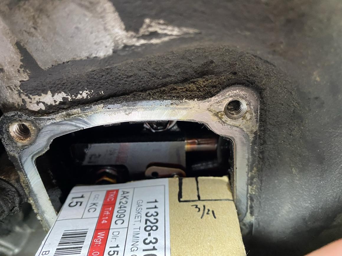

I’m hoping to get some input to either verify or debunk what I assume is a worn timing chain. After I purchased my 4Runner early last year I noticed signs of sludge and after doing my valve cover gaskets I confirmed that the previous owner/s did not have a consistent oil change regimen. This past weekend I decided to take a look in the tensioner inspection plate. I’ve searched high and low in the factory service manual, and searched exhaustingly on here and on google for a measurement of what the tensioner should be extended. No luck. I have seen in one thread 1/2” is normal and past that the chain is worn. Can anyone confirm that?
I did my best to take a measurement and take a photo. For context on the photo and measurements, the left line is 3/4”, the second line to the right is 1/2”. I could not get them exactly lined up but to me it seems this is out of spec. I have not received any DTC yet but I assume the VVT is compensating to keep things where they need to be. My tensioner looks very similar to the most recent photo posted.
Thanks in advance to anyone has input.

i wonder how mine looked like at 150000 miles, never had a problem. i want to know if using synthetic prevented the stretch. i think it's important to have that brief history. i bought my truck new (0 miles) and changed the oil myself every 10000 miles using a amsoil synthetic oil. what's your mileage? in my opinion, if you don't have the dtc code yet, you are still good. to the op, did you measure how stretched it was in the peek area before and after? this should tell us if we are close to replacing the chain.

Currently my mileage is 226,000. I would be interested if anyone has a measurement for how far the tensioner is extended on a new timing set.
Based on what I have had to replace or fix from previous neglect, I would assume it is only a matter of time until I do get this DTC. Also after my oil analysis came back showing small traces of coolant in the oil, I’m sure I will be doing head gaskets and what better time to do all things involving the timing chain.

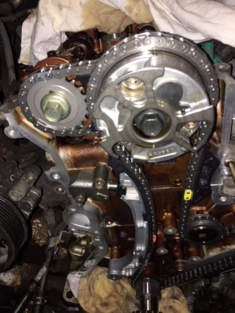

Here's a pic of mine during reassembly with new Toyota parts.
If you look at yours, the section with the uniformly colored sludge nearest the guiderail was the factory extended length. It accumulated sludge across the surface at that extended length, until the chain began elongating.
That's about right. You can see the sludge and varnish variation across the tensioner piston's extended length, that tells the story of the chain's ongoing wear. The thickest and darkest sludge at the end was the portion exposed when the chain was in spec. As the chain wore and elongated, the piston extended one ratchet tooth at a time and exposed new shiny sections of the piston to sludge bath and started discoloring it. The process continued and repeated.
You can minimize further chain wear by using motor high in molybdenum disulfide additive (also known as moly, MoDTC, etc) and changing it more frequently, like 3000 miles. Pennzoil High Mileage, Valvoline Extended Protection both have high concentrations of moly additive.

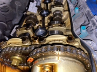

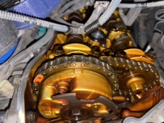

Hey guys sorry to revive a old thread again. I’m getting a p0016, p0335, p0340. I’ve been reading a lot on here and other forums trying to decide what to do. I pulled the inspection cover on the tensioner and it doesn’t seem to be extended as far as some of the ones I’ve seen on here. I went ahead and pulled the valve covers to check out the timing and it looks pretty damn close to me also. Let me know what you guys think. It would be much appreciated.
You've got something else wrong, based on the combination of DTCs and your tensioner piston extended length being normal. Timing mark alignment looks correct also.

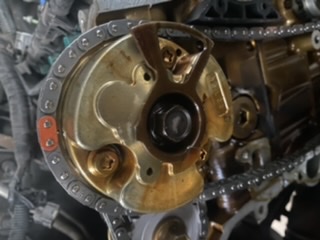

I think I found the problem. The part that the camshaft position censor reads is broke.
