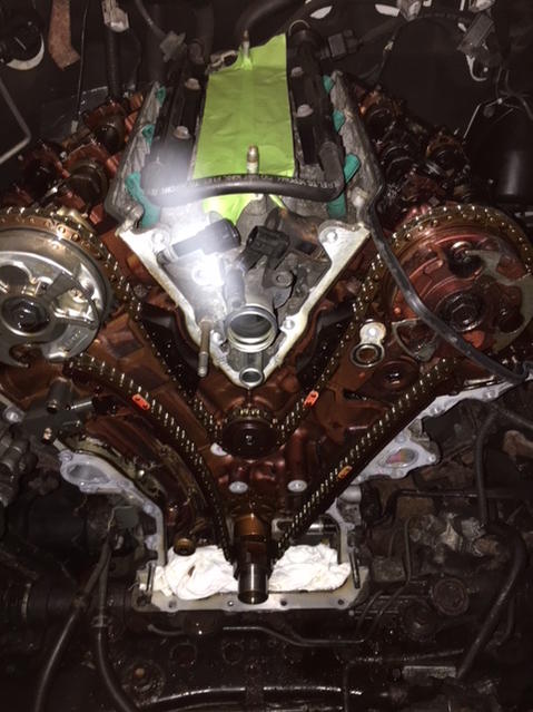

That's good info, thanks. I'm in the middle of a timing set replacement on my '07 4Runner due to chain stretch and chronic P0016, got new Toyota chains, sprockets, guides, and tensioners. Sprockets being replaced are the exhaust cam pieces, crank, and idler.

I had at first intermittent P0016 A bank correlation errors, then it was solidly on for about 20,000 miles.
Finally got up the courage to tackle the timing chain job. probably took 30 hours to do. (Around a week of evenings and a solid weekend). Things got allot faster as I accumulated more tools (different length extensions mostly!)
I have changed the oil, and brakes on vehicles, but that's about it. Its not very hard, but it was helpful to refer to the service manual.
You can do it, Just not if its your only means of transportation.
