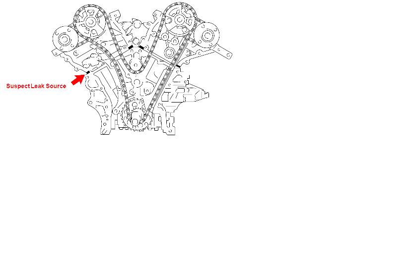

where the leak originated is where the cylinder head, block, and timing cover. meets. some people say lack of silicone. poor design. surfaces are slightly uneven for the cover to seal because the head is slight further back
here a pic, front cover has to seal to this

That looks about right, the only good thing is the fact that the dealer may be familiar with this problem.

best going under the vehicle and tilt your front shield down as if you are doing an oil change and look up by the power steering pump.
try and refer to the drawing witht he suspect leak sourse i posted early to get you an idea of wheres it at
