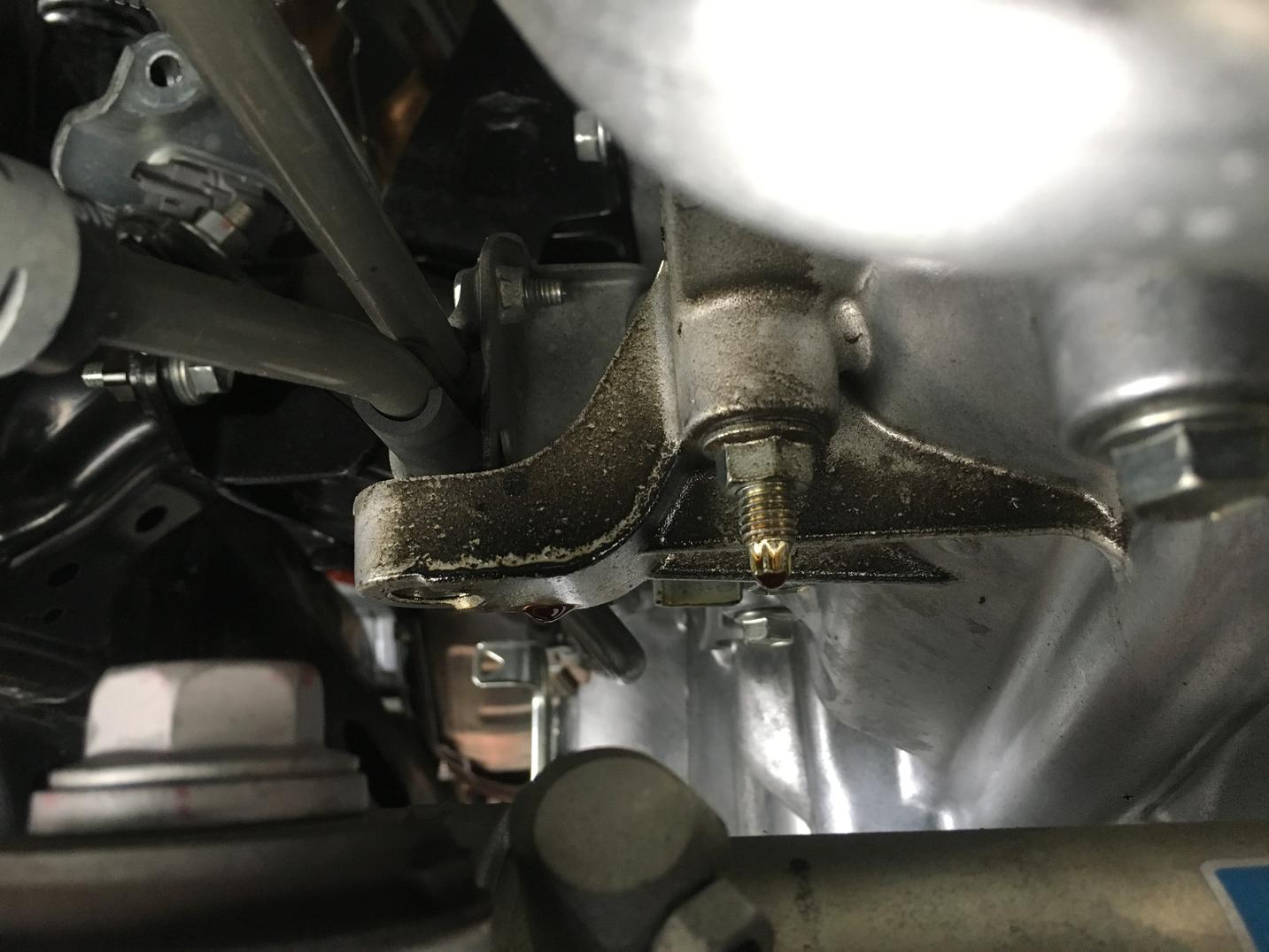

2016 4Runner , left side of engine with less than 1k miles. Several drips hanging, crossmembers are wet , oil cooler lines are wet.
This sucks, plain and simple. I hope they fix it right the first time. I think it would be prudent to ask the dealership/Toyota for some kind of an extended warranty on their dime.
