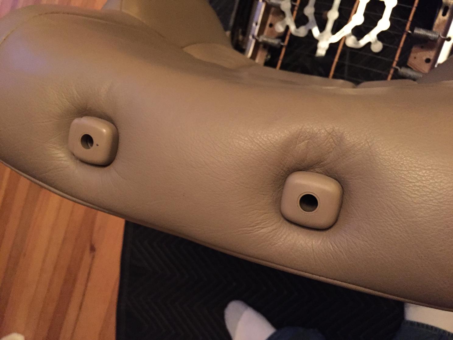

Anyone know how to get the headrest thing off of the seat back?
Slide the cover up like your going to take it off. The clips need to be squeezed together to be pulled out. When putting them back in make sure they are turned right to latch in the headrest. I got one of mine backwards and have yet to fix it. Also hog rings are easy to use.

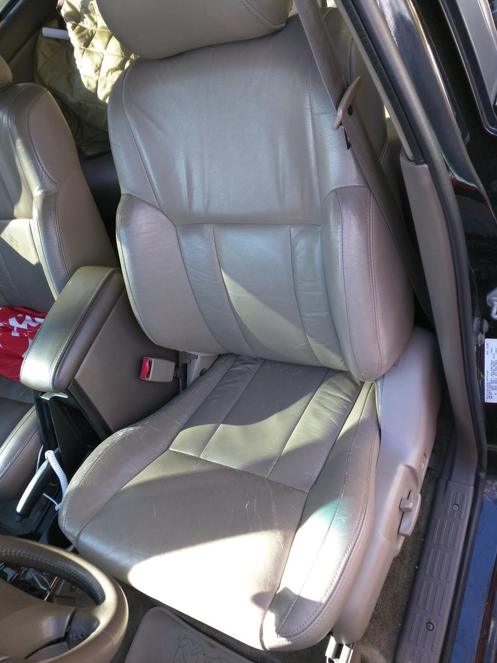

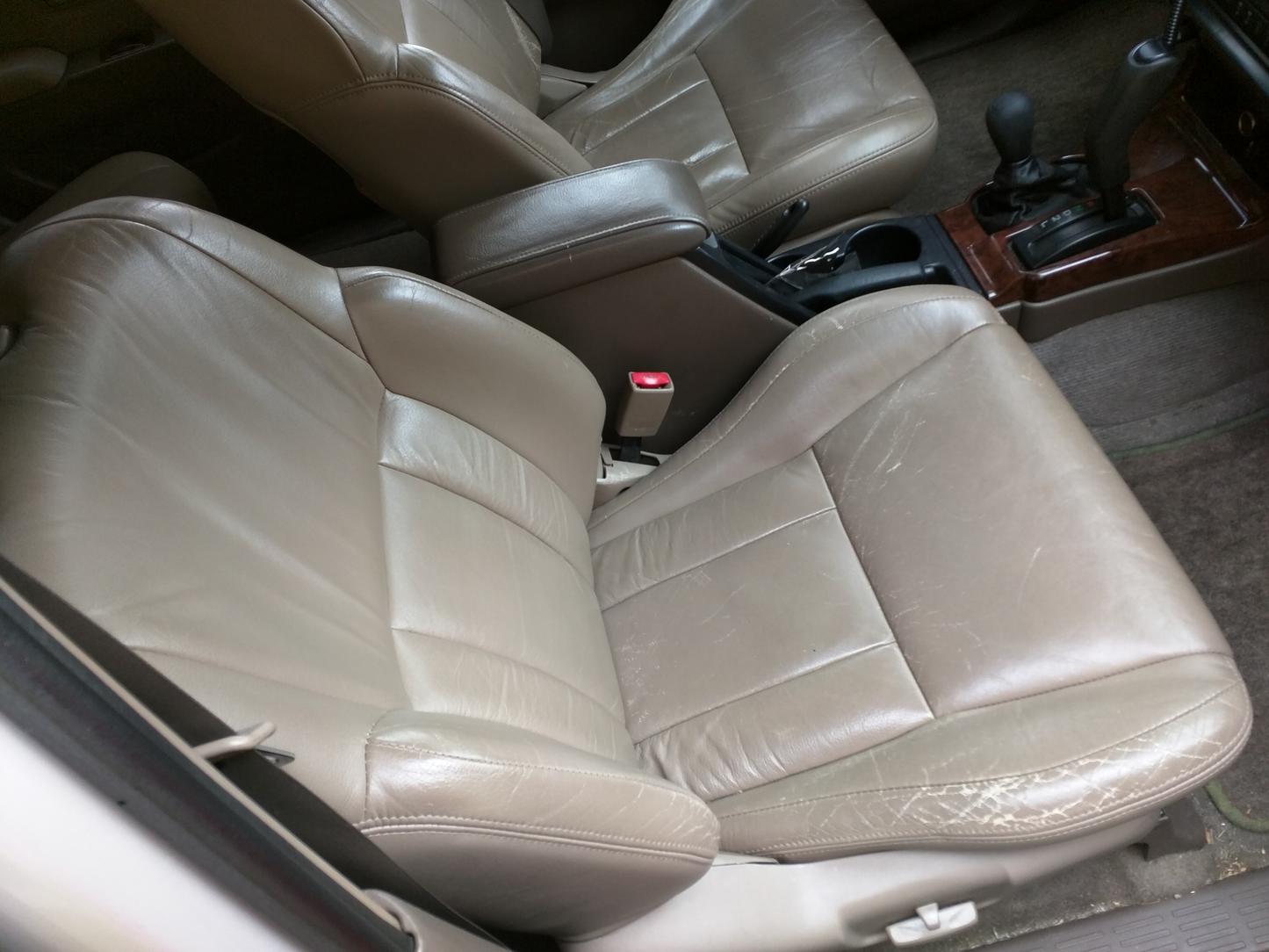

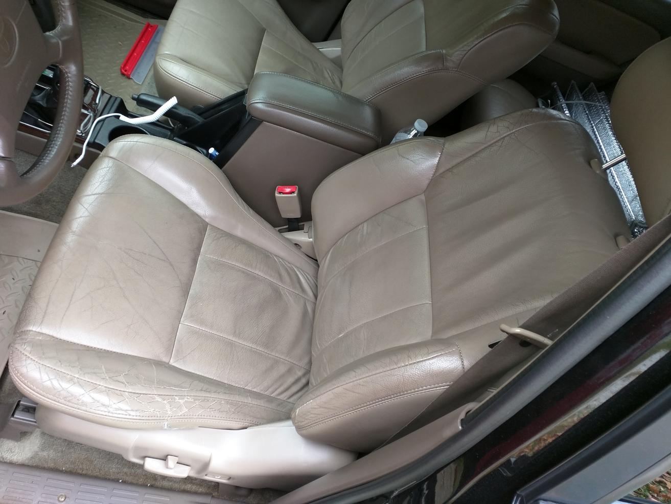

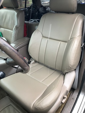

i took a few pictures:
-1- my drivers seat with a "Y" shaped rip on the side that i tried to glue back together (only lasted a few days) My driver seat leather was dirty and wouldn't come clean, not to mention all of the cracks that had formed.
-2- my friends passenger seat (to be swapped) has 100K less miles of wear
-3 & 4 - passenger seat leather and cushions installed on my driver seat frame.
I think it turned out ok - it got rid of the tear on the side. Hopefully now it will take years for a new tear to show up.

Did you figure out how to remove these? I want to remove my upper seat cushion and cover to replace the foam.
If you reach under the seat cover from the back side of the chair you will reach where those plug into. Feeling around, you will feel the front and back of the plug can be pressed, you will have to push those in and they can be popped out at that point.
thanks!
