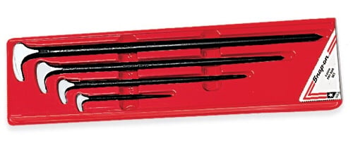

I wiggle it with channel locks while using light pressure under the bolt tab with a ladyfinger. (has worked for me 4 out of 4 times, your mileage may vary.)
What's a 'ladyfinger'? I did a Google image search and I got several hundred okra vegetables, a few hundred cookies, and two or three intimate vibrators. None of those seem up to the task.
Lol - also called lady's foot, apparently:
