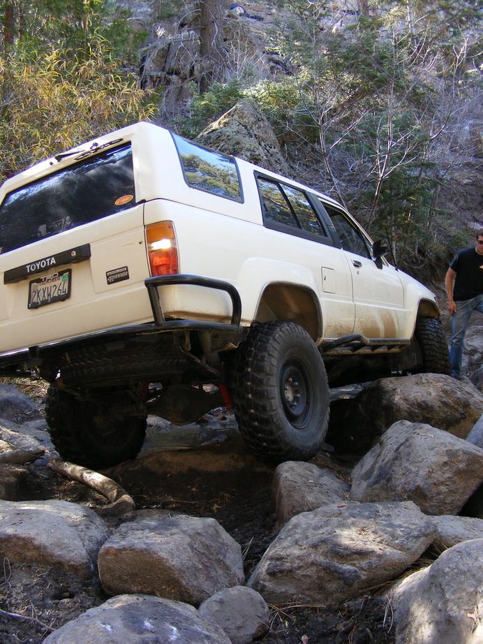

Hey Guys. So this is my 4runner. Its an 87 and my father bought it in 89. I learned to drive on this beast in 95. 2 years ago I put new springs in the rear (OME), bj spacers up front and new shocks all around. I found some cheap used 31x10.5 tires and put them on 15x8 steel wheels. It is time for real tires now. I am most likely doing the BFG AT in a 33. I have spent a lot of time researching the pros/cons of 10.5 vs 12.5 wide tires but I was hoping for an opinion from folks with the same truck. I read the wheel/lift thread on here and a bunch of stuff online (mostly jeep forums) and I think I have a pretty good grasp on the performance characteristics of each as well as the caveats of running a rim that is a bit narrow for a 12.5 tire. At this point, I'll admit it. It's about looks. I don't wheel much anymore. I'm concerned that the 10.5s will look stupid. I dont really like the "pizza cutter" effect but is it going to be really obvious on this rig? On my Tundra I went with a 295 over a true 35 due to width and rubbing issues and its not that bad looking. I'd love to hear the opinions of some folks that share my love for these old rigs.

[MENTION=84642]Quatre Coureur[/MENTION] and [MENTION=49649]KidVermicious[/MENTION] have 33x10.50s if I'm not mistaken.
I really like the look of them. They're one of my favorite tire sizes.
Check the first page of my build thread for lots of pics of 255/85r16 on my '85. Looks are a distant second place to function for me, but I have to admit I like 'em better than the fatties you see the Jeep and pickup crowd running.
I've been running 33/10.5s for quite awhile now. For rockcrawling, u want a narrower tire for increased contact pressure. For sand, you'd want the wider 12.5, but that's not really a concern so... 10.5s weigh less, cost less, and will definitely fit better.

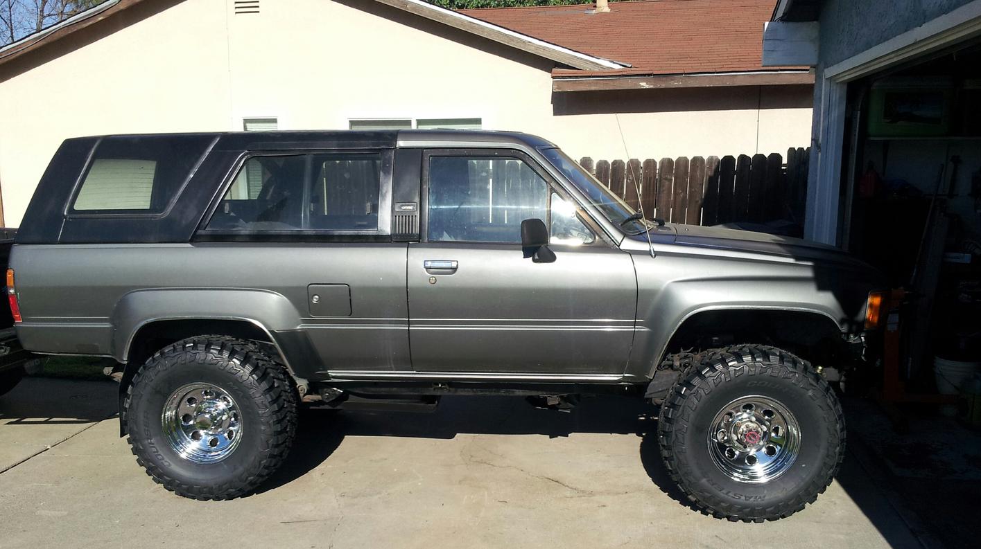

I run Master craft 33 12.50 on my 88 without bj spacers. Only a 2" bl for my 3.4. No rubbing and look great. Wheel is 15x8 with 3.75 back space. Look and drive great on the street. Was so impressed with the tire I bought the 32 11. 50 for my Tacoma. I vote for 12.5 but have seen the Cooper discovers in 33 10.50 on my brothers truck and look pretty good. Not pizza cutterish.

i run 34x9.5x15s on my cj...... quite narrow. wheels are narrow, too.
