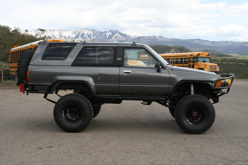

I like this pic a lot, 85 with 7 inch lift and 35's... no idea who's rig it is but it looks awesome!

With that much lift you could probably clear 37s. I agree about the gears though. I ran 35s with stock gears for a little while. It sucks something fierce. Kills your clutch trying to take off. :wacko: I currently run 35s with ~7" of lift and I think they look small.

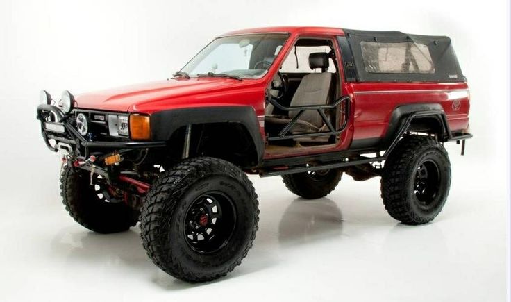

I'm a little bias because my truck is red... but i think a red runner and black wheels look the best! Look below... This is what your rig can look like!
