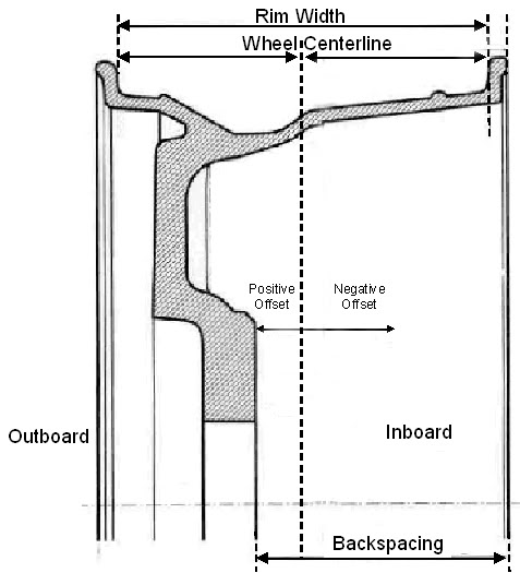

Hate to sound like a idiot, but when you say back spacing what are you referring to?
distance between the mounting surface of the wheel and the inner edge of the rim.
