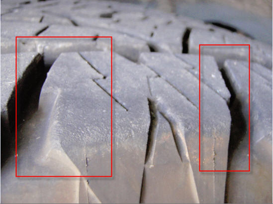

I just had my tires rotated after about 15k miles. (New tires...first rotation) and the guy in the garage told me my front tires were "chopped", slightly. I went out to look and he showed me what he was talking about. Now this is hard to describe without a picture, but I will try.
Looking at the top of the tires, from the side of the vehicle, it looks like the trailing edge of each tread is slight rounded, and the leading eadge is still square.
Like this:
Screenshot from Lightshot
It does not look like feathering or uneven wear. It doesn NOT look like this:
This wear is only visable on the front tires, and the "chop" is pretty symetrical...that is, it's not any worse on the right or left side of the tire...

I took a picture of the tread wear. Again, it's the same on both the inside and outside treads and on every tread around the entire tire.
