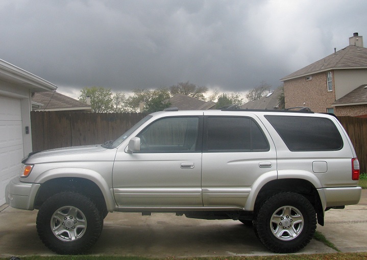

I did the chalk test and stuck with 45 psi all around. In all honesty I think that's the single largest contributor to my issues. That being said, thanks to all who suggested it might be my suspension. I did in fact use that rationalization to pull the trigger on my latest purchase. I'm the proud new owner of a complete OME suspension kit.
Front: 881 with 90004 Rear: 906 with 60028
Mounted 'em up yesterday. Still sore today. I'm too old to be crawling under my truck all afternoon. Love the outcome, though. It's a rough ride with the combination of OME and e-rated tires, but I like it that way! :thumb3: We'll see how my tires wear from here.
On a side note, I used a trim packer on both sides of the rear hoping it would give me the slightest bit of rake. It didn't. I'm at 37 1/2" on all four corners. I'll see how it settles but may be adding more trim packers later. Anyone have negative rake with my combination?
