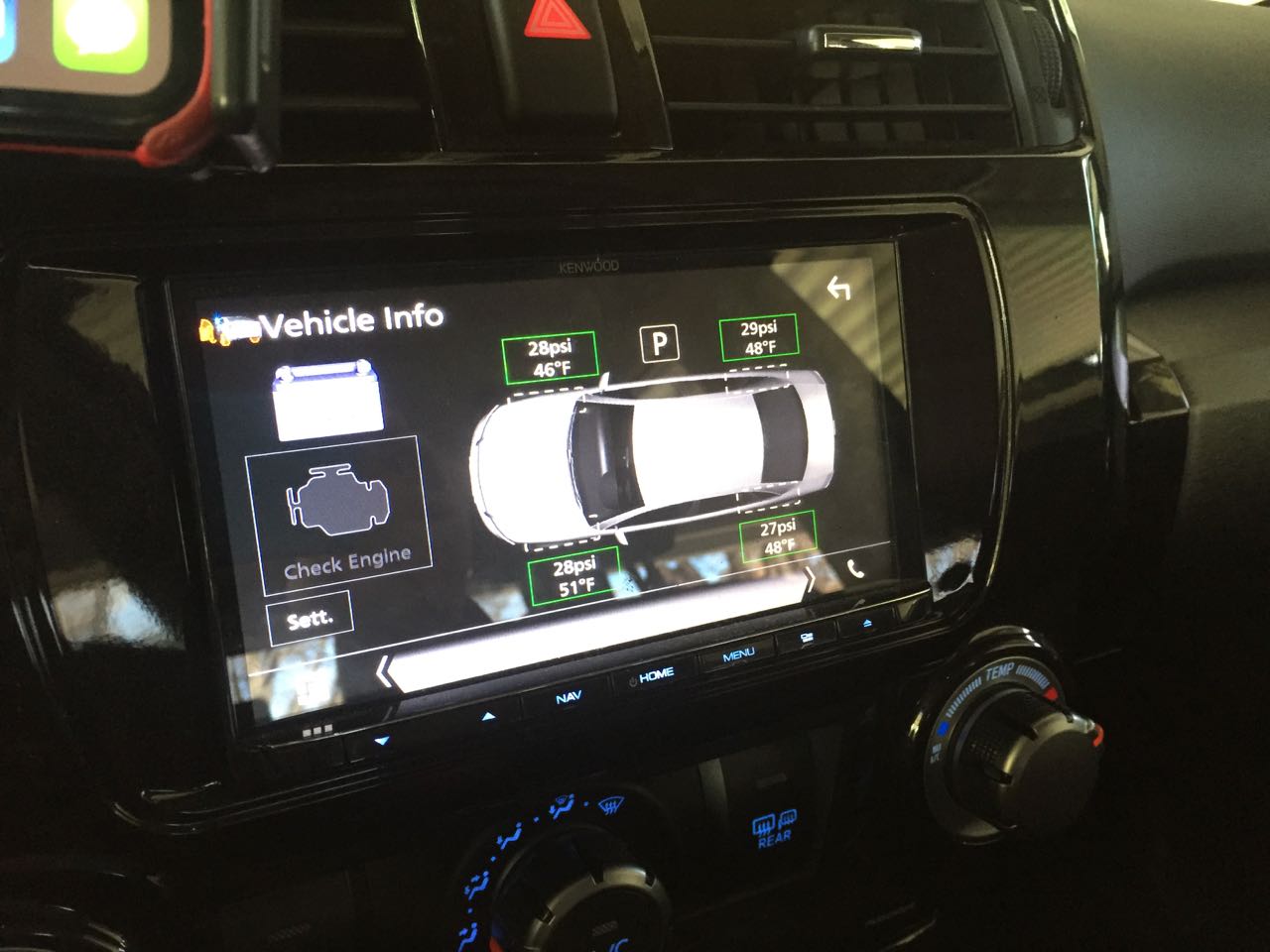

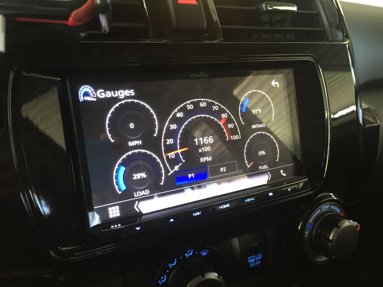

Sure, lots of us use aftermarket radios headunits to get tons of additional information via the iDatalink Maestro setup offered by several companies. Definitely not cheaper but highly integrated and useful.
New Maestro Radio Solution
Thanks, not sure I’m willing to look at aftermarket radio just to get this. How does the radio integrate with iPhone. Does it crash every time you make a phone call like the stock one?
For sure. It's not cheap but fixed so many of the things I didn't like about the 4runner, for me at least. No crashing! Ha!

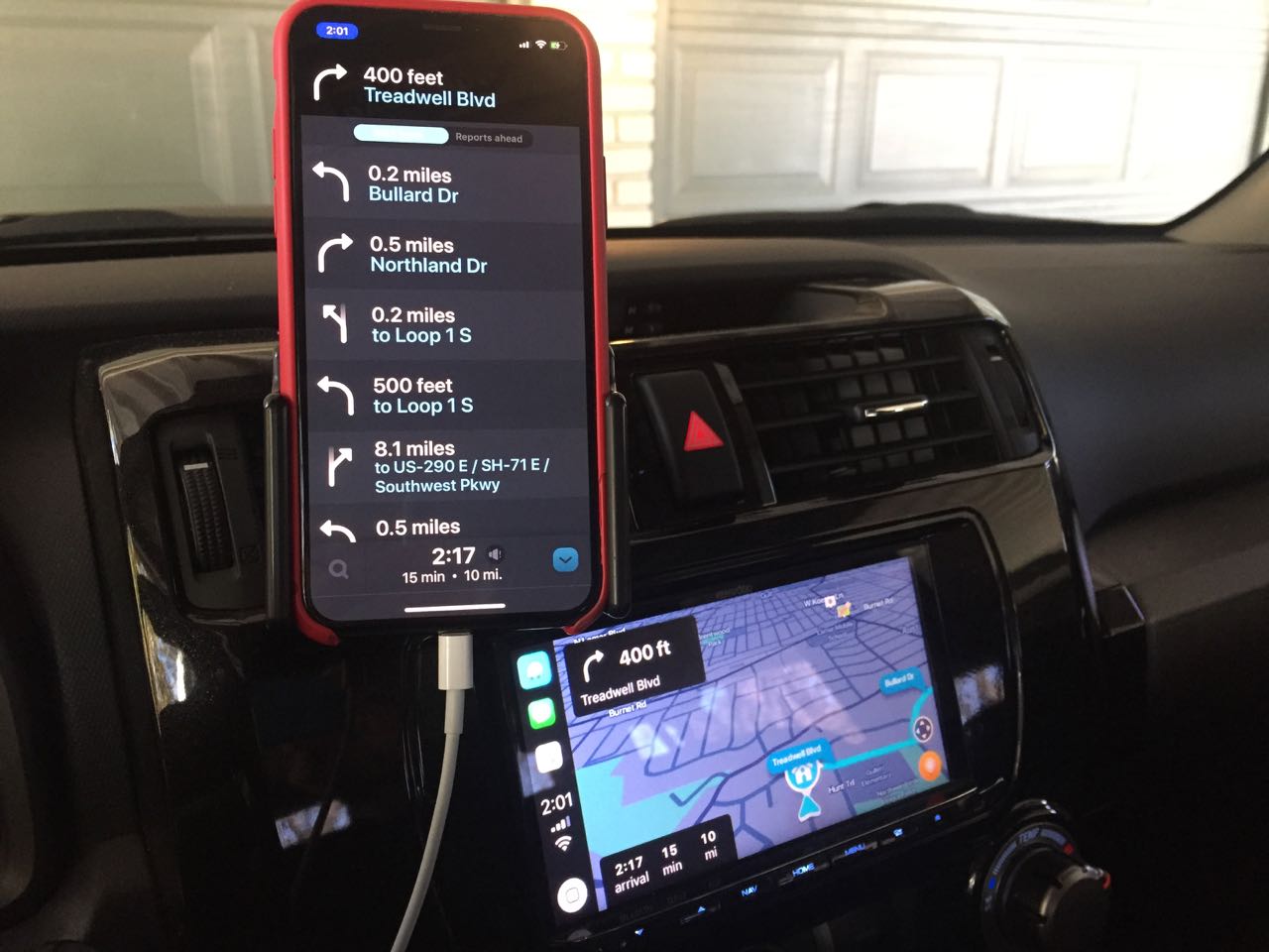

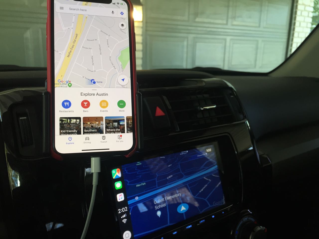

Cool, I like that you have CarPlay and all the vehicle info. Not crazy about the aftermarket dash trim and the loss of physical buttons. Is that a scosche that you painted?
I’m surprised that there are not more companies making direct replacement options that integrate better into what’s already there. I guess it’s just not enough cost benefit. But it would sell like crazy with how poorly entune and iOS work together.
Yeah, it's the Scosche. Had a body shop match it. I honestly don't even think about it anymore. Love it. I think so much of the interior is so oddly designed that it just blends in to the design chaos. I thought for a minute that the Entune would be enough but that ended pretty quickly. I love using the Garmin, Google, and Waze mapping as-needed and that OEM GPS was ROOOOOUGH.
But back to the original subject, the TPMS readout is a life-saver.
